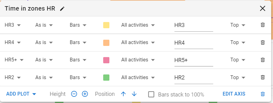

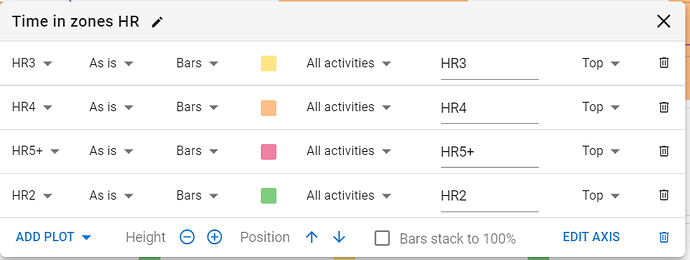

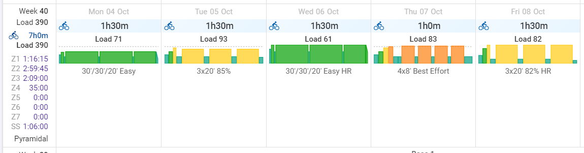

Another example to try and debug this problem would be week 40 on my calendar:
For a graph setup like this:

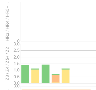

The resulting graph can be seen at the top and the equivalent setup with power zones can be seen at the bottom graph:
There should be time in zone information for the heart rate workouts (in the first graph) and I think this should also be extended to display time in zones for all workouts as this would line up with the functionality of the power equivalent time in zones. This would allow future workouts to be planned based on power or heart rate and past workouts to be viewed in heart rate zones.
