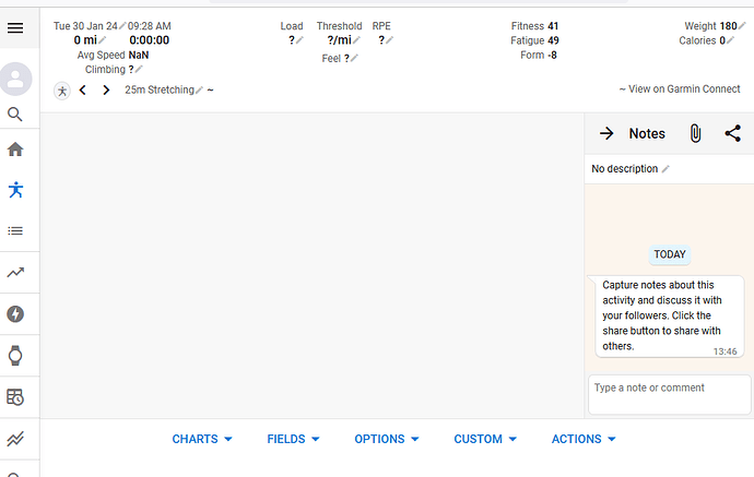

Time for stretching has come in as 0:00:0 minutes: Cannot correct - please help. It is correct it Garmin connect
Hi, on 30th June I have 25mins of stretching that is uploaded from Garmin Connect. I put the stretching in GC as “Yoga”. In GC It is showing as 25mins. However, unlike the other 25mins stretching that week, the time is showing as 0 minutes. I have tried editing the time, but I can’t find a way to do that.

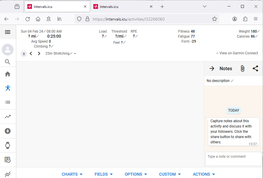

I am not seeing anything that has a “Ignore speed distance”, probably because I am not adding this data directly to Intervals. See screenshots. In Garmin Connect they are going in as Yoga,
However, I now see what you mean now. When I look at the ones that work there is a zero in the mileage. For this one there is a ?.
So If i change the ‘?’ to ‘0’ it should be corrected.

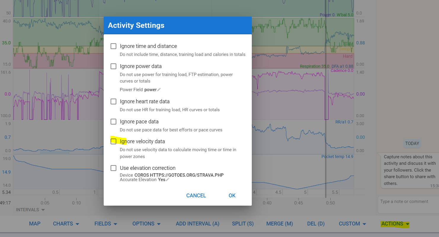

Actions - Settings - Ignore velocity

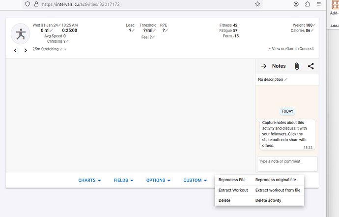

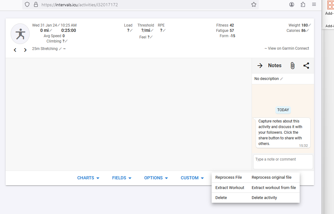

Two things:

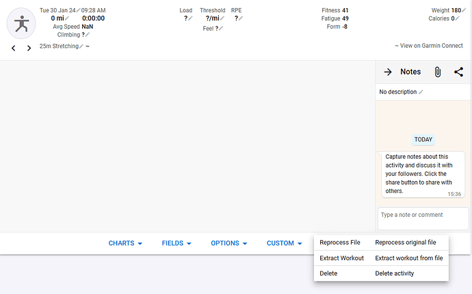

  1. You are showing me a typical cycling activity. I can see that option in my settings for such activities. That is NOT what I see when the activity is Yoga, This is what I see in Yoga. There are only three options: see below (and I have tried reprocessing the file.)

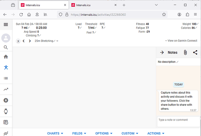

  2. I have a single entry/activity that is giving me trouble. The others all from the same source, using similar data, are fine. Hence wanting to alter the time for this one.
This entry is fine…

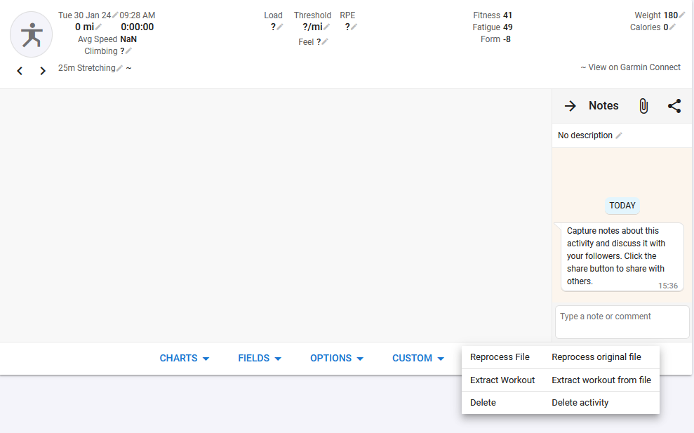

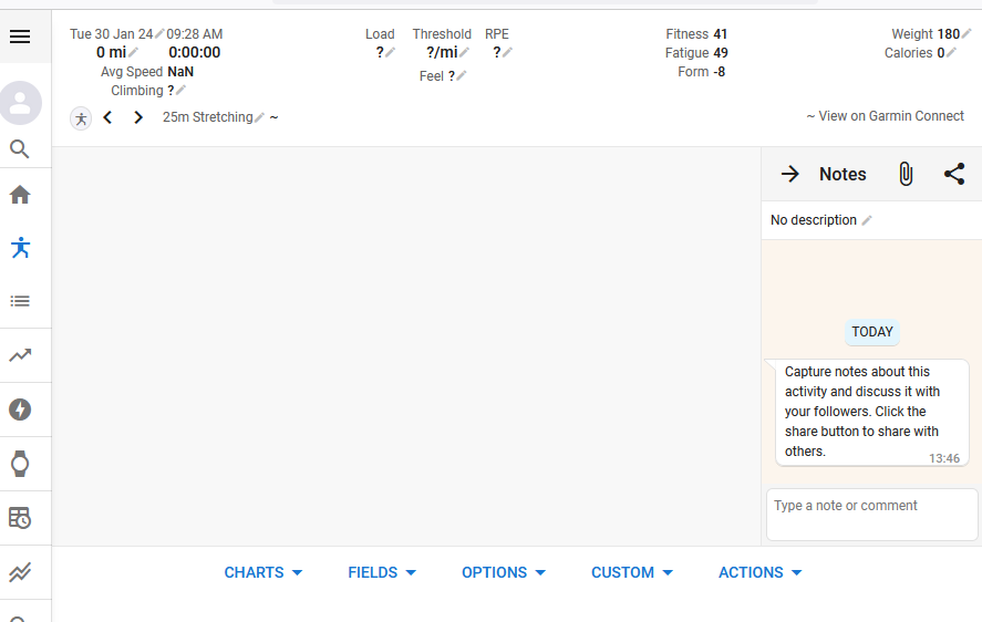

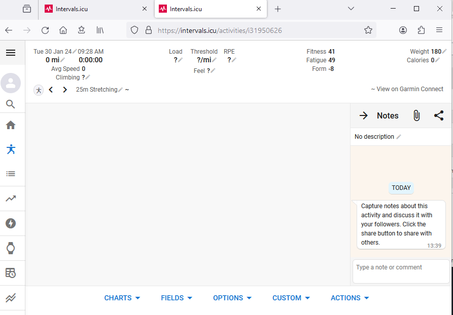

This entry has time=0:0:0 and as you can see under actions has no options for ignoring the speed or mileage.

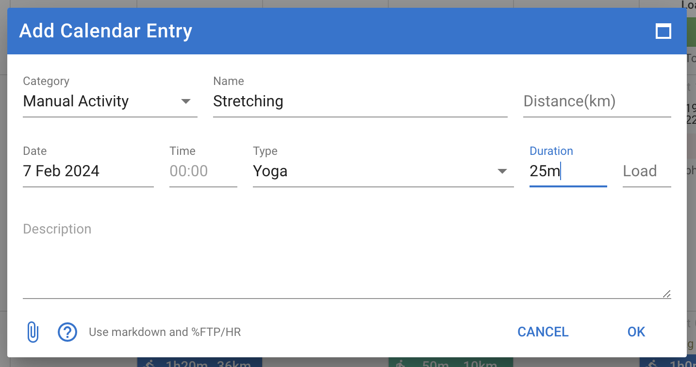

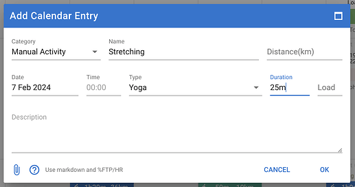

There´s no data in the file, you could add a manual activity.
Click on the date and add a manual activity with name and duration.

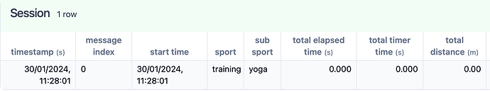

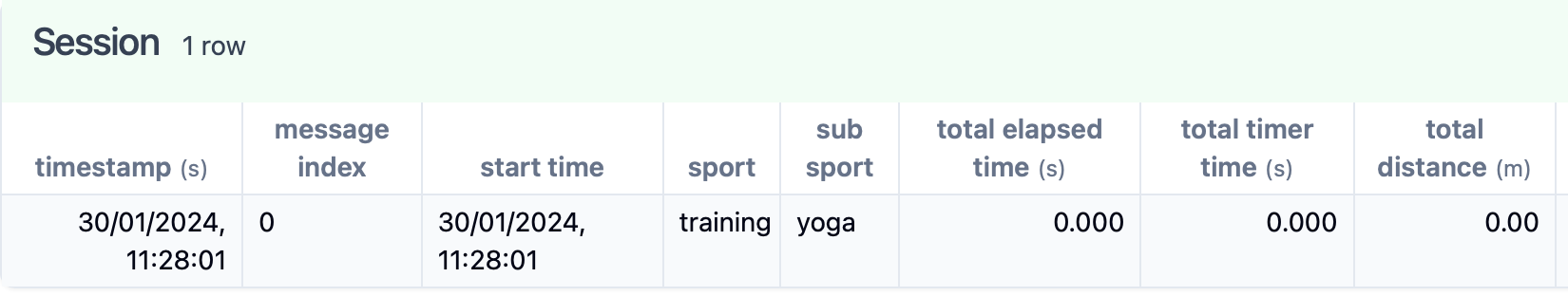

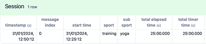

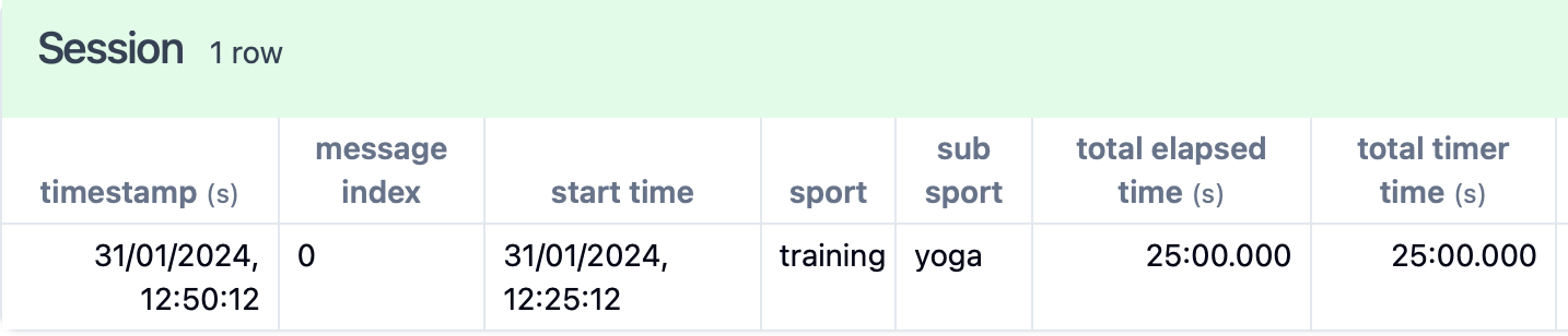

I had a look at the files from the 30th (no time) and 31st of Jan on fitfileviewer.com.
30th: No time information:
31st: Has time information:
There are no records so Intervals.icu is using these values.
I don’t know why one file is good and the other bad. Easiest fix is to delete the bad activity and add a manual activity instead.
Thanks David, that was the conclusion I was coming to. I’ll do that in the morning.

Your situation looked very similar to previous reported problems where the cause was that someone unintentionally had GPS on for indoor activities. This completely throws off Intervals because there is a speed/distance stream in the fit-file but it is bogus, resulting in incorrect moving time. For those situations, the Actions - Settings ‘Ignore velocity’ option is an immediate solution, instructing Intervals to disregard the speed/distance stream and simply use the total time as moving time.
You can even ignore parts of the activity speed/distance track, if for example your GPS goes crazy in a tunnel or in a city center with high buildings disturbing GPS reception.
