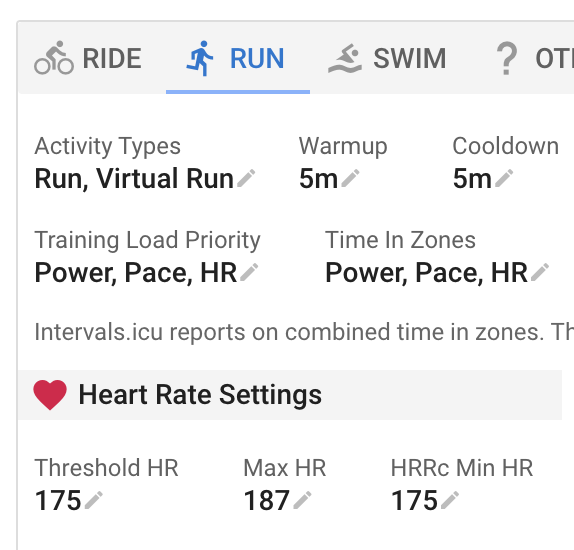

I have the following settings
But when I am creating a workout using workout intervals text I it seems to be using a different threshold
Hi @Rohan_EnduroCo
When using 80-84% HR, it calculates the range using your max heart rate. The percentages shown in the settings however, are based on the threshold HR.

Hi @david ,
Please have a look at this. Activity link
Athlete has LTHR as 167. when feeding
- 100m:00s 85-90% LTHR
it is actually taking 90%-95% i.e. 149-158 bpm.
Thanks,
Rohan
Enduroco.in
That athlete’s LTHR for running is 175 … the cycling one is 167:
