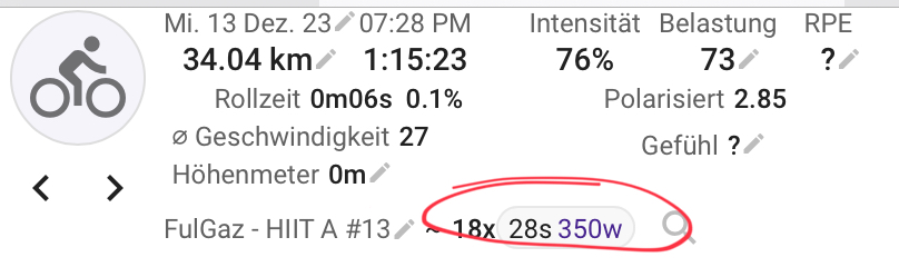

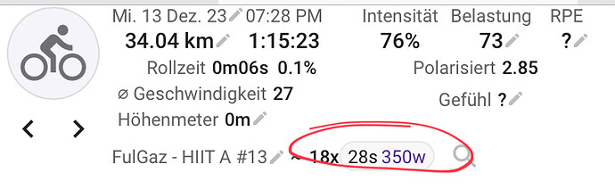

You see the intervals in the graph and at the top right beside the name of the activity. I would not know where else to put it in activity?
The place of the intervalls in the acitivity is completly ok!
But the intervalls are not automatically recogniced, they are “missing”.

Looks like you are using rounds as intervals.
Go to settings > in the box power settings > deactivate „use rounds as intervals“
Go to activity again and analyse the activity again (action > analyse). It should auto detect your intervals correctly.

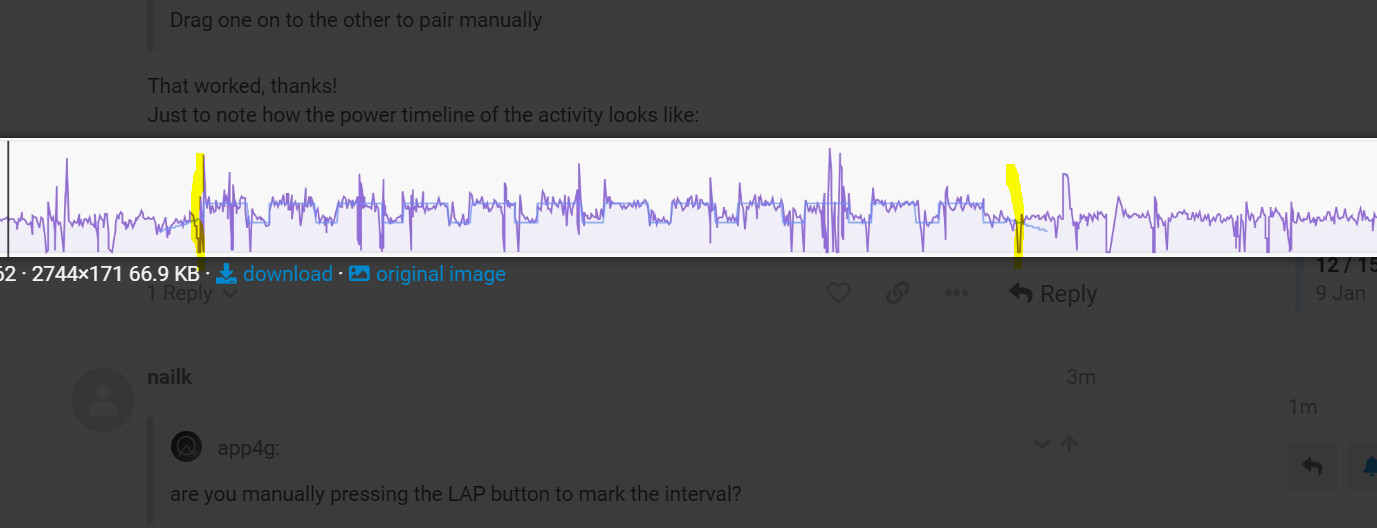

I deleted all auto-created intervals and tried to add them manually according the planned activity, it takes too much time (12x HITs). Whenever I click on the canvas, I risk to mess it up - a previous interval got deleted, when I tried to re-add it, most of the intervals got deleted somehow.

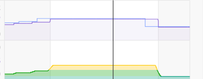

I don’t know what you are asking for. You see the planned workout power (light blue) and the power done (violet). You see the timing difference, e.g. when you start interval some time later. Intervals recognise the interval automatically correct.

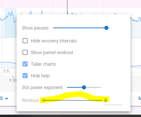

If your workout and activity have an overall shift in time that is more or less constant, use the slider at the bottom of the Options dialog to sync them best as possible.

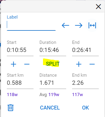

For recurring intervals that are not correct, first create one interval that is the full length of all the intervals and use the Split function to cut in equal pieces.

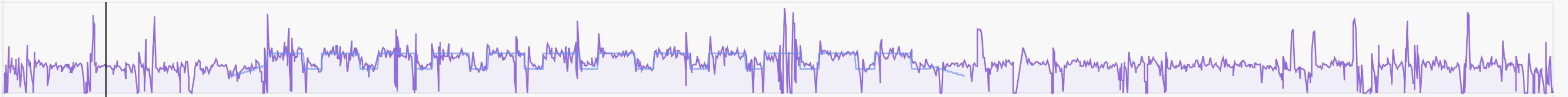

Just to note how the power timeline of the activity looks like:
will try to use it next time, thanks for the tip
Once it’s paired, you can show the paired workout structure. See same dialog in the first screenshot: ‘Show paired workout’
What I would do with the above is add an interval that stretches the whole part in between the highlights, and then split that in 12 equal parts. Then you can split each of those in the work and rest part.

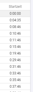

Theses data should be simple the same as in the workout defined:

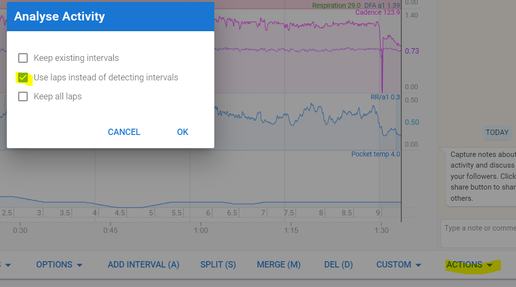

If you execute the workout during your activity, your device should automatically log the ‘laps’ from the workout.
On the Intervals settings page, check the Use Laps checkbox, and the activity will have the exact same intervals. When you use this outdoors, it is important to disable all Auto-pause, Auto-lap functions because that will mess it up.
Basically the checkbox disables automatic interval detection in Intervals and simply uses the laps created by the workout.
I guess that s want you want?
You can test it on a former activity by using Re-analyse from the Actions menu (bottom of the activity page).
