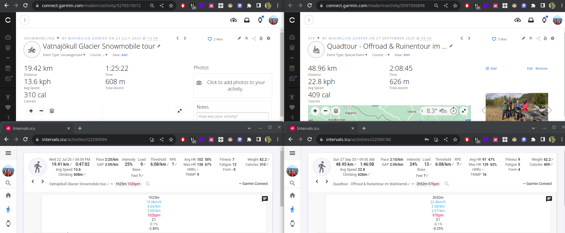

I have several motorized activities on Garmin.
For example, ATV and Snowmobiling.
These activities get tagged as Walk in intervals.icu
Activities tagged as Hunting/Fishing in GC get imported as Walk.
Maybe most importantly, Activities tagged as Other in GC get imported as Walk.

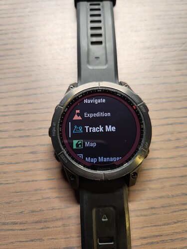

I had a look at your ATV file and the sub type is TRACK_ME. Anyone know what that is?
Track Me is a generic activity type on Garmin Watches. I guess for using in a car, bus, airplane, atv,…
It probably does not interfere with other fitness metrics (Garmin Forum).
I think, at the time I recorded the activity, my watch back then did not have a built-in ATV activity, so I used Track Me and then changed the activity type later in Garmin Connect.
I just recorded a real ATV and Snowmobile activity with my watch.
Only the Snowmobile activity made it to intervals.icu. Also Strava did not accept the ATV activity and classified the Snowmobile activity as Workout
