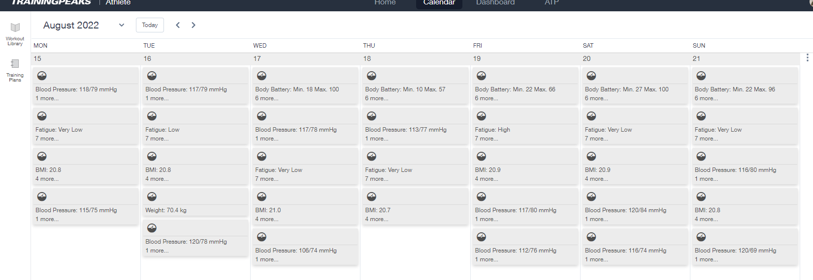

Systolic VS Diastolic Blood Pressure View on calendar sometimes wrong

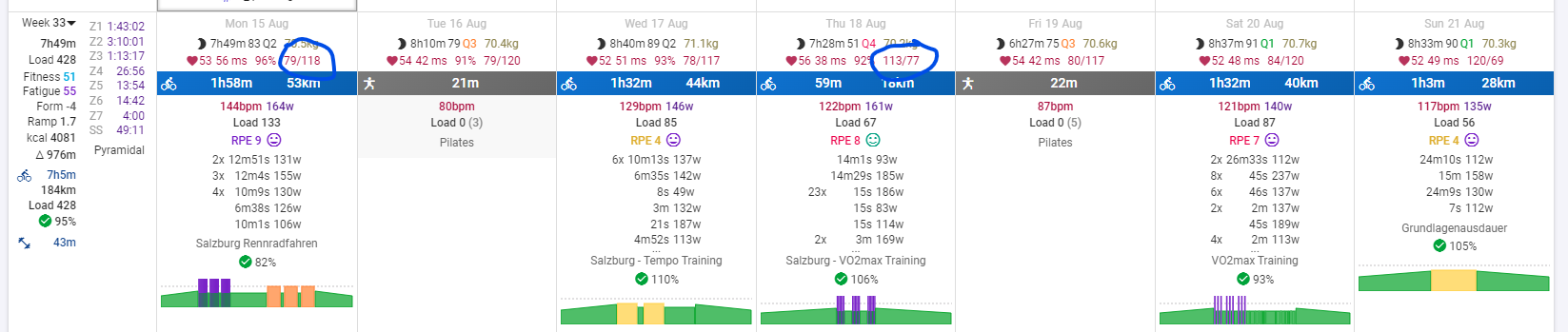

it looks like that Systolic VS Diastolic Blood Pressure View on calendar is on some days correct and on others not, sometimes the systtolic on the left side and then on the right side.
i import my Blood Pressure via fitnesssyncer from withings.
Blood Pressure sent from fitnesssyncer to Training Peaks don’t change both fields

It looks like it have something todo when i measure my blodd pressure 2 times a day, so thursday i only have 1 measurement and on all the other days 2:
so intervals.icu calculated a avg of 2 measurements of a day?
