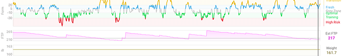

Thanks… I do have that set, and have just noticed that it does seem to update my weight on the ‘Settings’ page to be in sync with that from Strava (and therefore my Withing Scales), so the data is getting through the Intervals.icu, but the value and therefore plot on the ‘Fitness’ page (which is where I was looking before) hasn’t updated and still only shows the original weight values and a straight line.
See straight line for weight in screenshot attached.
Weight on settings page shows 160.9lbs from Strava, weight on the chart above is stuck on 161.7lbs

It will only “record” a new weight for the fitness chart when your next activity syncs. Thats probably the issue.

It seems to be working now. I think you were correct (surprise surprise!) although it hadn’t updated after syncing yesterday’s (windsurfing) activity but once a cycling activity synched today the weight in the fitness chart updated as well.

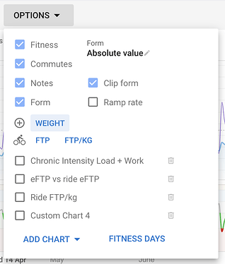

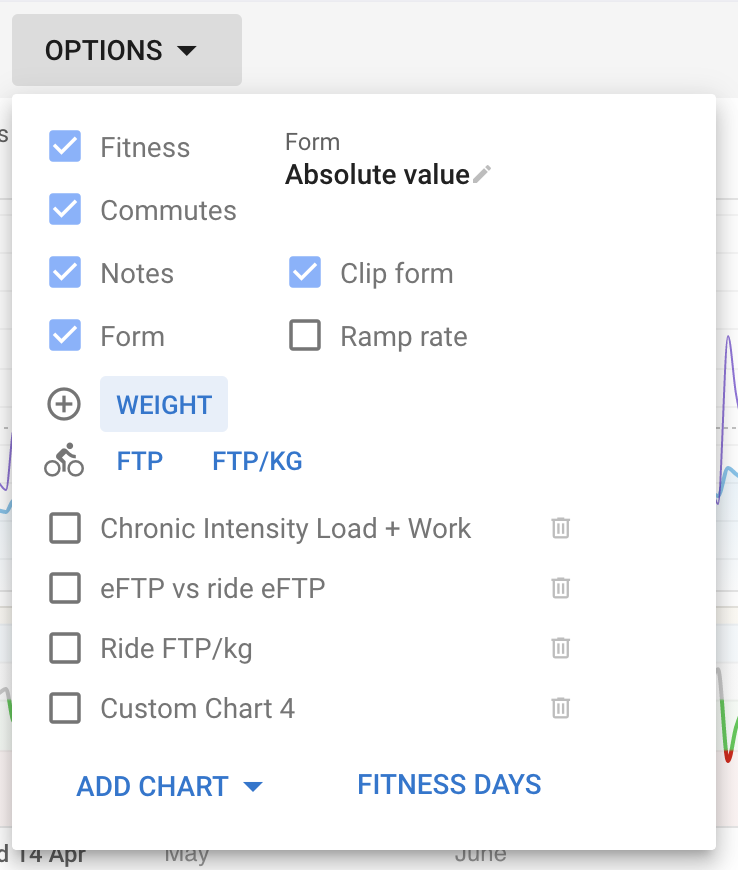

I have fixed this. The old weight chart was using different data to the weight plot on the custom charts. I have replaced it with a “custom chart” like the FTP and FTP/kg ones:
Sorry,
I can’t find this item in the settings. :upside_down_face:
can you help me please?

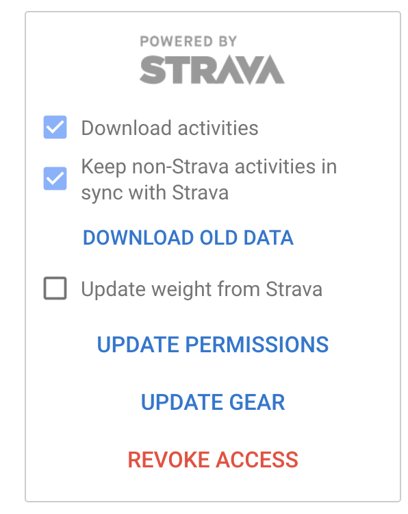

is this what you’re loking for? “Update weight from strava”

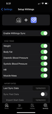

BreakAway also supports updating weight from Withings to interval.icu & Garmin Connect
thank you very much, the option has already been set for some time, but the weights are not updated.
