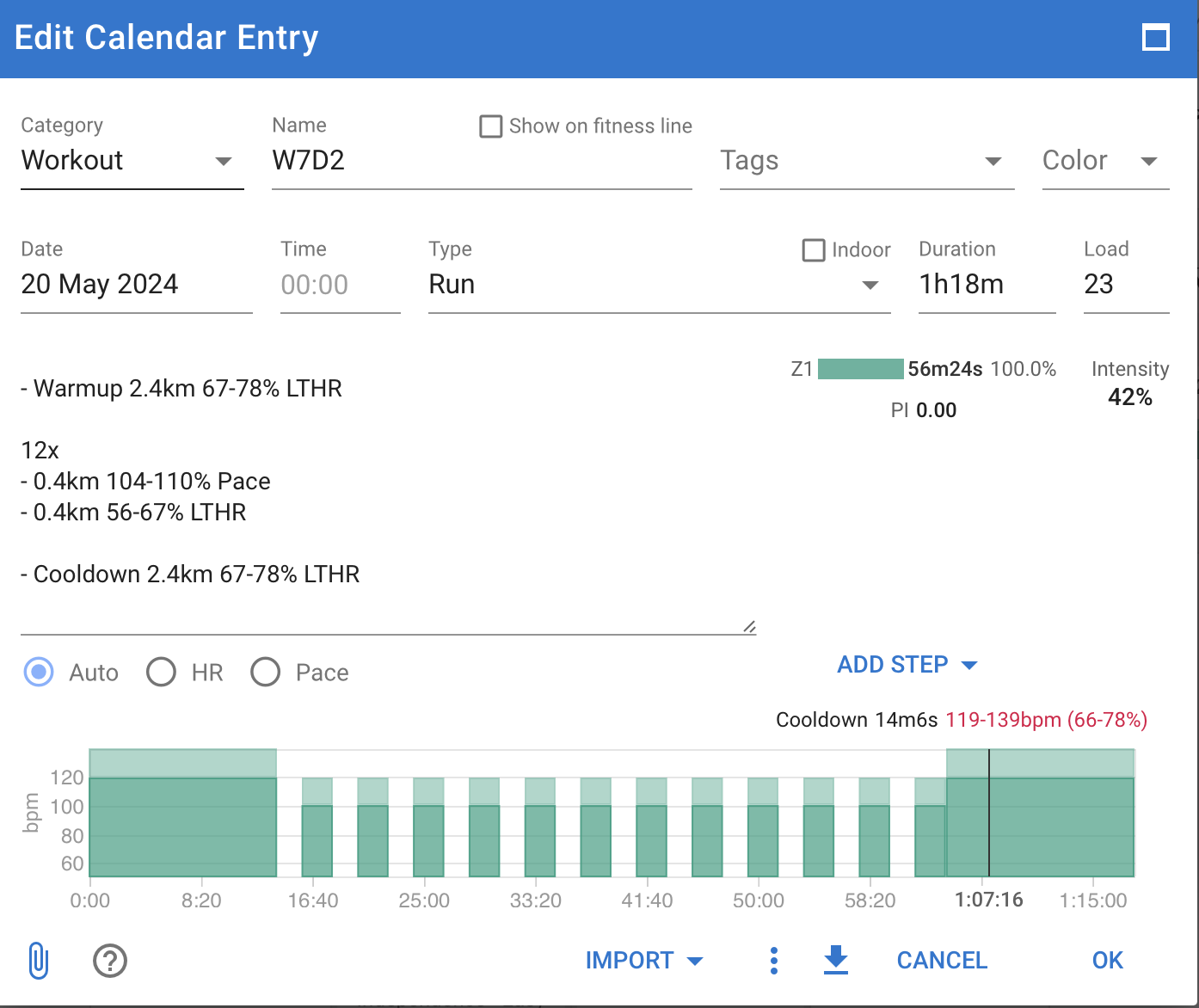

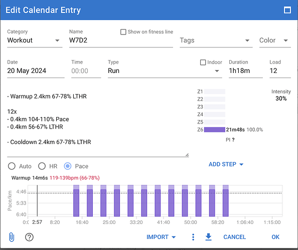

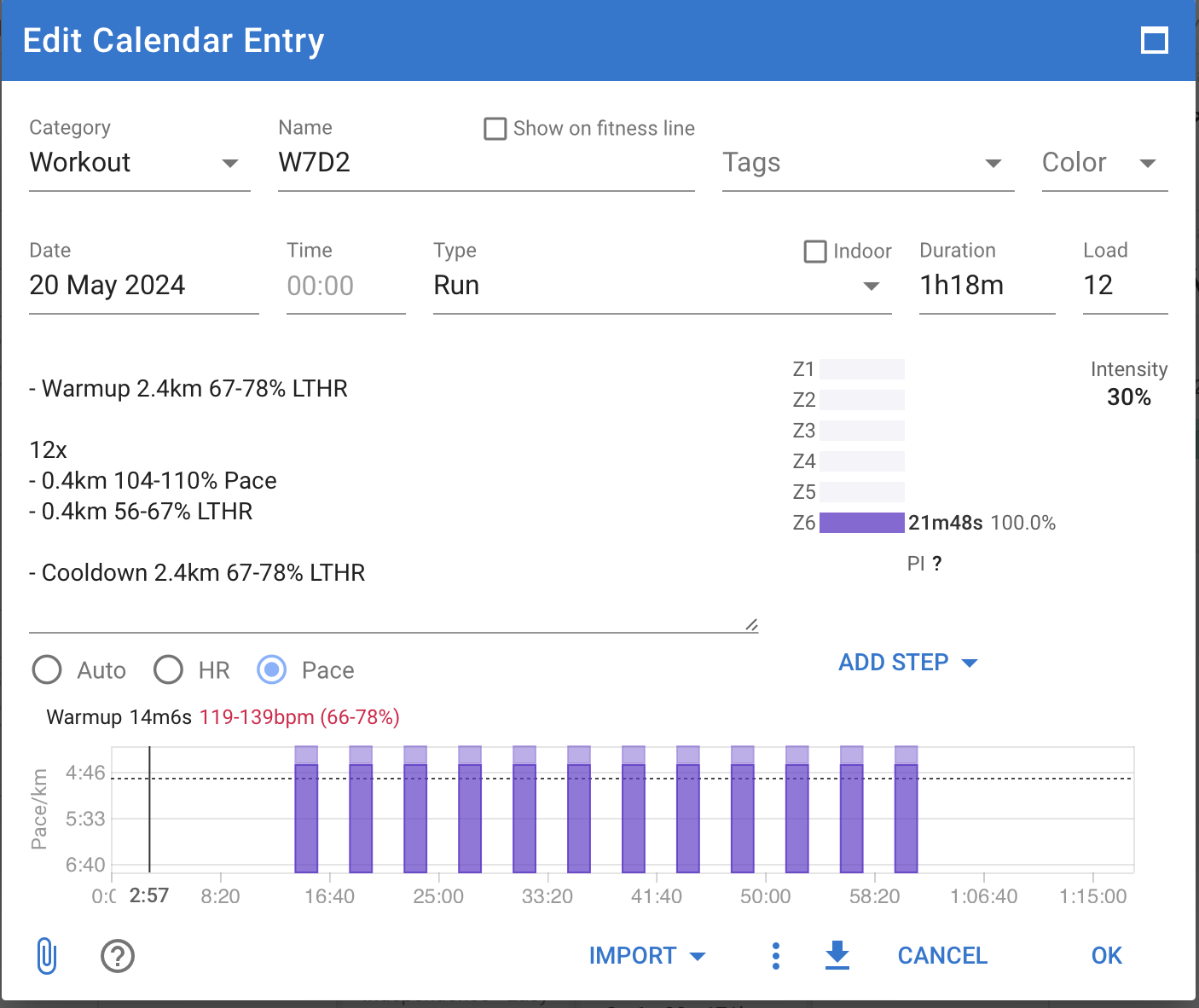

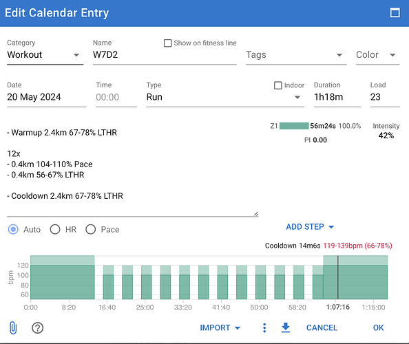

My apologies if the answer to this question is obvious, but is it possible to sync both pace and heart rate from an Intervals workout to Garmin?
When I import a planned workout from my custom .fit file (which I generate through Garmin’s SDK), Intervals seems to populate the data correctly, but it will not sync both the heart rate and pace data to Garmin. That is, after syncing the workout to Garmin Connect and subsequently my Forerunner 945, when I view the workout on my watch I can see either the heart rate and no pace data or, if I change the data to pace in Intervals, I see only pace but no heart rate data. Is it possible to have both kinds of data in one workout?
I’ve attached some screenshots of how Intervals is importing the data.
Thank you for your help!
Just to be clear, if I choose “HR” when importing the .fit workout in Intervals, my Garmin watch will not display the correct pace for my 400 meter intervals. It just says, “400m” for the run portion instead of 400m: 4:25 min/km - 4:40 min/km.
However, if I directly add the .fit file to my Garmin watch (by connecting it via USB to my computer), I do have both pace and HR data for each workout step, so I think the .fit file is correctly formatted.
