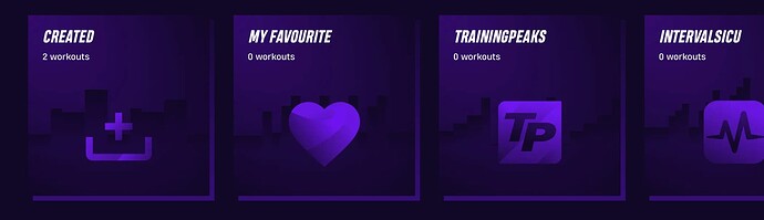

I connected rouvy and intervals.icu, added workouts to library and activities calendar for today but they workouts are not synching? I would expect to see the workouts in the intervals.icu workouts block inside rouvy?
I hope I am missing something.

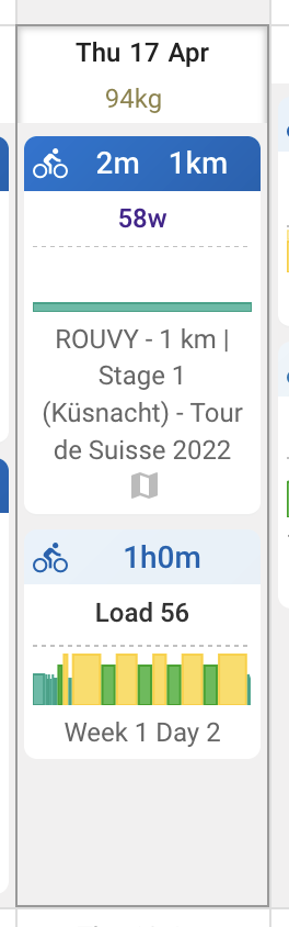

Only todays workout(s) are synced. So you have to put them on your calendar for today.
I am aware of that, but it doesn’t work. the 2 workouts are manually created

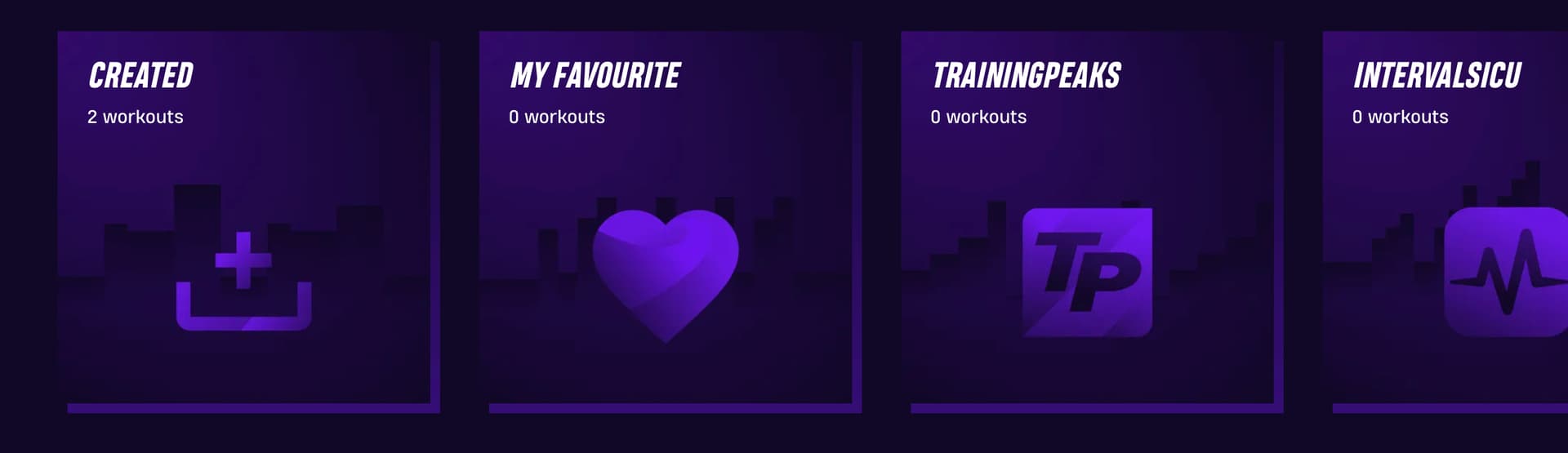

Rouvy isn‘t doing a great job at this. I have 6 old workouts there, and they won‘t be deleted. For today, only the outdoor workout is synced.
So check, if you have unticked the indoor checkbox. You can move the workout to another day and back, sometimes this works too.

Setting Ride - indoor and moving the workouts around a few times worked though! Those that were set as a virtual ride are not synched. thank you!

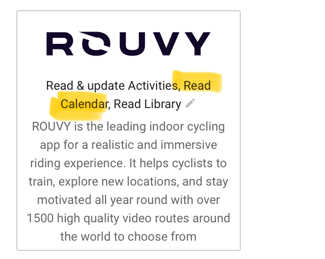

From my perspective it must be on rouvys side.
They are reading the calendar / workouts:

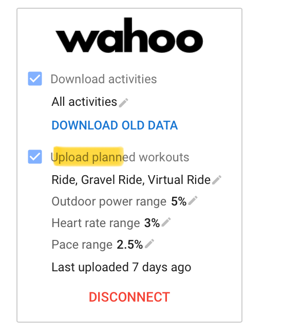

While for Garmin or Wahoo, intervals is uploading it to their ecosystem. That’s not the case for rouvy
