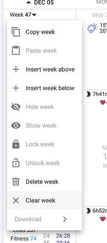

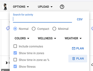

You can use the “Clear week” option to delete a week at a time:
Or delete all future planned workouts at once:

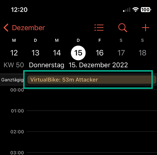

Hey, is it possible to set a default time for the workout to be added?

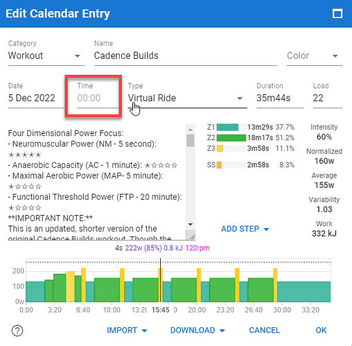

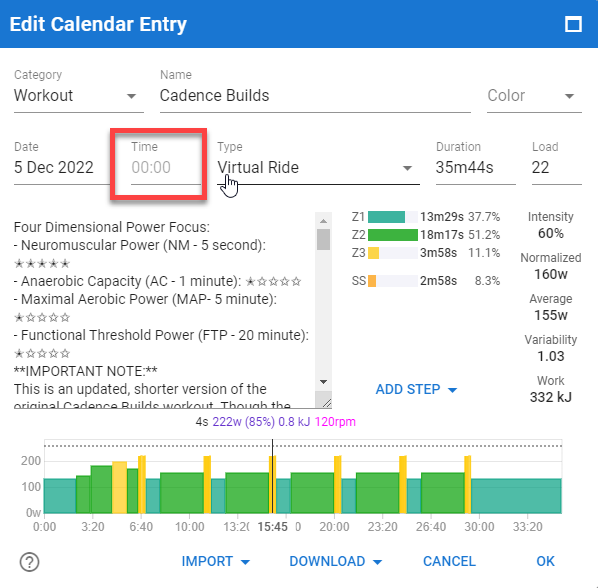

Right now there is no time in the workout details:
When using the export calender feature (intervals.icu) it could be helpful, when the workout will be shown at a fixed time at day instead of all day. I guess most people do their sessions more or less at the same time of the day.
That timing was added for sorting order in the calendar as some users were having multiple workouts in a day and wished to have the order the same as their workout timing.
Which timing was added? There is no timing except the “all day” timing.
The one you placed in a Red Box. That was newly added to indicate when the workout should start at.
