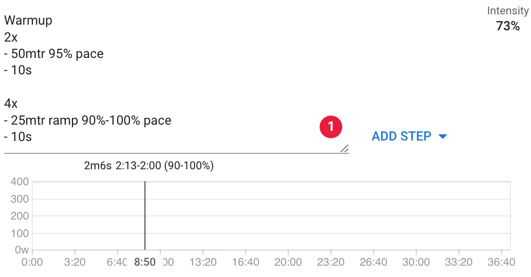

Whenever I have a swim written out it populates time, load and everything, but the intensities of each interval aren’t showing on the graph at the bottom.
The weird thing is, when I hover over sections it shows the data as if the intensity interval is there, but there’s not colored bars.

I created the workout on my profile (worked fine), added it to the library and now whether I open in the library or drag to the calendar for a coached athlete, the intensity bars don’t show up.
Lauren White - Intervals.icu
See swim for April 25.
Aha she doesn’t have any pace training zones setup for swimming: Intervals.icu
If you fix that then the workout should show properly. You might need to open it and make a dummy edit.
Ahhh! Perfect. All fixed.

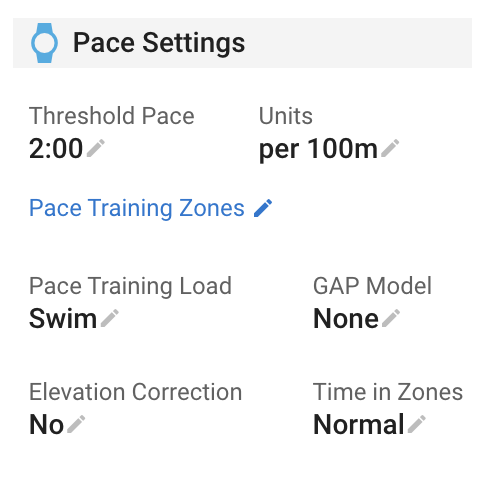

You need to capture training zones for swim in /settings:
Screenshot 2023-11-10 at 05.49.52
How did you set threshold pace for swim? It is supposed to fill in some default zones as soon as you enter a value. It did for me when I tested. Did you set it using the API?
Hi David,
Thanks for the reply. I set the “pace training zones” manually now and I can see the training load values. However, the threshold pace was set manually from the webpage. I did not set it via the API. Now, it seems to be ok!
