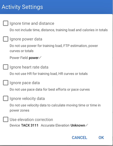

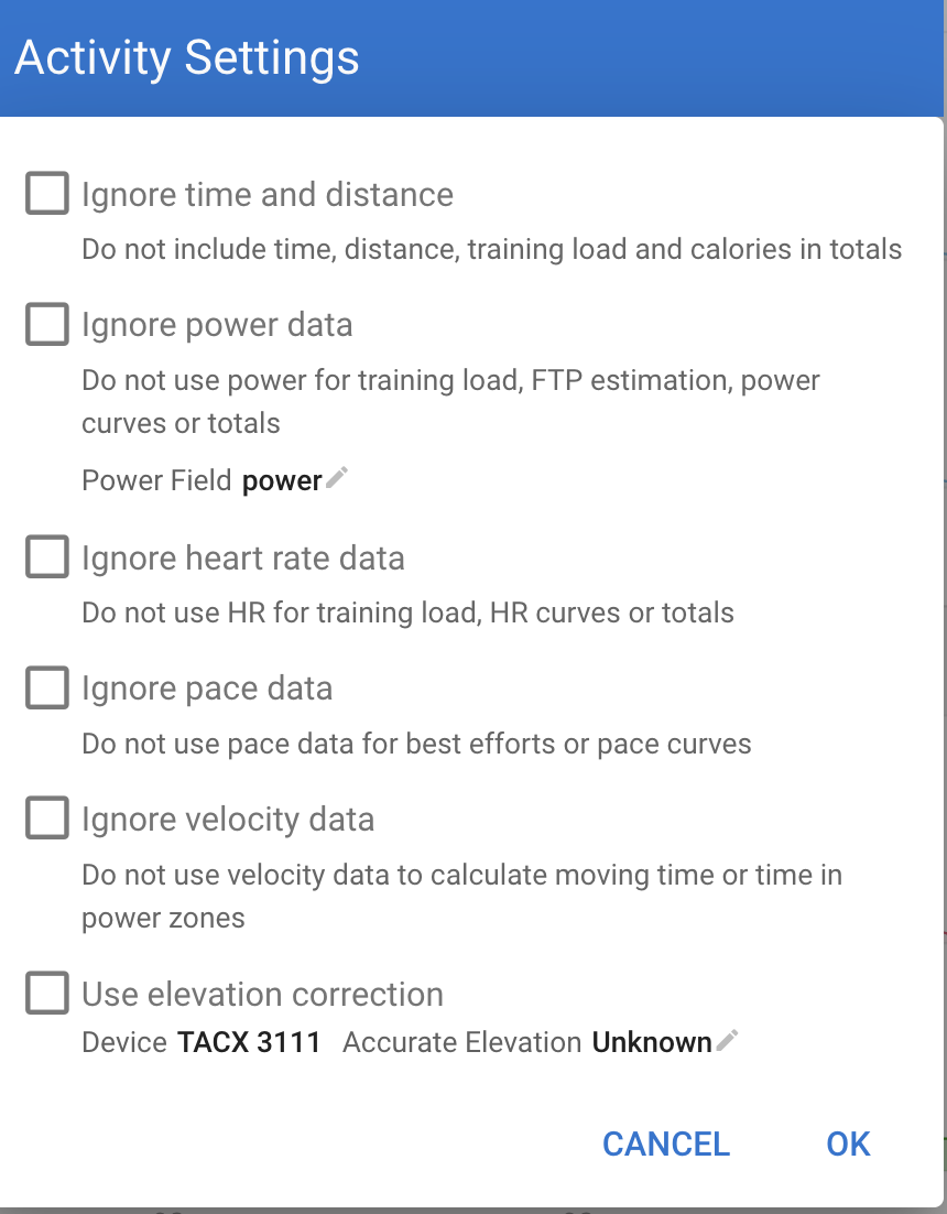

Go to The activity… Action → Settings → then Use Elevation Correction (turned OFF). This is when your Watch has a Baro and this will force intervals.icu to use the baro data instead of getting the data from maps topo
Configured, and elevation gain has changed. I’ll check after next activity. Thanks.
