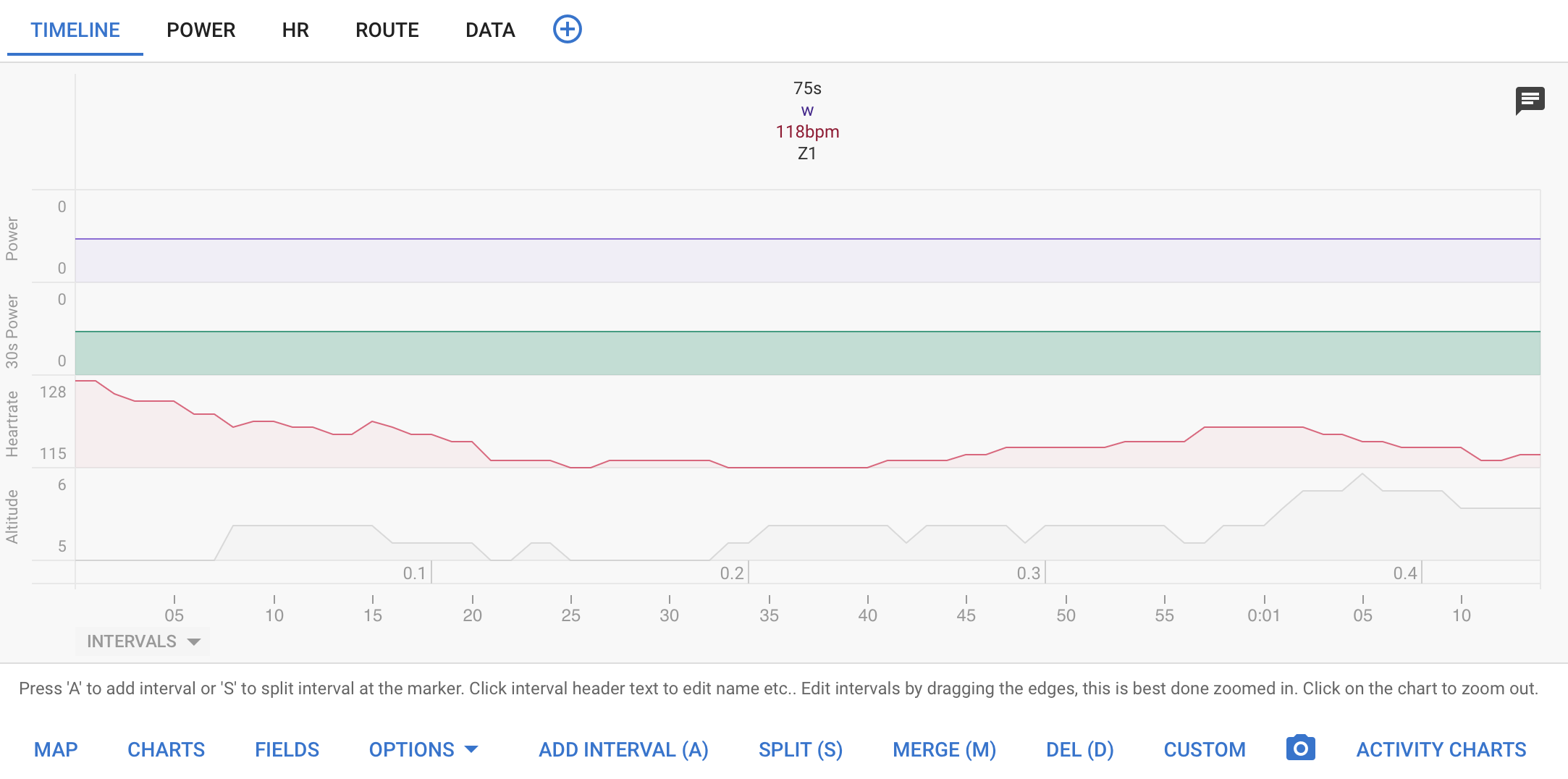

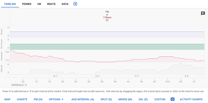

Whenever a cycling activity is synced from the Suunto App to my account, I can see the other metrics displayed correctly, but the Power curve shows a 0 W flatline.

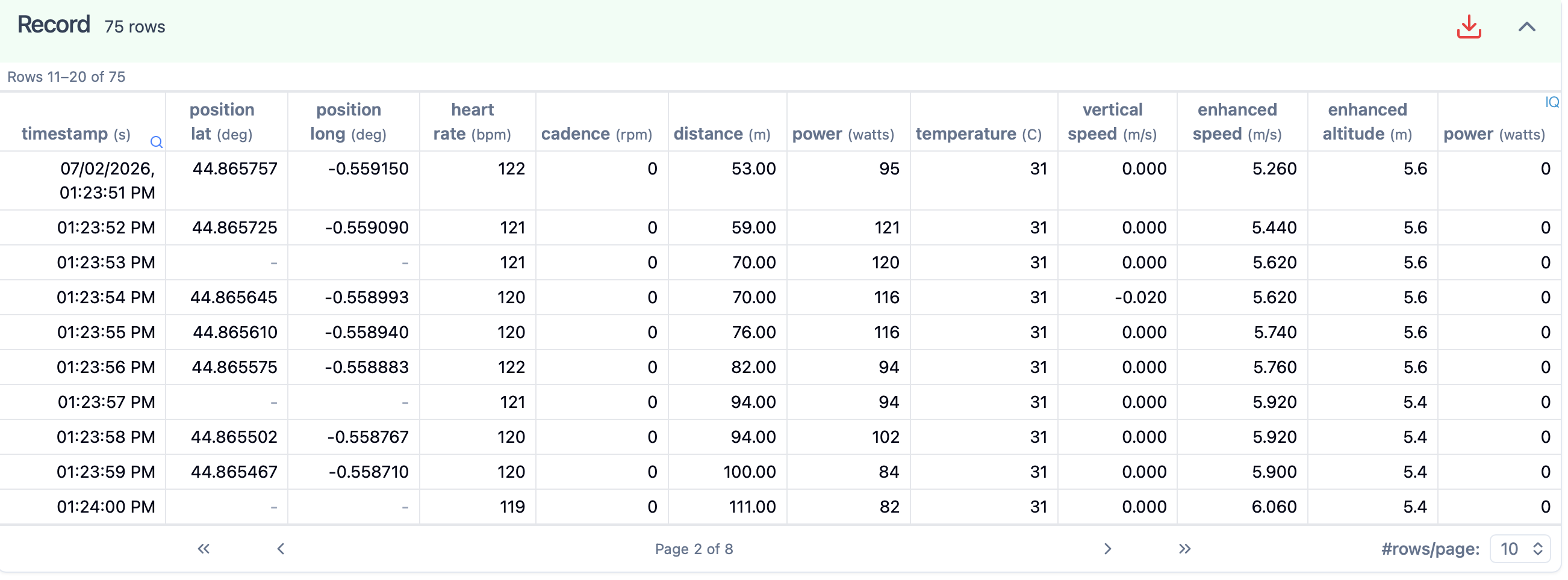

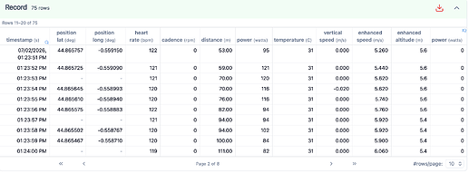

The original fit file downloaded from the interface correctly contains data in the power column :

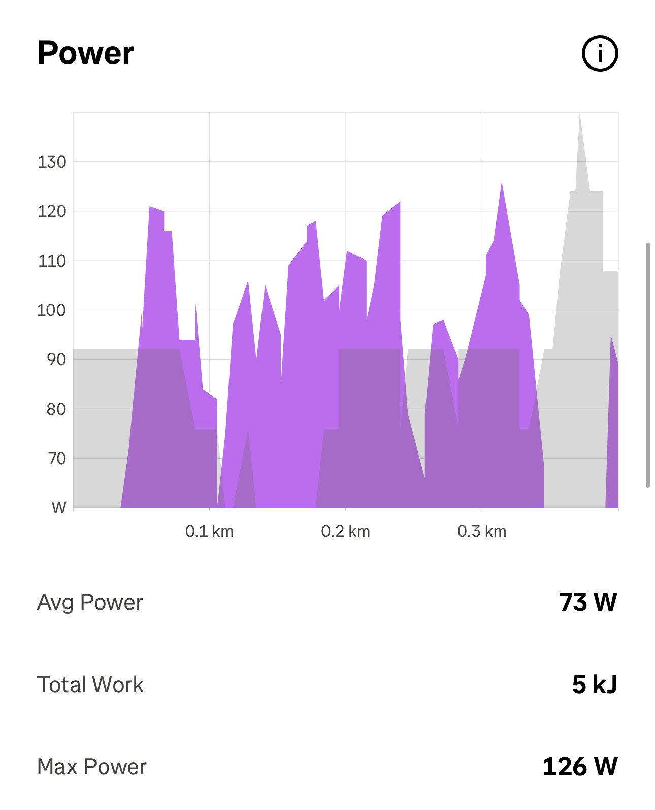

The same activity synced from the Suunto app to Strava correctly displays the power data :

  • Power data doesn’t display correctly in the activity. Observed behavior : power curve is shown as a 0 W flatline. Expected behavior : power curve should show the power data available in the fit file power column.

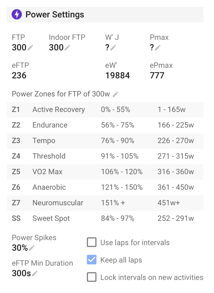

Do you mean in the activity Power tab ? I entered an estimated FTP, which I believe was used to deduct zones :

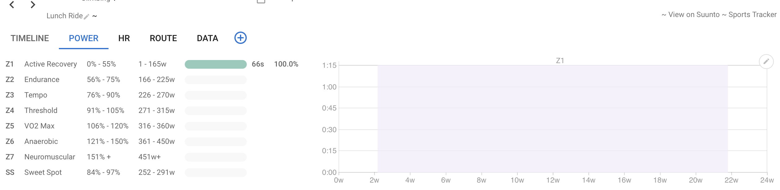

Everything is shown in Z1, even in other activities where the data actually goes over 165W.

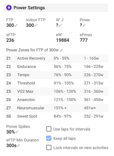

I found the settings screen you were probably referring to, the zones seem to be configured :
How comes your cadence is zero?
I’m pretty sure Intervals uses cadence in its algorithm to detect false power values.
AFAIK, every power meter also sends cadence.
And you have a second power stream from an IQ field which is zero (probably because cadence is zero).
Check the Actions-Settings menu to see you can select the other Power stream.
You for sure have some strange configuration that is misleading Intervals.
