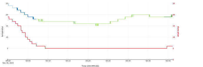

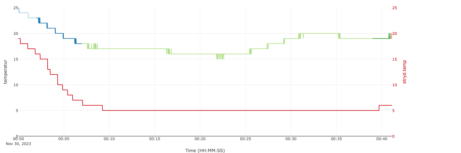

Thanks I wasn’t aware of this Stryd update. Here’s a plot (using a different system) of Garmin wrist based temperate vs Stryd. Takes a few minutes for Stryd to settle/cool down having been in the car, but shows how much body temp affects the Garmin measure.
