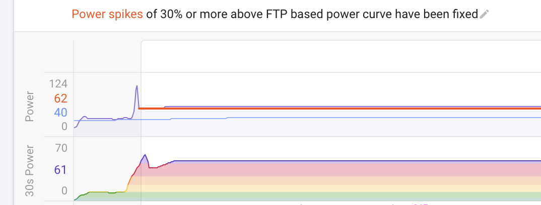

The power for your run has been clipped because Intervals.icu thinks the power is too high based on your FTP (50):

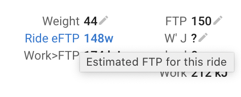

I changed your FTP to 150w, did Actions → Reanalyze and now Intervals.icu estimates your FTP to be 148w so close to Stryd:
Screen Shot 2022-05-11 at 17.53.00
