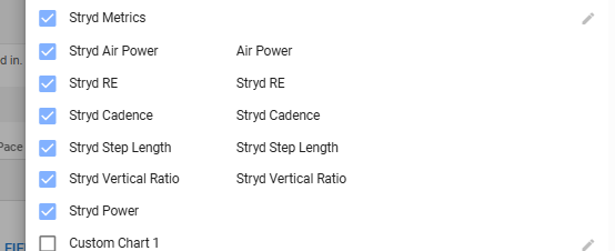

I can see the power recorded but there is no other stryd metric like vertical oscillation or something else, i tried every kind of shared charts.
moreover, if i try to show some stryd fields like this one
the result is a “?”

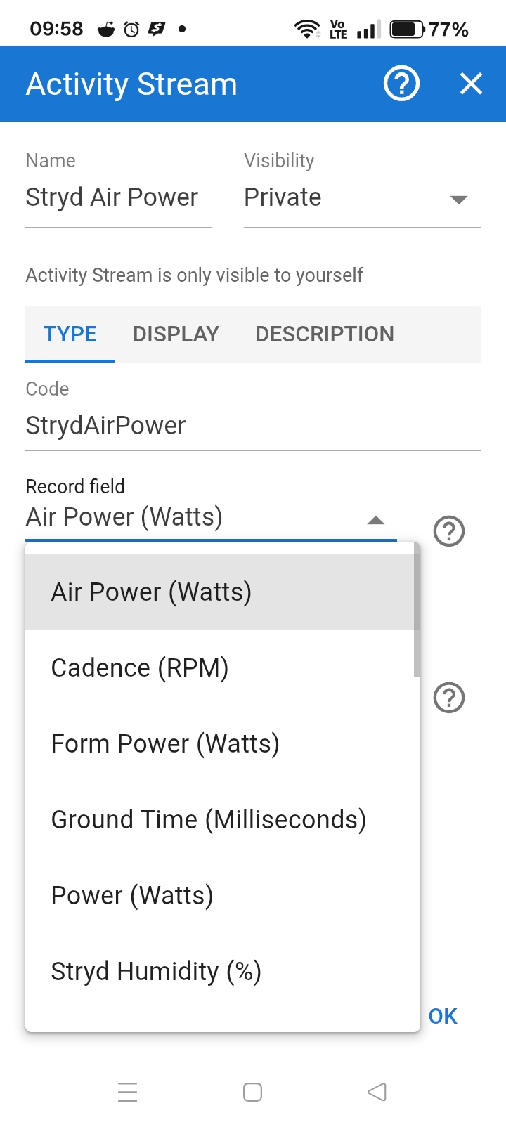

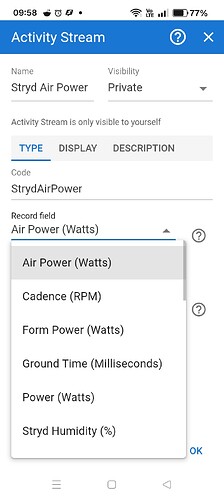

Hi Daniele, use the generic custom streams, custom fields for VO, GCT, Vertical Ratio, create new custom streams/fields or modify existing ones for LSS, ILR and Air Power.

To modify a existing costume stream change the record field appropriately
An don’t forget to Reprocess the activity afterwards.
thanks,

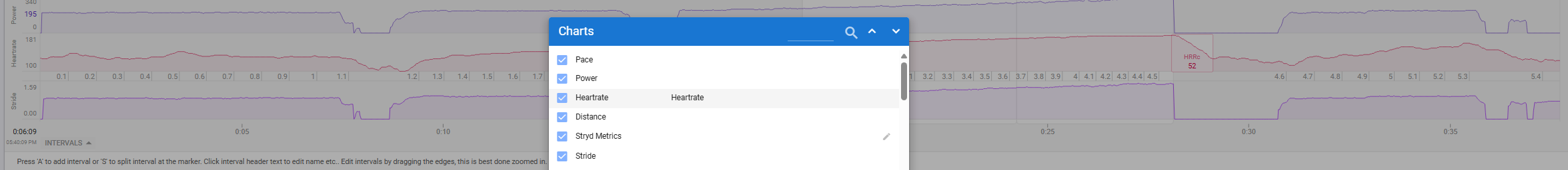

i activated these custom stream
but i don’t understand where i should see these data, nothing changed in my activity even after i reprocessed the file.

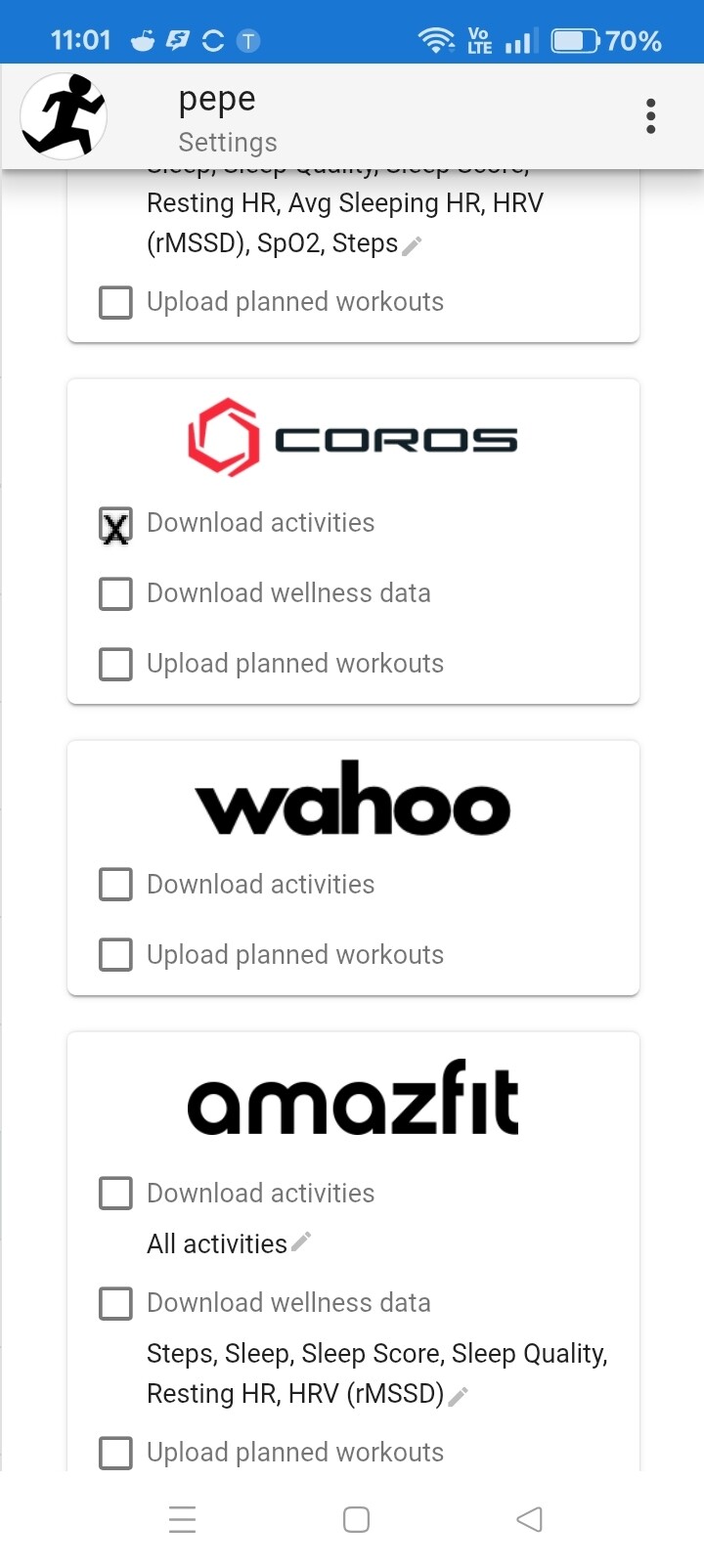

If your data comes from Strava, then the data won’t be available. (Strava strips this out)
ah ok, should i export the activity from Coros instead of strava?
Because i tried and i got the green message
but then the activity is not in my calendar

Go to Settings>>Connections
and check Download activities
yes,
it’s always been like that
every activities has strava-coros import
then i tried to delete my last activity (the one with stryd pod) and re import that one again only from Coros and this is the message i got
but the activity is not there

You have to in Calendar view, upload, not download the fit file.
oh ok, got it.
now it is appeared the stryd stride lenght
but i did check these
tbh i am more interested in power (got it) , vertical oscillation aka stride height (missing) , ground time (missing) , stride lenght (got it) , cadence (got it).

For standard streams or fields (not Stryd specific) use streams / fields without Stryd prenominal
