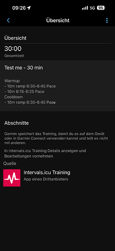

When I create a structured workout it gets synced to Garmin connect. But the steps don’t apppear correctly. Only as notes.
That’s a garmin connect limitation. The workout is fine once you actually start it on your device.

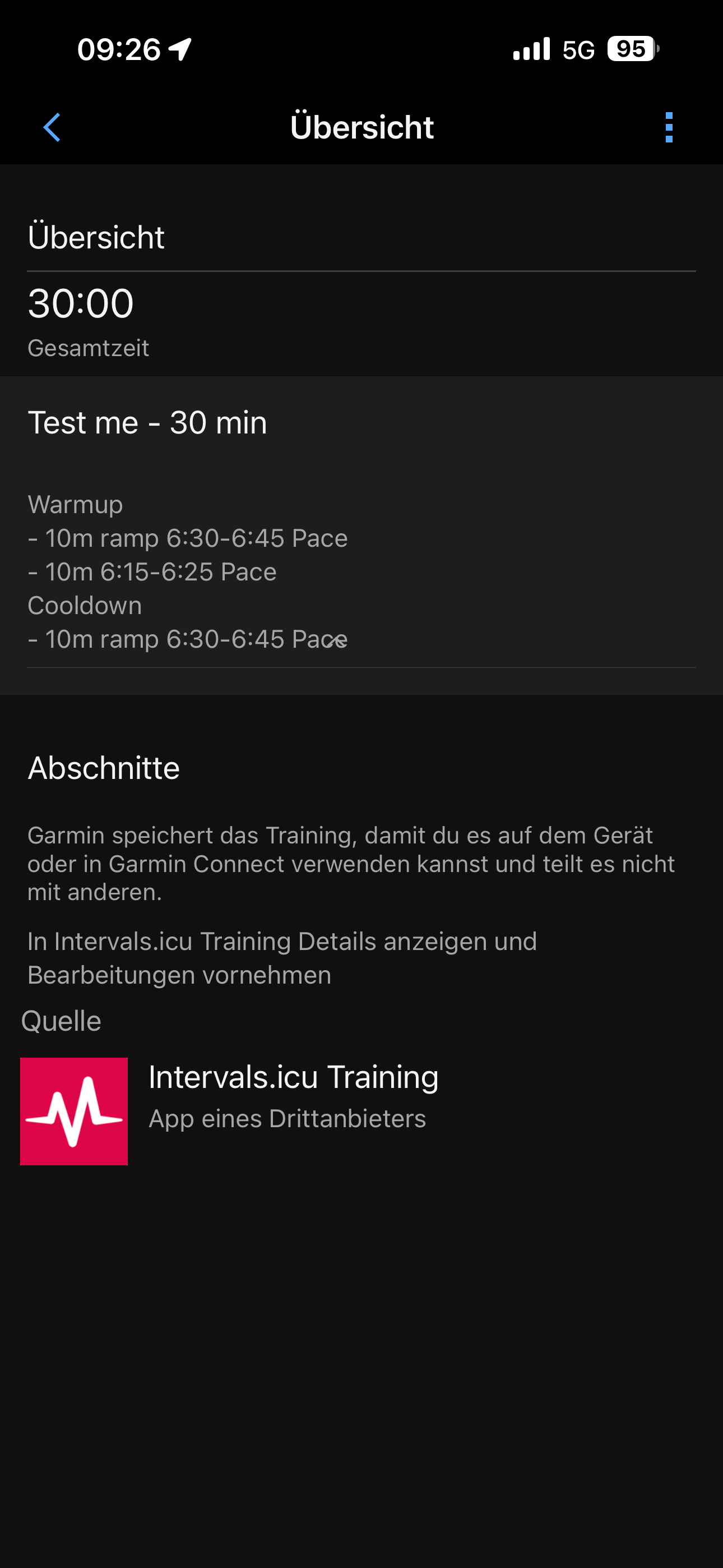

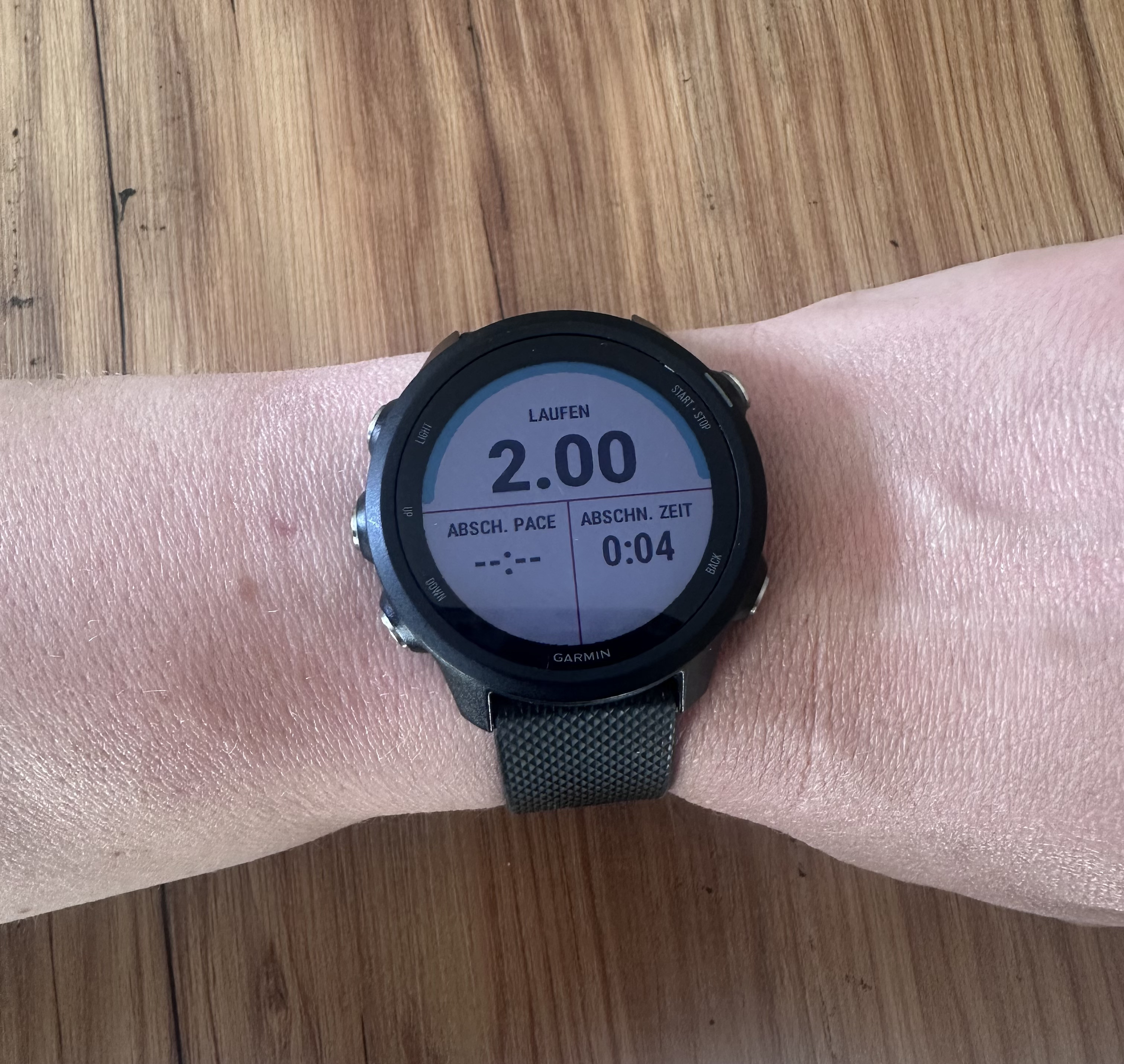

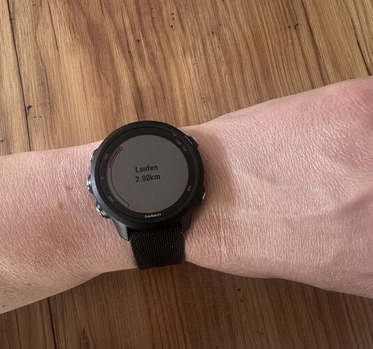

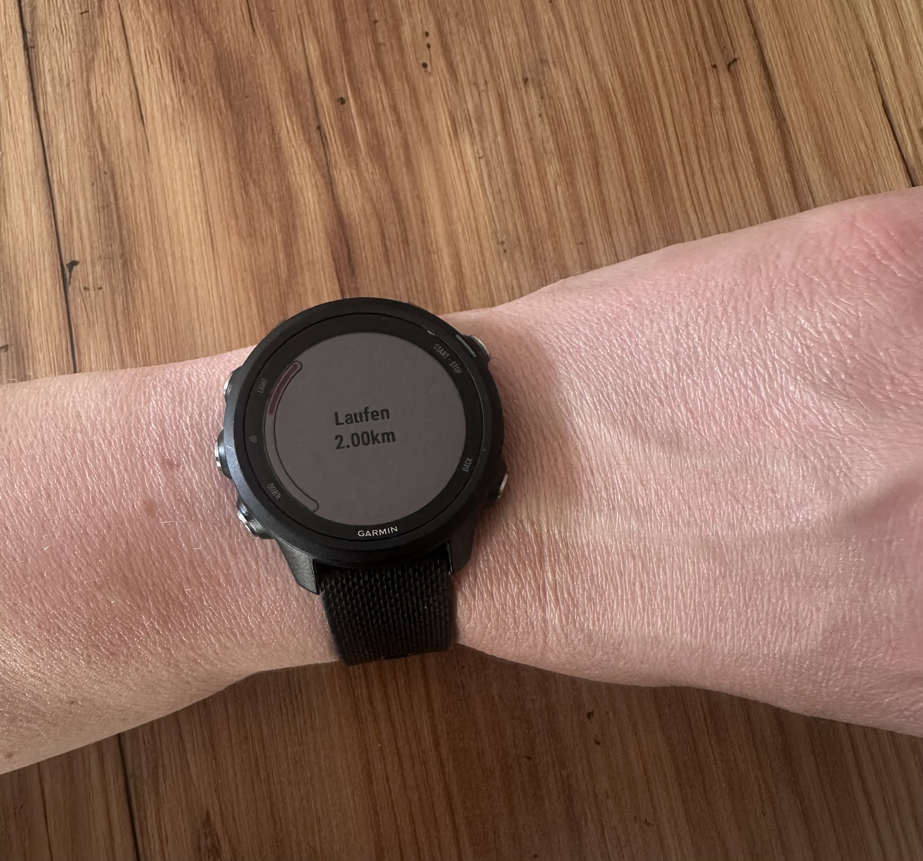

I am afraid this doesn’t work. I am not sure whether I am doing something wrong?
This is what it looks like on the watch:

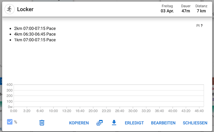

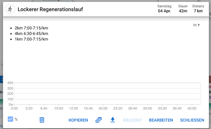

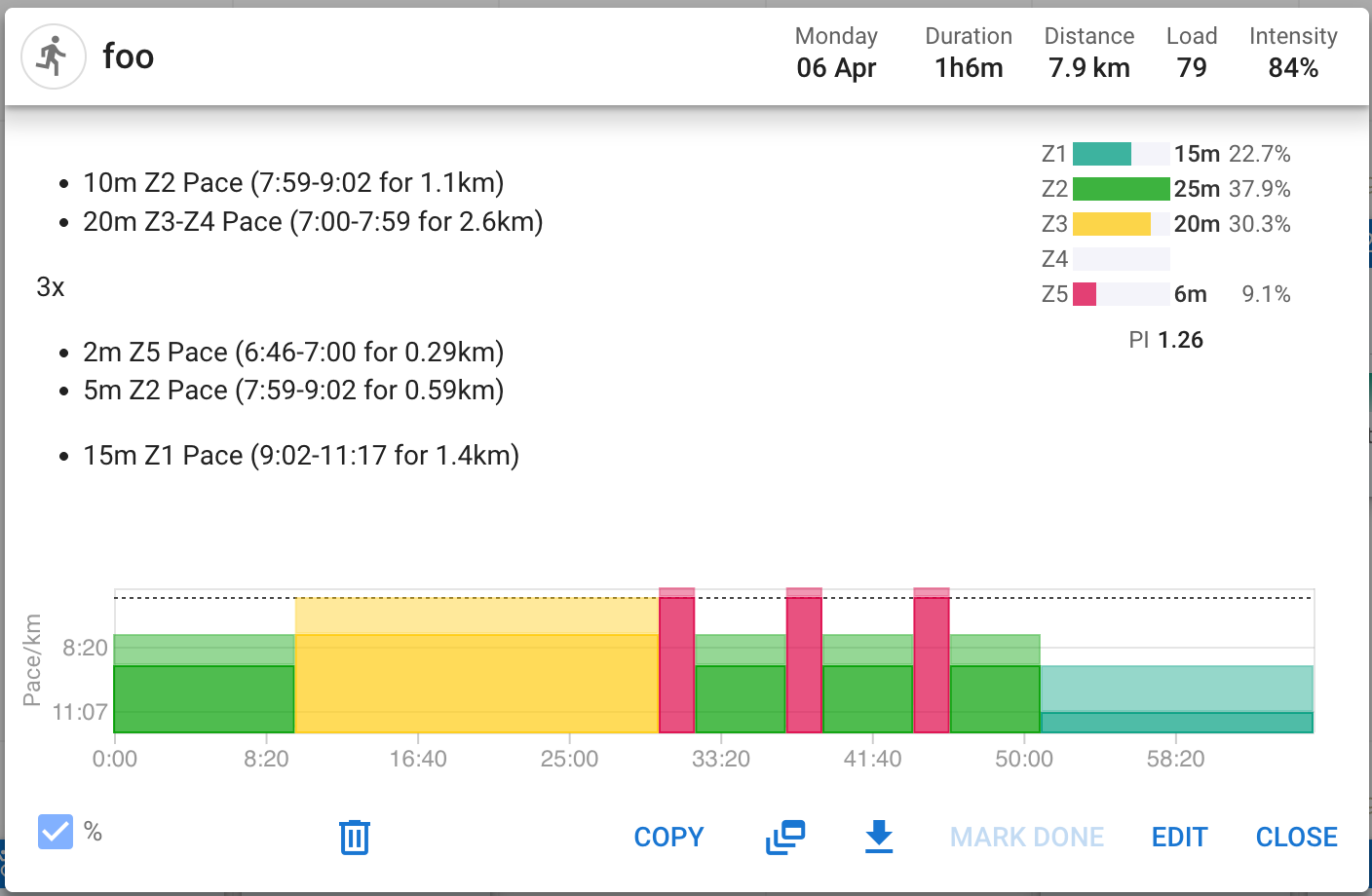

And this is what I have in Intervals.icu. Neither syntax works.

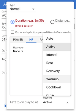

Try using the intensity field for your steps
Thanks for your message. Tried it and it doesn’t make any difference. Still no paces visible.

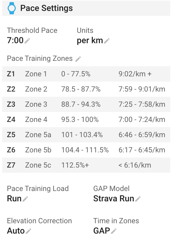

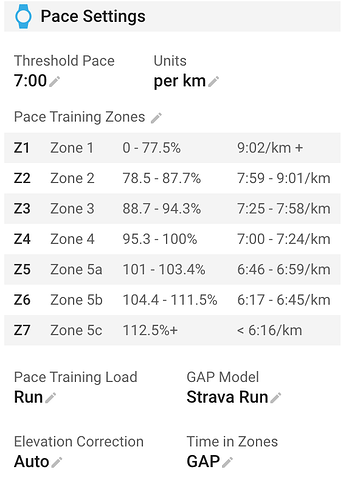

Turns out, what is required is to set a threshold pace manually in the intervals.icu setting. That wasn’t clear to me.
If I do that, the training is correctly created and transferred to Garmin.
