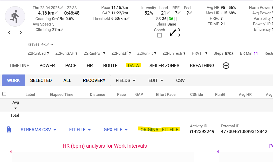

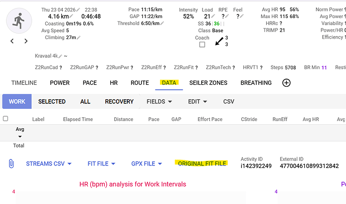

Is this the FIT file downloaded from Garmin directly or is it the FIT file that came to Intervals over the API?
Those used to be identical, but Garmin started limiting the content that is forwarded lately.
For us to be able to say something meaningfull, you should give us the one that came to Intervals automatically.
Edit: The name of the file downloaded from WeTransfer has a ‘_activity’ at the end, so I think it’s the one from Garmin Connect.
and I’d recommend Fit File Viewer
Here is the other file: link

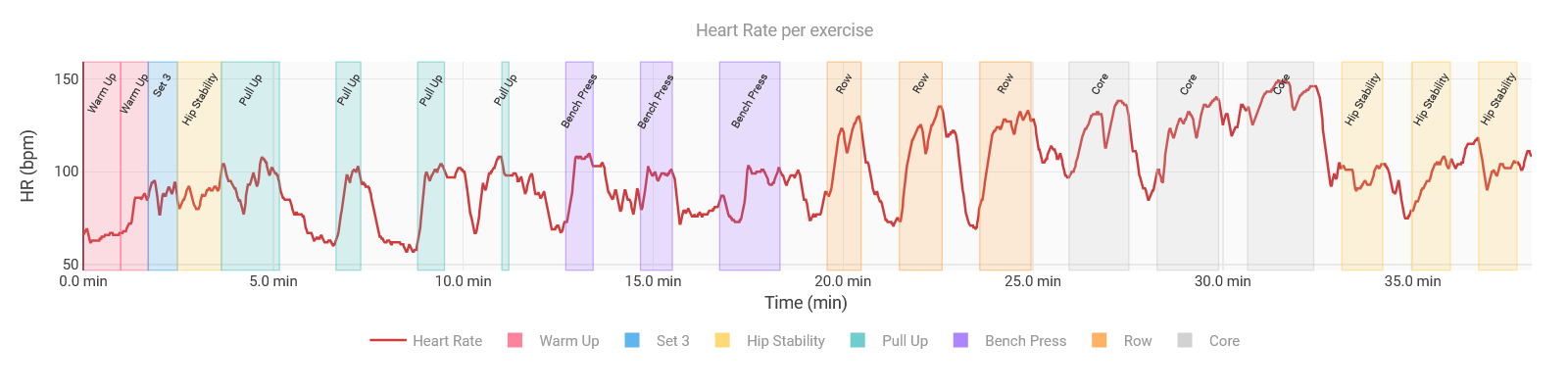

For those interested, I managed to do what I wanted to see! Feedback welcome!

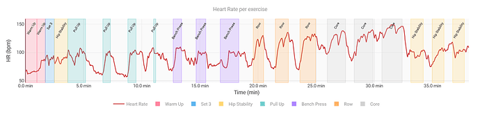

Step 2 — Add the charts
Both charts are available in the community. Go to Custom → Activity Charts and search for:
  • Strength HR Timeline — plots heart rate over time with colour-coded blocks per exercise category and a dotted average HR line per set
  • Strength Session Overview — per-set table with exercise, start time, duration, reps, weight, volume, avg HR and max HR
The LapData Activity Field from Step 1 must be set up first — both charts depend on it.
Important limitations
  • Exercise names show as generic Garmin categories (Squat, Lunge, Deadlift…) because Garmin strips the custom exercise names from the API export. Only the category ID comes through.
  • Reps and weight reflect what the device recorded during the workout. Manual edits made afterwards in Garmin Connect are NOT included, as Garmin does not write these back to the FIT file.
  • Tested on a Forerunner 965 with structured workouts created in Garmin Connect. Should work on any Garmin device that records strength sets in the FIT file.

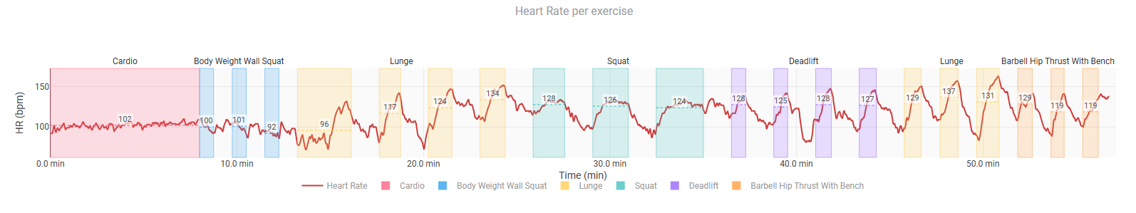

Quick follow-up on my own setup — I’ve been refining it and managed to fix a few things worth sharing.
Improvement 1: exact exercise names instead of generic categories
The LapData field contains not just category but also category_subtype. The combination of those two values maps to a specific exercise in the Garmin FIT protocol — e.g. category=21 + subtype=13 = “Lat Pulldown”, not just “Pull Up”. The full catalog covers 1184 exercises across 33 categories and is baked into the FIT SDK.
I built an EXERCISE_NAMES lookup table (catNum_subtypeNum → display name) into the chart script. Instead of “Row” you now see “Chest Supported Dumbbell Row”, instead of “Pull Up” you see “Lat Pulldown”, etc. Works retroactively on all past sessions and automatically on future ones.
Improvement 2: cleaner labels on the chart
With full exercise names, showing a label above every individual set got messy fast. Fixed by grouping consecutive sets of the same exercise and placing one label centered above the whole group, while keeping individual coloured blocks and per-set HR averages intact. Labels are now horizontal and sit just above the chart area so they don’t overlap with the HR data.
