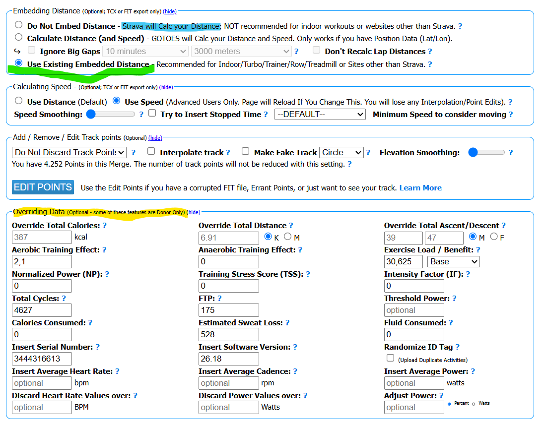

Here’s an example of what I mean. This is a view from Gotoes utility.
The values in the yellow section are summary values and simply go through to the first part. The next parts have recalculated values from the point you split.
If distance was recalculated from the lat/long position, it would be correct for all three parts. It’s not because Strava ‘shows’ it correct, that the info in the FIT file is correct. Strava always calculates the distance and is not using the summary field for it.
