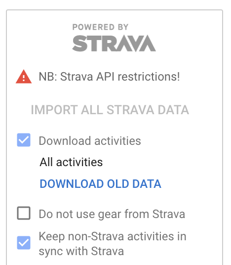

It might be related to the “Keep non-Strava activities in sync with Strava” in the Strava box in /settings. If the activity is not a race on Strava and you have that box ticked then the change on the Zwift activity will be undone.
Thanks, just trying with that setting off. I think it’s persisting now.

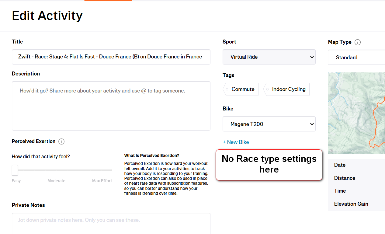

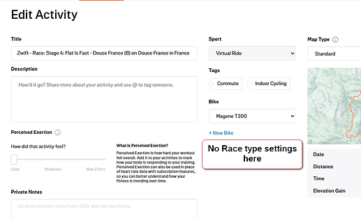

I couldn’t even see where in Strava an activity was marked as a race.
Noticed the same problem this week with Zwift workouts. I have sync with Zwift and Strava. Activity from January 16th marked as race does not reset this mark. Activities this week marked as race reset after refreshing the page. This did not happen before and I did not change the settings. In Strava I can not set the race mark in the workout settings for virtual rides.

Disabled the setting “Keep non-Strava activities in sync with Strava” and the race mark is not reset, but I do not yet fully understand what else this can affect.

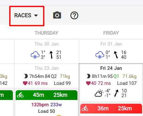

Also, today’s race did not appear in the Races list.
Yep same here. In Strava, I can’t mark a virtual ride as a race, so I do that in Intervals. After a few minutes it’s unmarked as a race in Intervals again.
To mark a virtual ride as a race, you have to use the Strava app on your phone.
