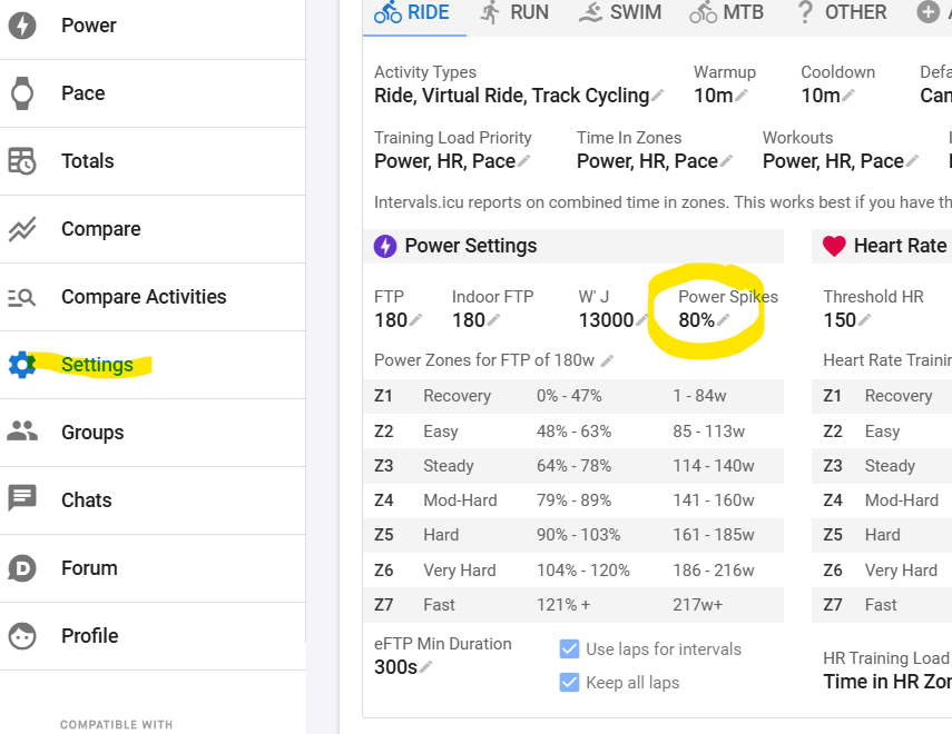

First guess would be that you have false spike detection in Intervals.
Set Power Spikes way higher (even to 999%) and re-analyse your activity to see if this sorts it out.
Thank you. Power spikes was (default?) on 20%. I changed it to 999% and will see what happens.

Spike setting has no influence if your power meter is spike-free. Some have spike artefacts every now and then. If so, you need to experiment with the spike setting until faulty spikes are filtered out without loosing any real data.

Mine is set to 50%, and very seldom get power spikes. Very seldom meaning that if I do get a spike it’s a genuine problem.
