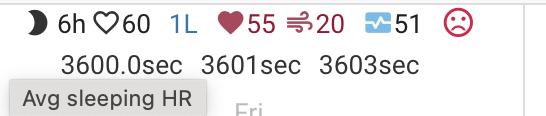

@MedTechCD since you’re the creator. Can you please ammend this to show .0f format similar to the other 2 you created?
To Keep it consistent as sec rather than milisecs
Tx
Screenshot 2025-02-25 at 10.46.07 AM
Yours:
From WorldOkayestCylist. ( I see he added the convert so it’s in hh/mm format)
or is it that I can edit my own “copy” of it? (Cos I tried this and it works but unsure of the repercussions.)
Edit: Okay… looks like those that has the same “Code” like the one I pasted above from @MedTechCD and @WorldsOkayestCyclist, the diff which I can see is the other is converted to hh/mm format. But internally from the API, both are stored as seconds.
So if I Upload Wellness to DeepSleep at 3777(secs), Both (MedTechMd or from worldsOkayestCyclist) will update the same “Code” w/ the same value. But the display to the user will be different.
