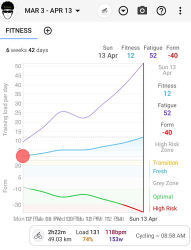

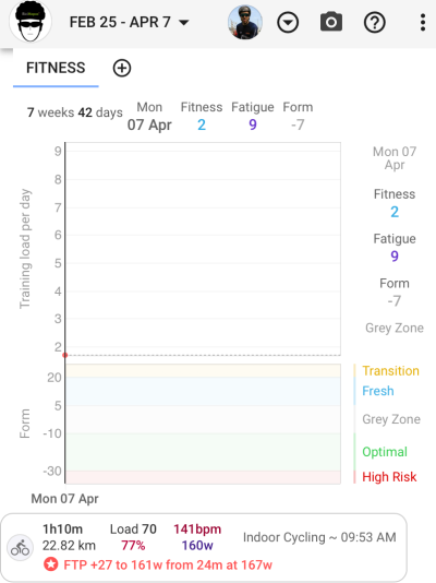

This is a screen shot of the first day when an eFTP was immediately calculated

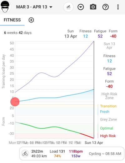

This is day 7, yesterday (the red dot shows when the “new” eFTP was calculated):

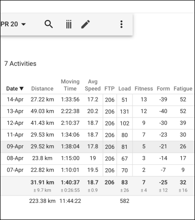

And this is the activity list view showing Fitness, Fatigue and Form during the first 8 days (including today):

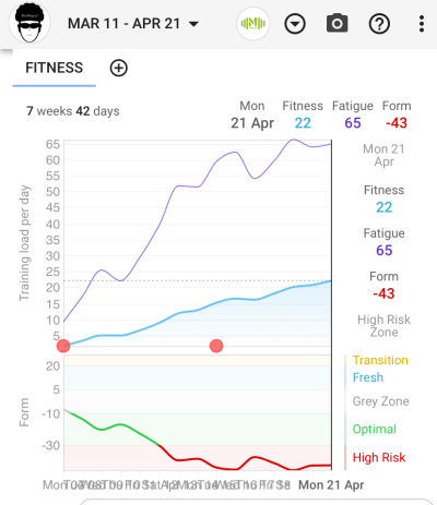

After 15 days running this experiment, this is how the Fitness Chart looks. Considering that Fitness uses a 42 day constant, there are still 27 days in the average calculation with no data and the effect has been several days in the red zone, though it is not significant yet.
Day_15_Int
The Ramp Rate for the first week was 11.7 and 9 for the second week. I am riding 6 days a week with a rest day on Thursdays.
Of course, the Fatigue, Fitness and Form trends on this experimental account are quite different from those in my regular account.

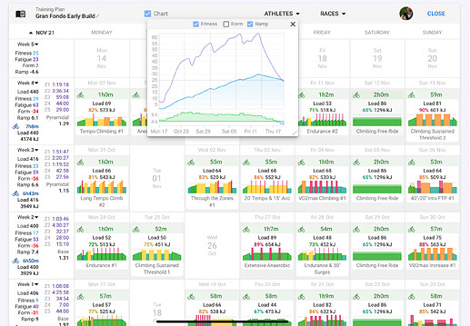

Interesting project. But you can also do that with a training plan. Then you can also play through different scenarios, and define different “form” and “fitness” starting points, etc.
For people who are starting out with the PMC chart and don’t have detailed data (like someone who just bought his first sports device) but were already active on regular bases, there are a couple of thumb rules to set a starting Fitness in the ballpark.
If you have an idea how many hours a week you were active over the last month, multiply that by a load of 45 (which is 65-70% intensity) and divide by 7 to get an acceptable starting Fitness number. This will balance the PMC chart much faster compared to waiting 6 weeks.

You are correct but, based on the images shown in your post, it is evident that you have a very good knowledge of both the Intervals platform as well as training with power.
I have done those simulations with my CTS-TSS planning worksheets as well and know what to expect.
This experiment has the purpose to show someone who is just starting training with power using Intervals.icu and has no history data, what they could expect when starting. Such a person would not yet have the knowledge to do the planning you show in your images.
Eventually, once the 42 days are completed, I will create a Youtube video explaining new commers to power training what they will see in the PMC in the first weeks.
