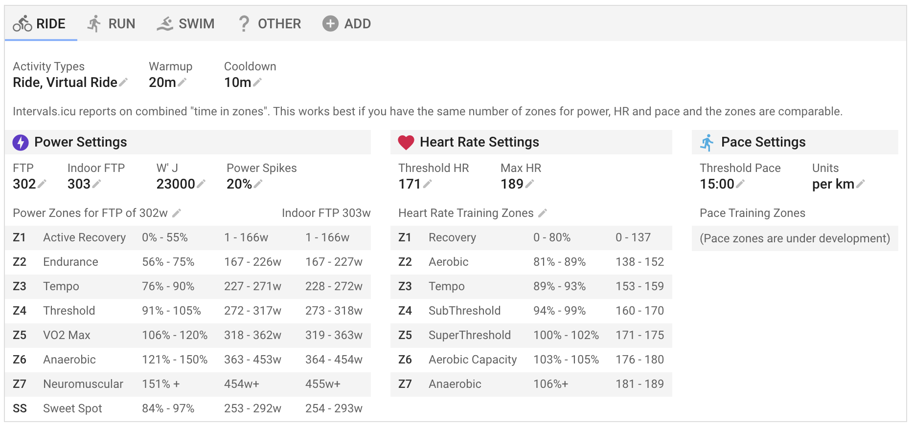

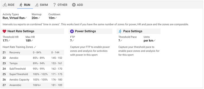

Still some way to go but quite a bit is working. Some screenshots from my laptop:
The zones are completely configurable now (number, ranges and names etc.).

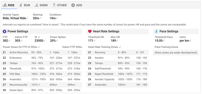

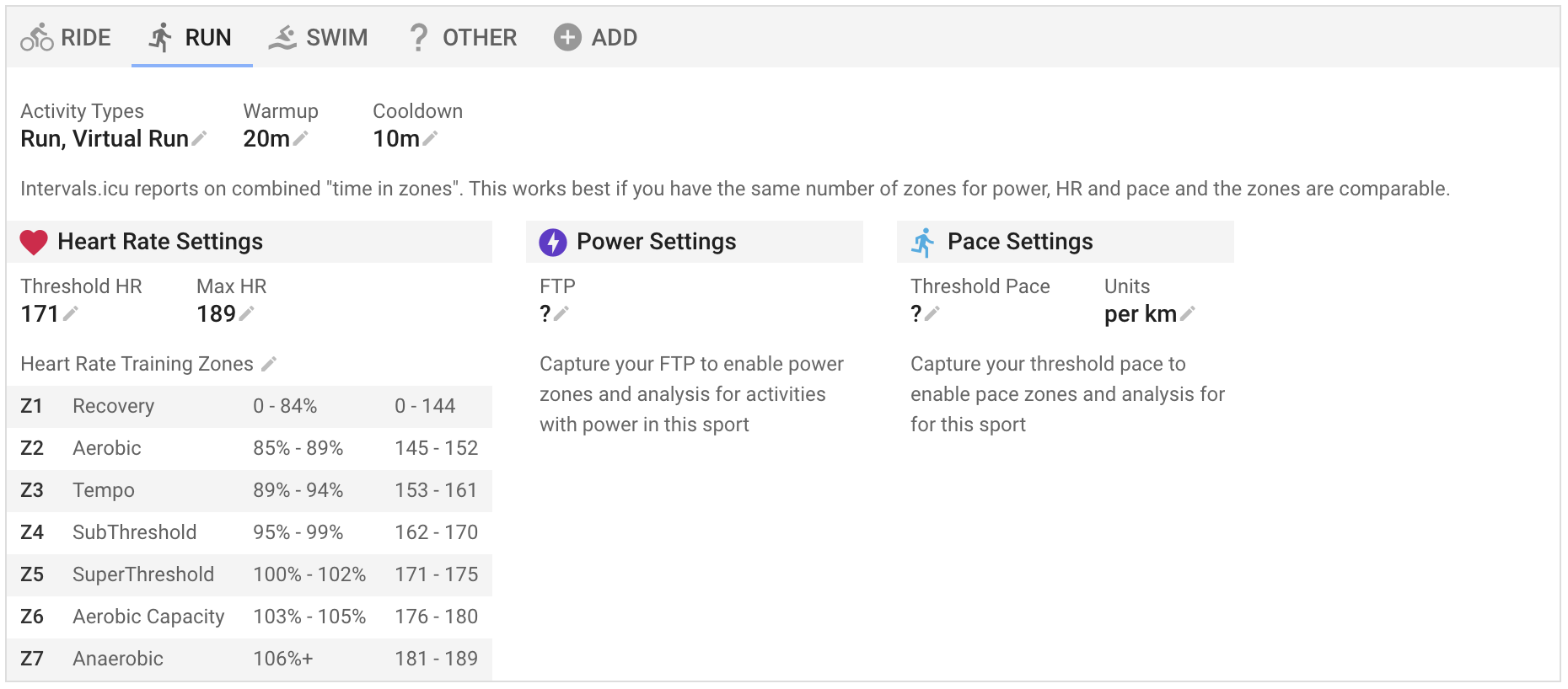

It looks awesome, thanks again for your work!
Is it also planned to use the configured zones for planning workouts. Eg 5m @ Zone 2 running pace…
BR Stefan
Tx. Yes it is. But I need to get this basic work out the door first. It involves many changes all over Intervals.icu.

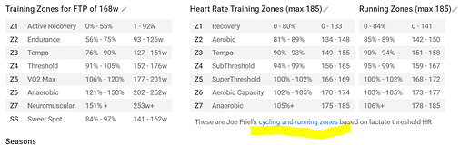

If you want to add a How to link for people that want to learn how to know their zones, i would suggest A Quick Guide to Setting Zones | Joe Friel
Looks awesome! Why is run pace on the cycling tab?
I am trying to generalise everything so any sport (collection of activity types) can have power, HR and/or pace stuff. I might disable pace for cycling specifically. That does look a bit weird.
