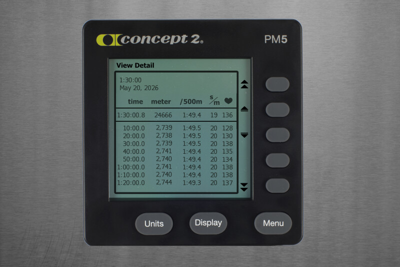

For most workouts on my Concept2 erg, the import works perfectly fine. However there are some workouts that the Concept2 app (ErgData) does not automatically save, and so I have to import them using the Concept2 tool. When I do so, the workouts appear correctly according to Concept2:
But the data on intervals doesn’t have the right duration and isn’t pulling heart rate, and therefore doesn’t calculate load correctly:
In this case I set the load manually but I can’t seem to set the heart rate or duration.
