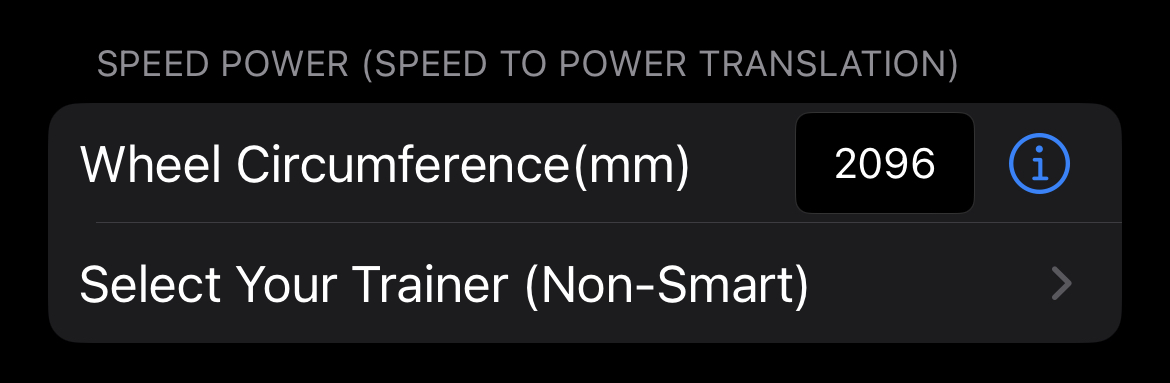

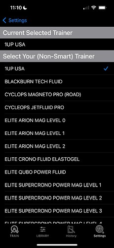

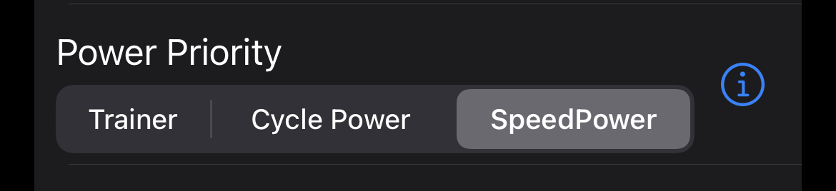

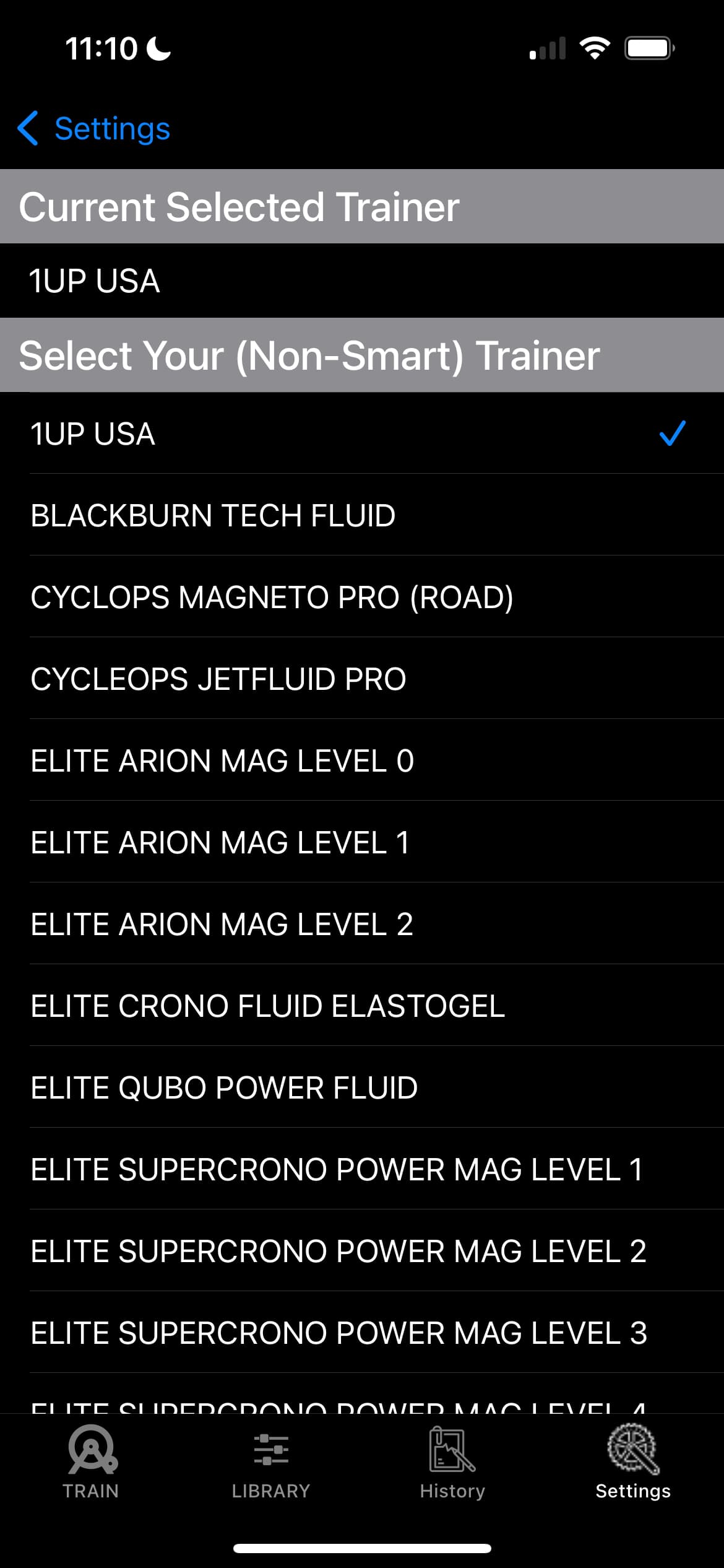

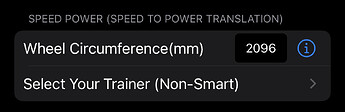

Yeah… BreakAway does have this feature. In fact, I was doing this way before I got my DirectDrive Smart Trainer.
In The App, I call it “SpeedPower”
But a word of warning… the numbers are NOT going to be accurate, when I got an actual Trainer w/ Power, the numbers (for my FTP) differ by up to 50w.
Having said that, if you’re up to mucking w/ the custom javascript, then by all means. (I’ll be honest, javascript is not my forte, but I had to learn it to look for clues on intervals.icu’s API as well as some other sites like Garmin)
I’ll chalk it up to differences in Drive Drive vs Wheels On (Slippage) and of course the differences in the (some of the manufacturer provided) Speed-To-Power Curve

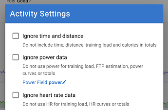

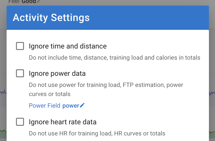

  4. Set original powerless activity settings to ignore time, distance, load, HR, etc data to avoid double counting effort (I could move the original, but I’m keeping it there just in case)
