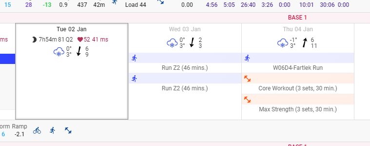

Hi all, I have what I think is a fairly basic issue but I can’t seem to figure it out on my own. I am in the process of completing a HR-based running plan on Garmin Connect as part of a bastardized Training for the New Alpinism program.
So far, I’ve been syncing my running workouts from Garmin Connect to Intervals and add my strength workouts in Intervals. The strength workouts appear to sync back to Garmin Connect and then back once more to Intervals, resulting in duplicates, I think? Does anyone know a better way of doing this?

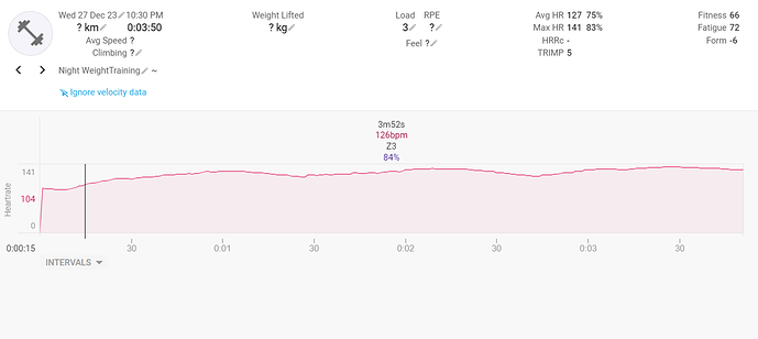

If you open one with time, you will open the finished activity with metrics (HR for example if you are wearing a HR monitor). If you open one without time, it will be what you had planned. No measurements, only the sets and reps that you had planned.

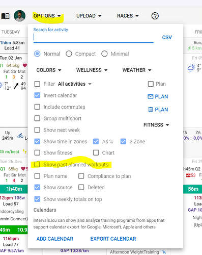

If you don’t like this behaviour, you can change the setting in Options on the calendar. Unchecking 'Past Planned will hide the planned workouts in the past. The planned will remain visible for today and the future. The past ones will no longer be shown.

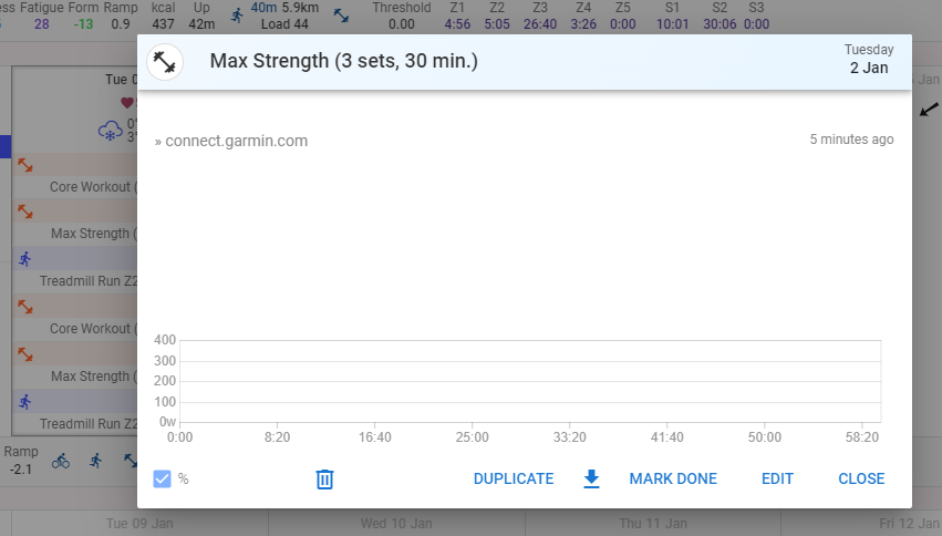

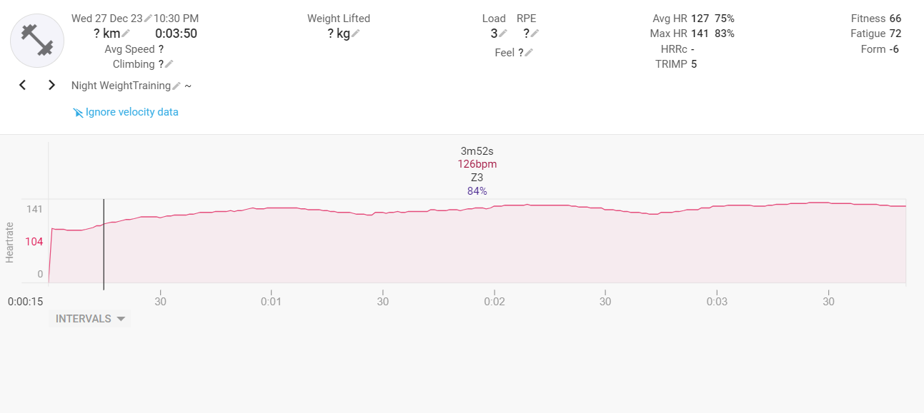

Similar I guess. Open up some of those to check if they are Planned workouts or finished activities.
If it opens like this:
it is a planned workout
And like this:
It is a finished activity.

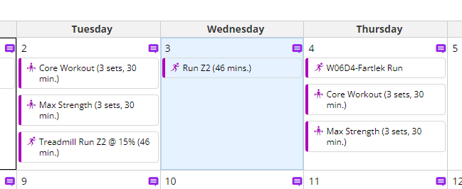

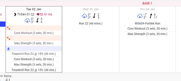

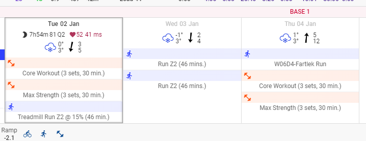

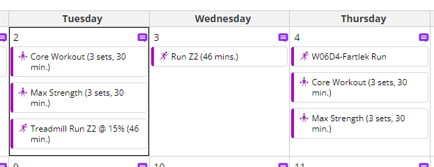

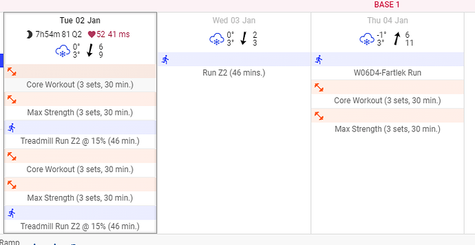

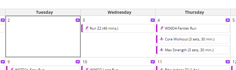

Earlier this morning, all of my planned Garmin activities from Connect were duplicated and after a page refresh only today’s are duplicated. I deleted the activities showing time (30 m Core, 45 m Max Str) that were made in Intervals and planned everything in Connect last night after posting. Here’s a screenshot of what all the Garmin activities look like in my Intervals when I click on them. You can see that Core, Max Str, and Treadmill have doubles in the screenshot. My Garmin Connect does not show past activities so duplicates in the past aren’t an issue.
Here is what my Connect looks like for Tues-Thurs.
Thanks again!

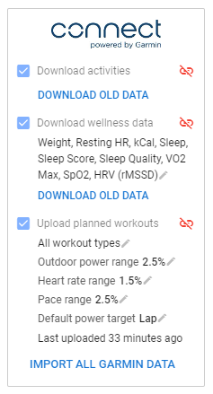

I only use Garmin and this is what my settings look like ATM.
I’m not super confident because I rarely use the planner function but something seems to create a loop.

If you want to use Garmin Connect for planning, uncheck Upload planned workouts in Intervals.

I deleted all of today’s workouts from Connect and now there’s a duplicate of tomorrow’s workout.
And when I re-added today’s workouts in Connect the duplicate on tomorrow disappeared and today’s reappeared.
Could this be a bug in Intervals and how it displays Connect’s data?
When I go into Options > Edit Calendar (for Garmin) > and uncheck “Events are planned workouts” the calendar syncs and a set of the duplicated workouts do not update, but everything else does.
As of approximately 4 PM PST (12 AM GMT), tomorrow’s workout is duplicated.

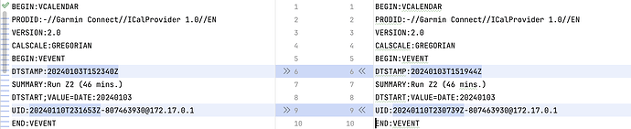

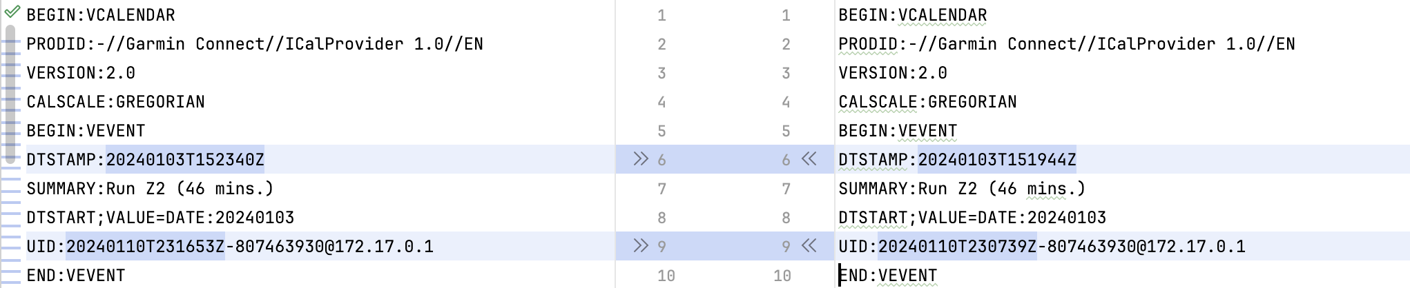

Tx so much for trying to help out @MedTechCD but it seems this is a Garmin problem. @pclangemeyer I pulled your calendar from Garmin twice a couple of minutes apart and it comes back like this:
The “UID” field is supposed to be a stable unique identifier but it is changing every time and causes the dups.
Intervals.icu has a workaround for this problem that I have just tweaked so it will sort this out (same day, name and description? same workout). I will deploy Thursday AM (GMT+2).

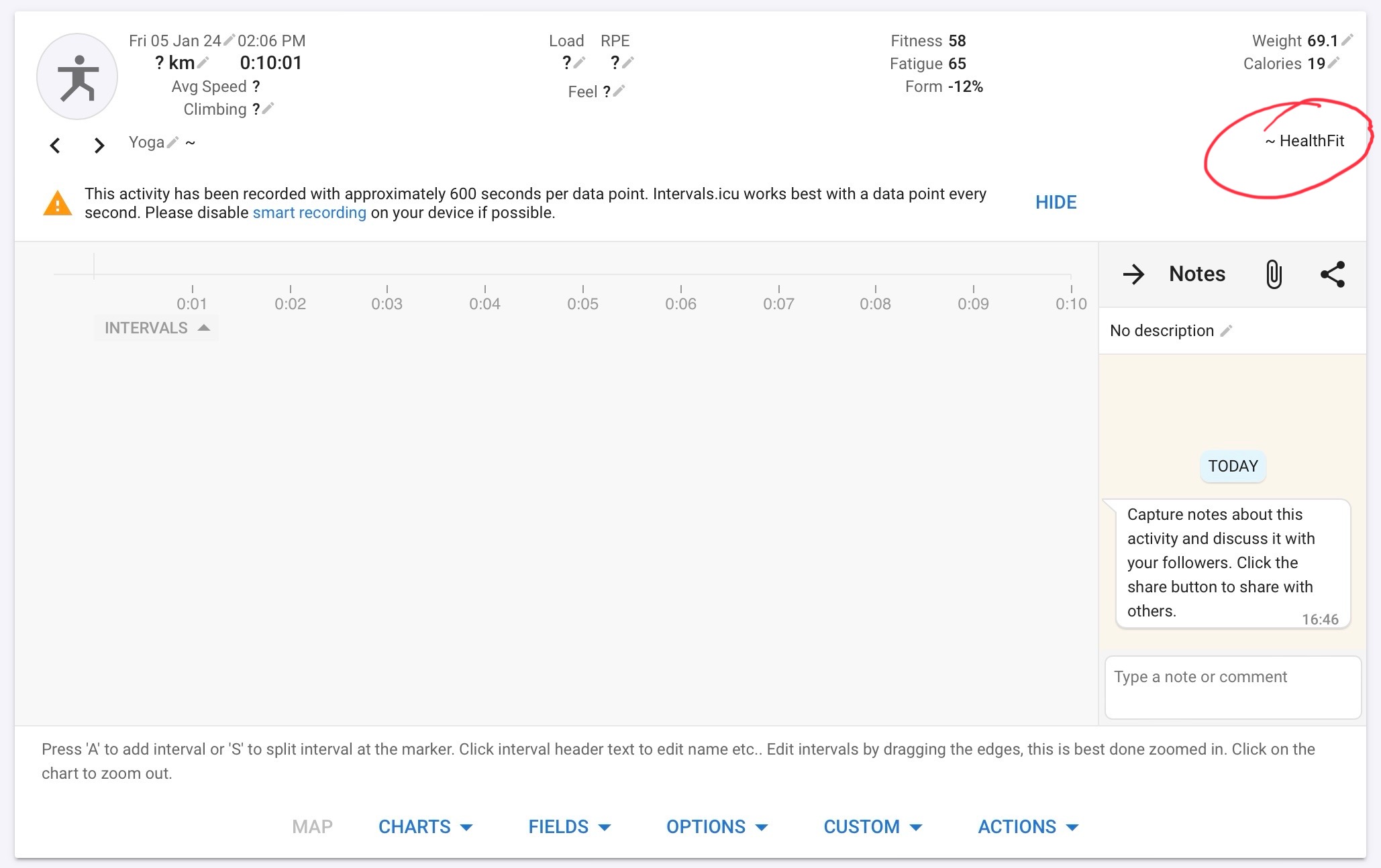

Thanks for this… I was waiting for the issue to recur and despite being certain I was only syncing from Garmin - the duplicate activities have indeed been created by a loop. I hadn’t realised that HealthFit was also looking at my activities.
All sorted, thanks again.
