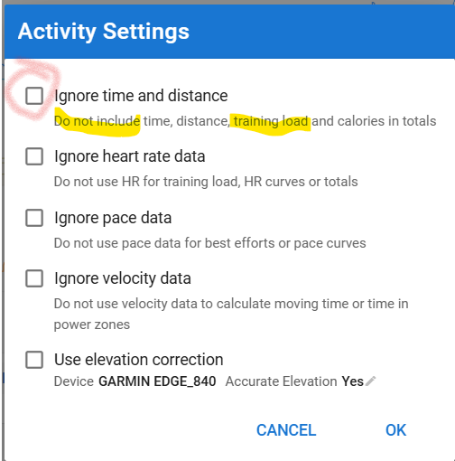

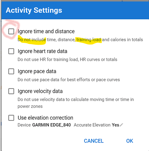

Found it … but it is weird …
The file had the activity settings:
Ignore time and distance
Ignore pace data
Ignore velocity data
turned on … as soon as I turned them off the load showed up as expected LOAD 12.
To me this makes not much sense as the Load was calcualted correctly beforehand to 12 … but not used … It was shown as
LOAD 0 (12)
The ‘Ignore time and distance’ flag is causing this!
You can leave Ignore Pace and Velocity to avoid problems with duration based on Moving time, but not Ignore time and distance. That excludes training load from those activities.
The one who can read is the one who knows more …
Thank you for your patience - it was my mistake
