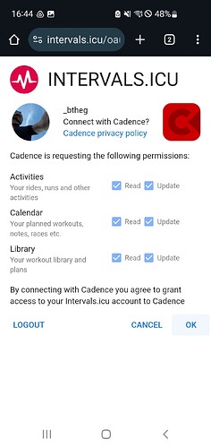

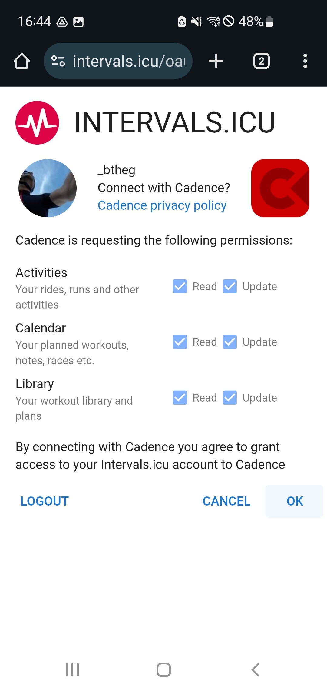

when i try to connect to the Cadence app from my Samsung Galaxy S10E, i get stuck on the connection dialogue in Google Chrome.
I can do what i want, nothing is working except the logout button!

The thing is, when i click OK, nothing happens, when i click on CANCEL, also nothing happens.
No dialogs, no questions, nothing.
I already deleted Website data and permissions and retried, still no success.

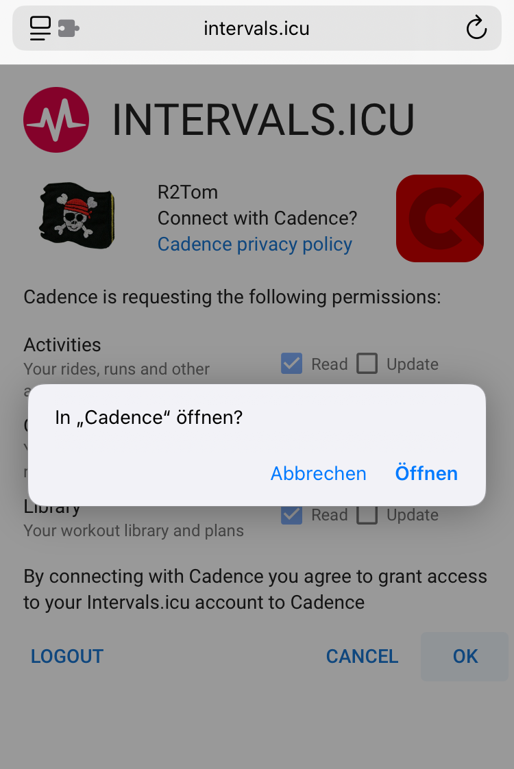

Just tried it on iOS and it works.
Don’t know if you can disable popups on android, and that’s the case for you. On iOS there is a popup to open it in cadence app

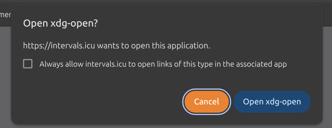

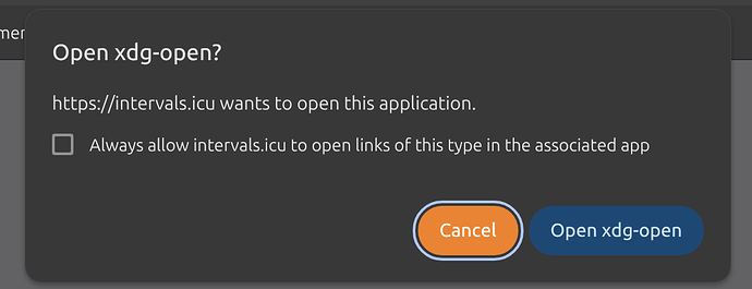

however, if i open the page on my linux desktop using chrome, i get this:
so yes, in general the mechanism seems to work, but not for me on my two android phones with versions 12 and 16 and chrome/firefox/edge
I figured it was on the browser side of things, but if cadence:// should open Cadence, maybe it’s on my end? I’m not super knowledgable about Oauth, sounds like I need to do some investigating.
As you see, it wants to open the cadence app. The url scheme is defined by the app.
