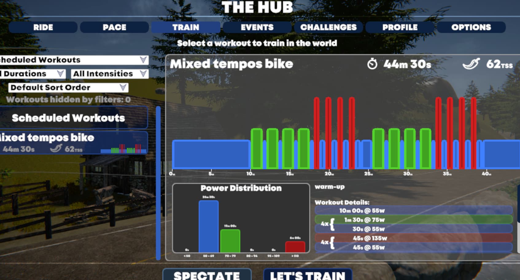

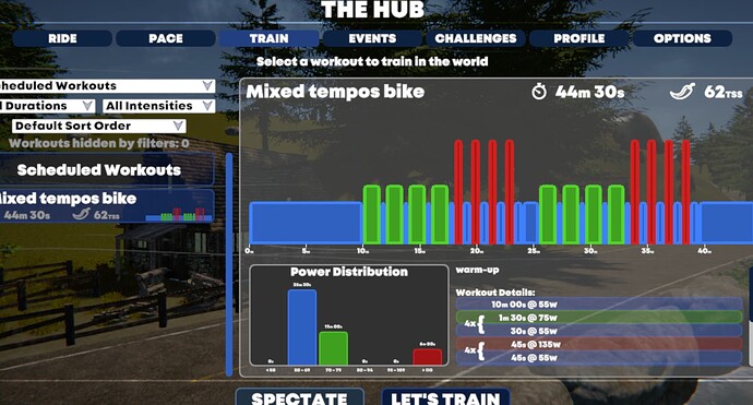

Does anyone know why the training plan changes in TP Virtual? (watts are not the same)

I thought about that and checked it, it’s the same… and the power values are absolute, not percentages, doesn’t make sense. Until last week it was fine, but it’s the second time it happened this week.

the activity was ride instead of virtual ride, maybe that was the cause. But still strange that absolute power values would be changed.

Problem solved, programing a ride instead of a virtual ride mess up the power values.
