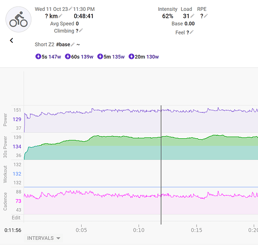

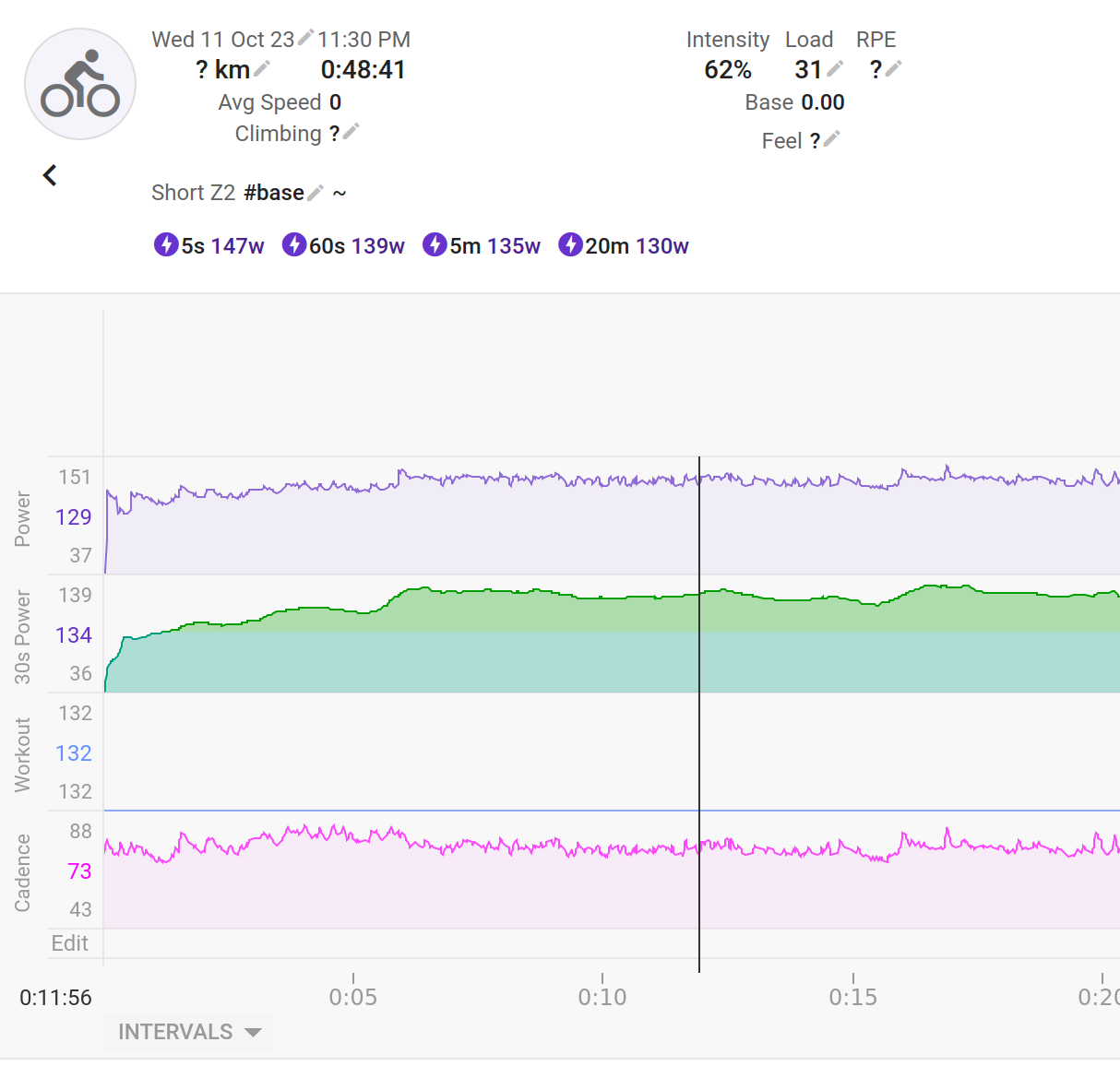

Other data is correctly processed:

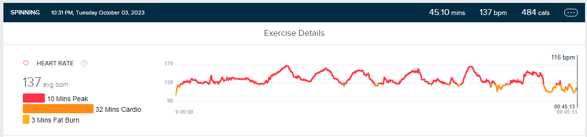

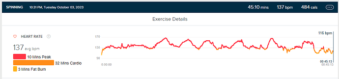

hmmm, I wonder how I can use this, I have a fitbit and when I record a spinning session, all I record is HR but i cant get that data into intervals…any options i can try?
Ive tried exporting the tcx from fitbit, the json from google takeout, nothing imports into intervals
