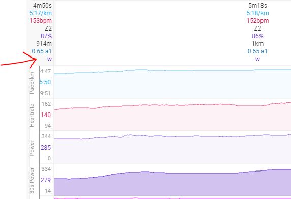

Hello,
my runs have running power and the data and values are there, but not shown in the average fields (see screeny).
Thank you very much.

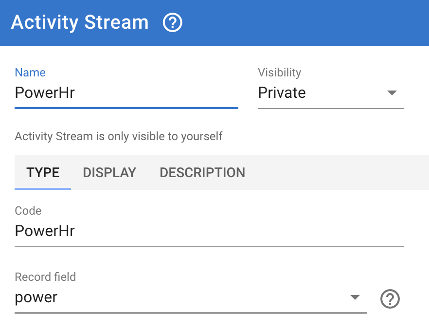

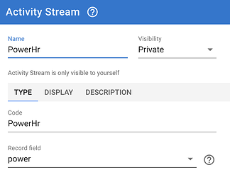

I have the same problem, I set up power zones and FTP but I still can’t see power values and chart. The only way for me to see some power-related data is to add the custom stream on the charts. Any advice?
It is because you have a custom activity stream using the “power” field. Currently if you do that the normal fit file processing doesn’t use that data (I need to fix that).

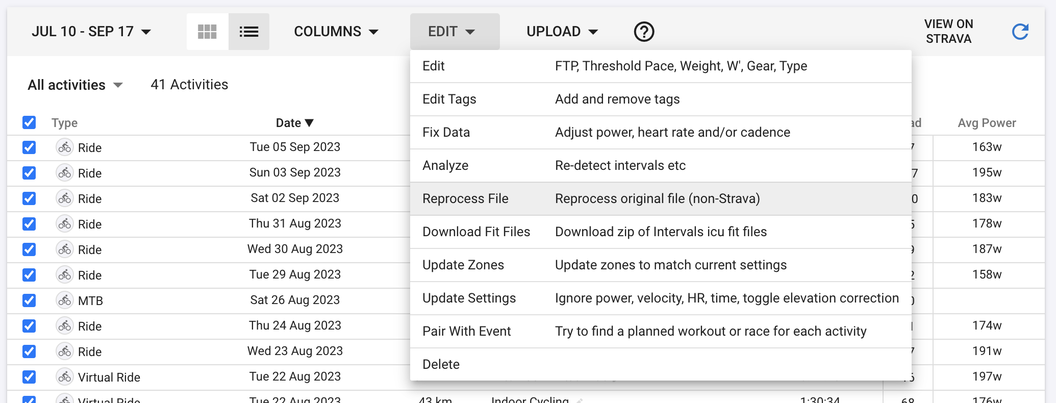

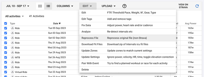

I deleted that stream and then did Actions → Reprocess File and now the power stuff is showing up.
You will need to re-process any activities that came in after you added that stream. You can do this from the activity list view. Use the column and filters to find the correct activities:
