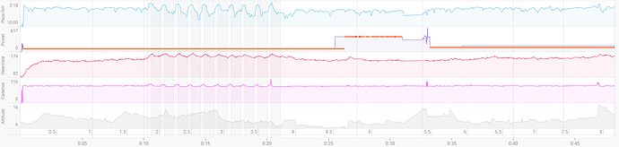

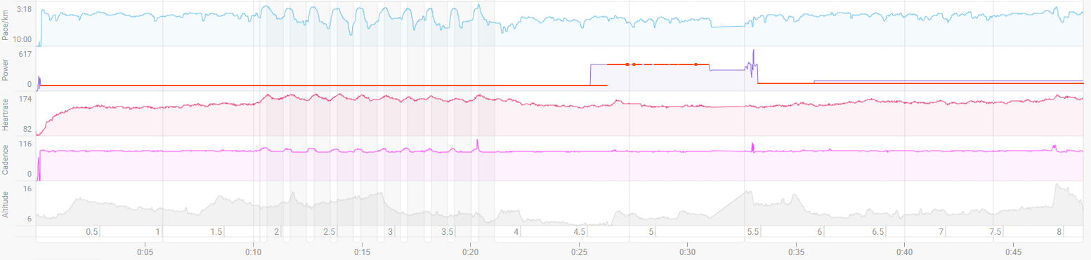

Hello, unfortunately, the power data from Connect doesn’t seem to sync with my Intervals account. Does anyone have a clue why? I’ve deauthorised Connect from Intervals and then reconnected it, but unfortunately, this didn’t help.

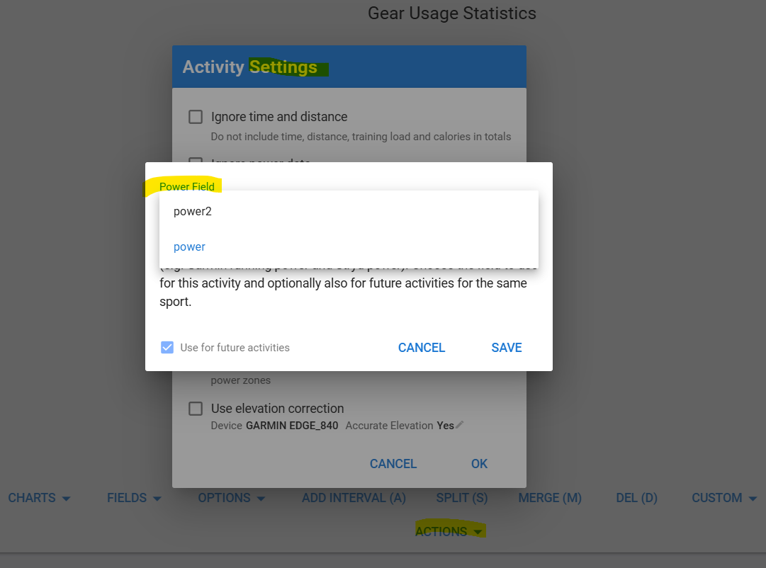

Is that power native from the watch or from Stryd?
If Stryd, it is in the Power2 stream and you can configure Intervals to look for it there.

Data on intervals:

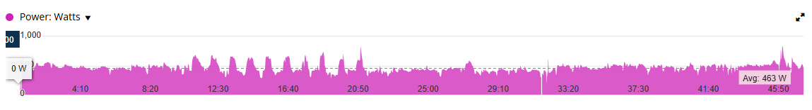

Garmin data:

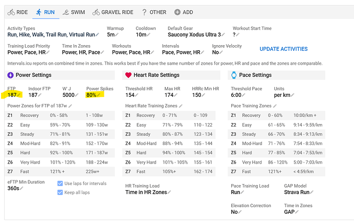

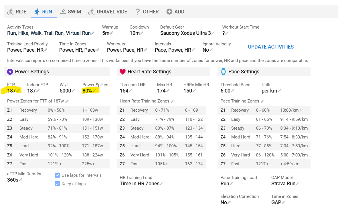

Power data is there but it is clipped because you haven’t set a correct FTP. Go to the Settings page - Run tab and set your FTP and zones. You may also want to increase the Power Spikes default value to avoid false spike detection.
Everything look fine now. Thank you for your help! I would appreciate if there are some guides for how to set up intervals profile for accurate data & reports…?
