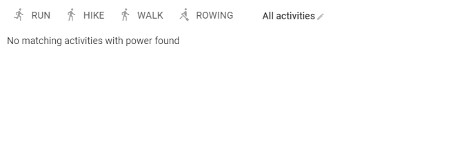

When I tap on “Power” on the left hand side I then see “Ride” and “Run” but when I tap on “Run” it tells me “No matching activities with power found” although I do have Running activities with Power using my Stryd footpod that show the power graph on each individual activity…

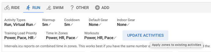

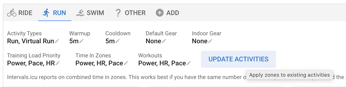

Did you do “Update Activities” after setting up power zones for run? That could be the problem. Intervals.icu only calculates the power curves etc if zones are setup.
That did it. Thanks David

Then, since January 8 I’ve been running with a Stryd. Today Stryd notified me of my updated Critical Power, so I thought it was time to get my training load calculated based on power in intervals.icu. So I eventually added a FTP in the run settings of intervals.icu, and updated activities as instructed in this thread.

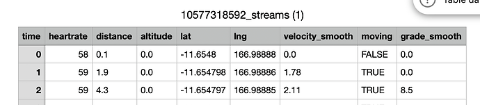

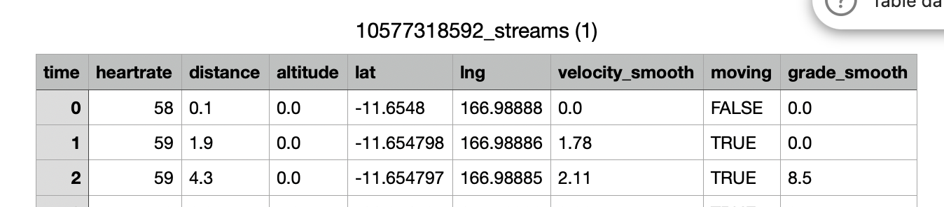

Look for the “Streams CSV” button at the bottom of this page for your Wed 17 Jan run.
There is no power data. Can you see power data on Strava? You need to try find out if Zwift is sending it through or not. You could also try getting your Zwift files into Intervals.icu directly using Dropbox.
Thanks. Youre right strava dos not show power. It justed to so the problem is else where. I’ll dive in and look.
still nothing :frowning:
only my rowing power data is showing, nothing else. so Id suggest its a stryd problem?
