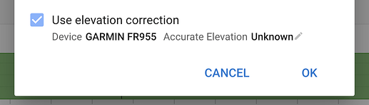

Hi @david , I stumbled upon this thread while investigating a similar issue.
I changed watch on September 1 (FR935 → FR955), and noticed today that the climbing metric on my latest runs is through the roof! I looked at my settings and my elevation correction is set to auto (on purpose).
See my October 4 run for example.
I see 2 potential issues :
  • FR955 not being flagged as a reliable device (which it should be). Can you confirm, and confirm when there will be a fix please?
  • The digital elevation model used for the corrections being flawed. I tried simulating Strava elevation fix and I am getting very similar elevation to my watch barometer, hence pointing to the DEM used by intervals.icu being off. Of course it would not matter in my case when the reliability indicator is fixed, but it could break other people’s metrics!
Thanks and let me know if I can help with the resolution in any way.
Laurent

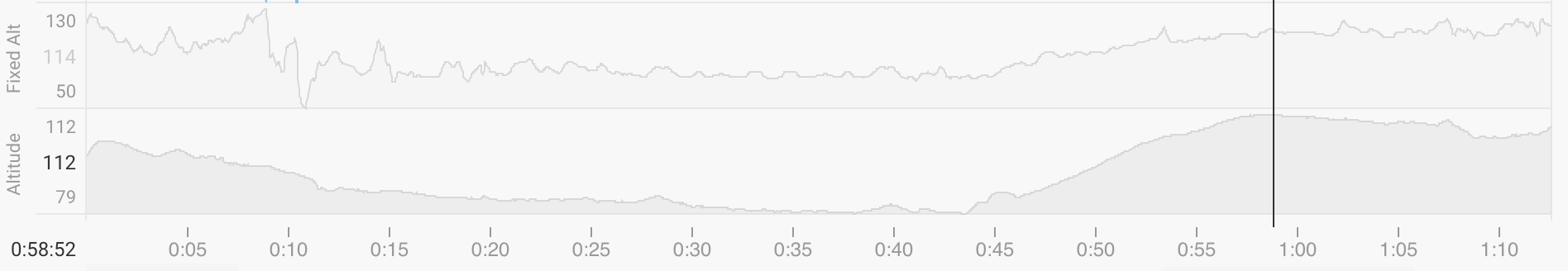

I set your FR955 to be reliable by clicking “Unknown” and changing it to yes. I also unticked the “Use elevation correction box”. Future runs with that device will not use elevation correction. Climbing is now 49m.
This is what the “fixed altitude” trace looks like with elevation correction on:
I suspect that is due to GPS jitter.
