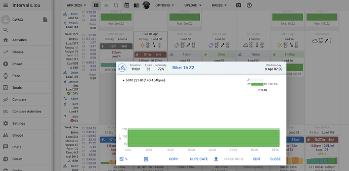

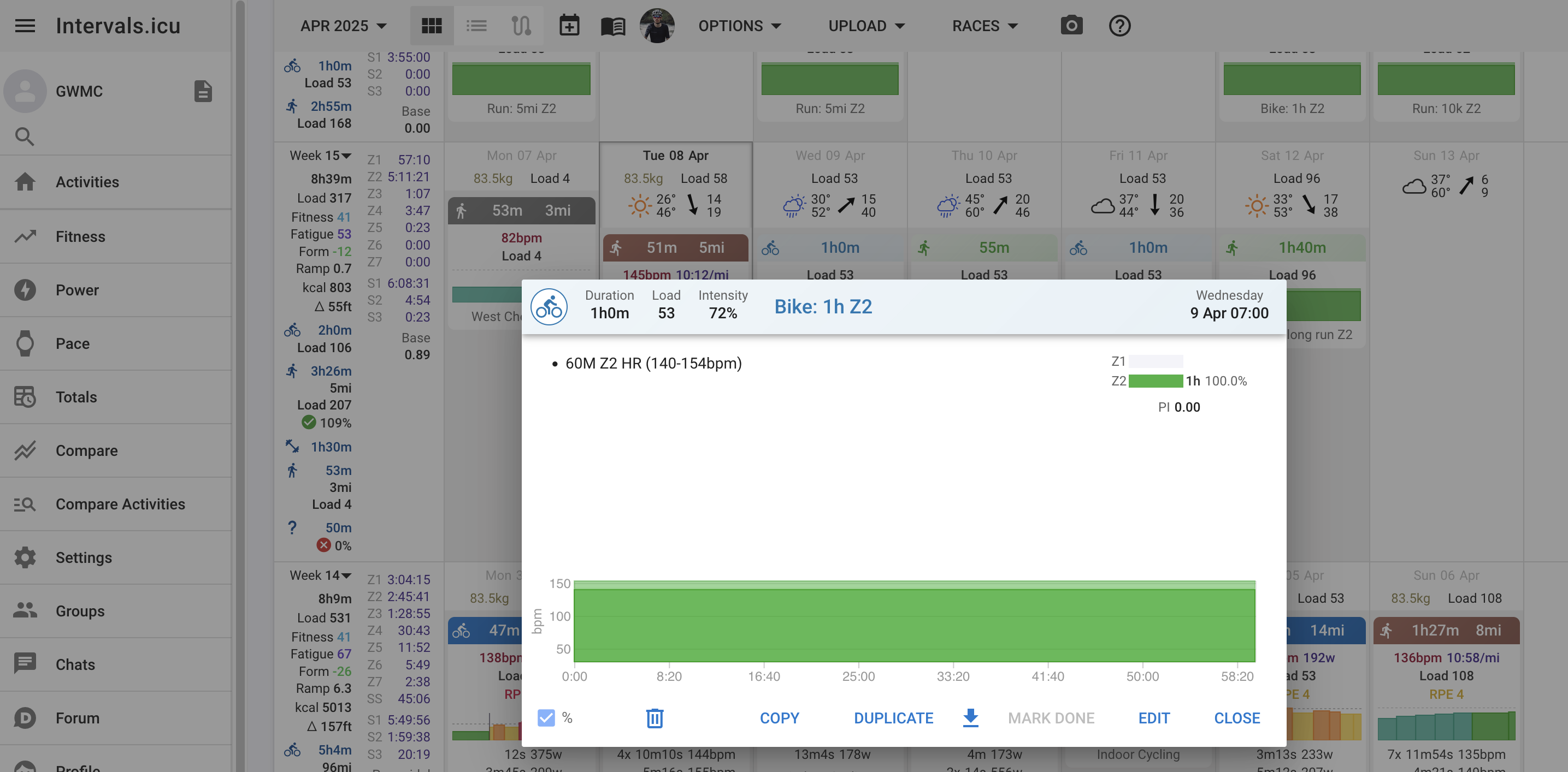

Planned workout in intervals:

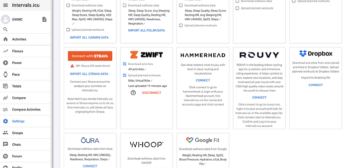

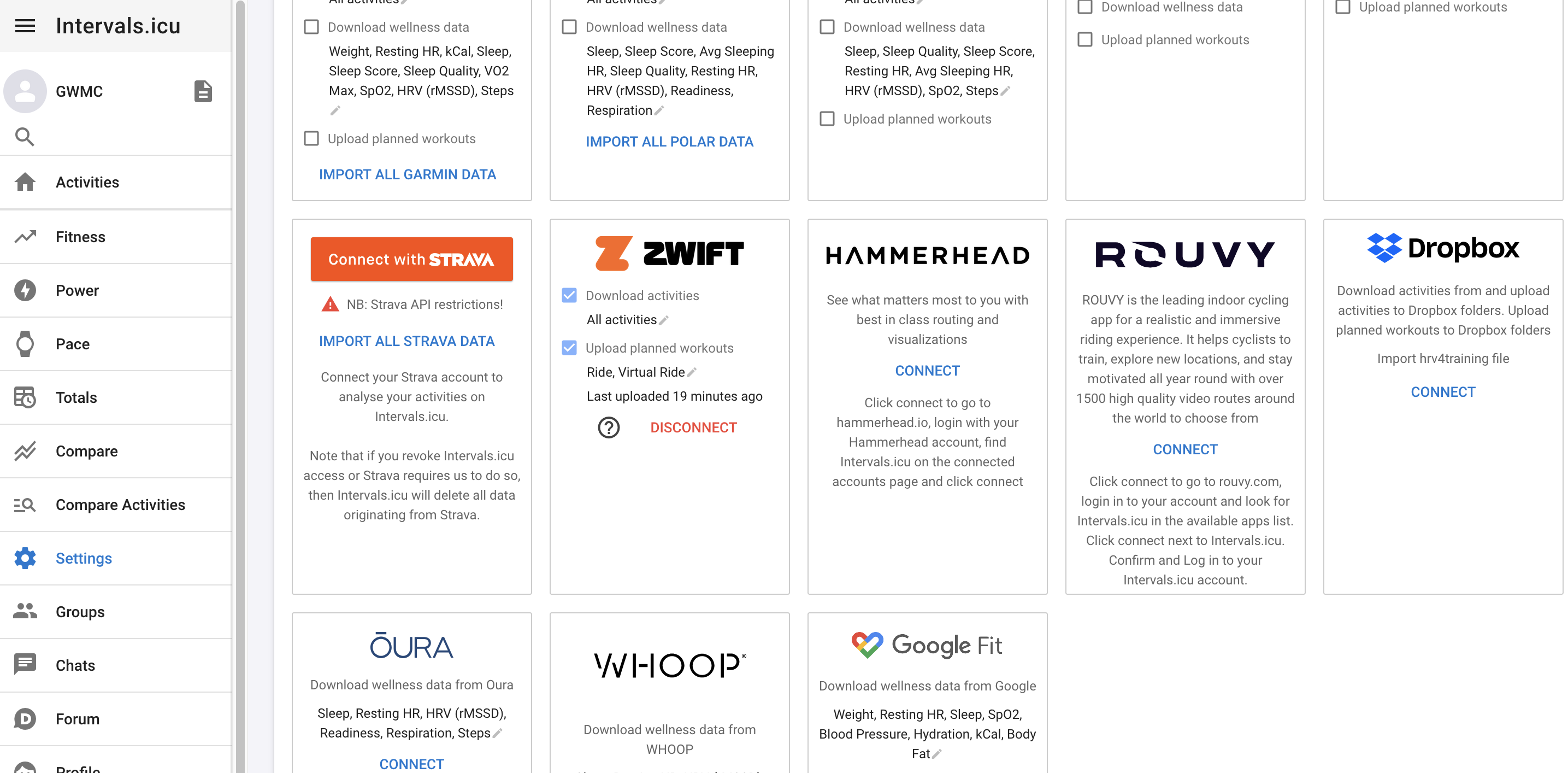

Zwift connected and synced:

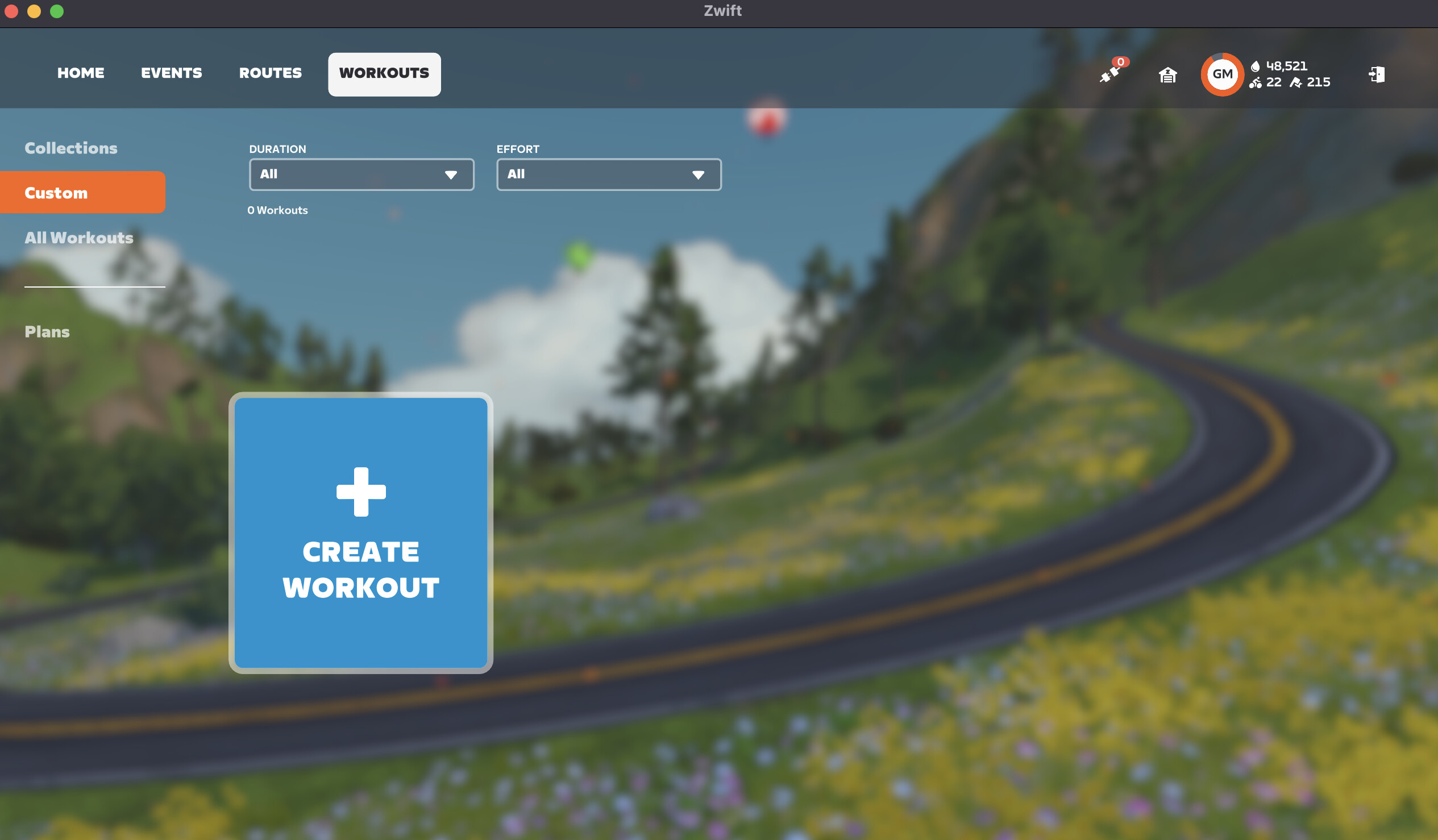

Workouts not showing up in Zwift
I figured out the problem is that I was trying to define the workout in terms of heart rate zones and not percent of FTP. The workout successfully synced after I updated to use FPT.
