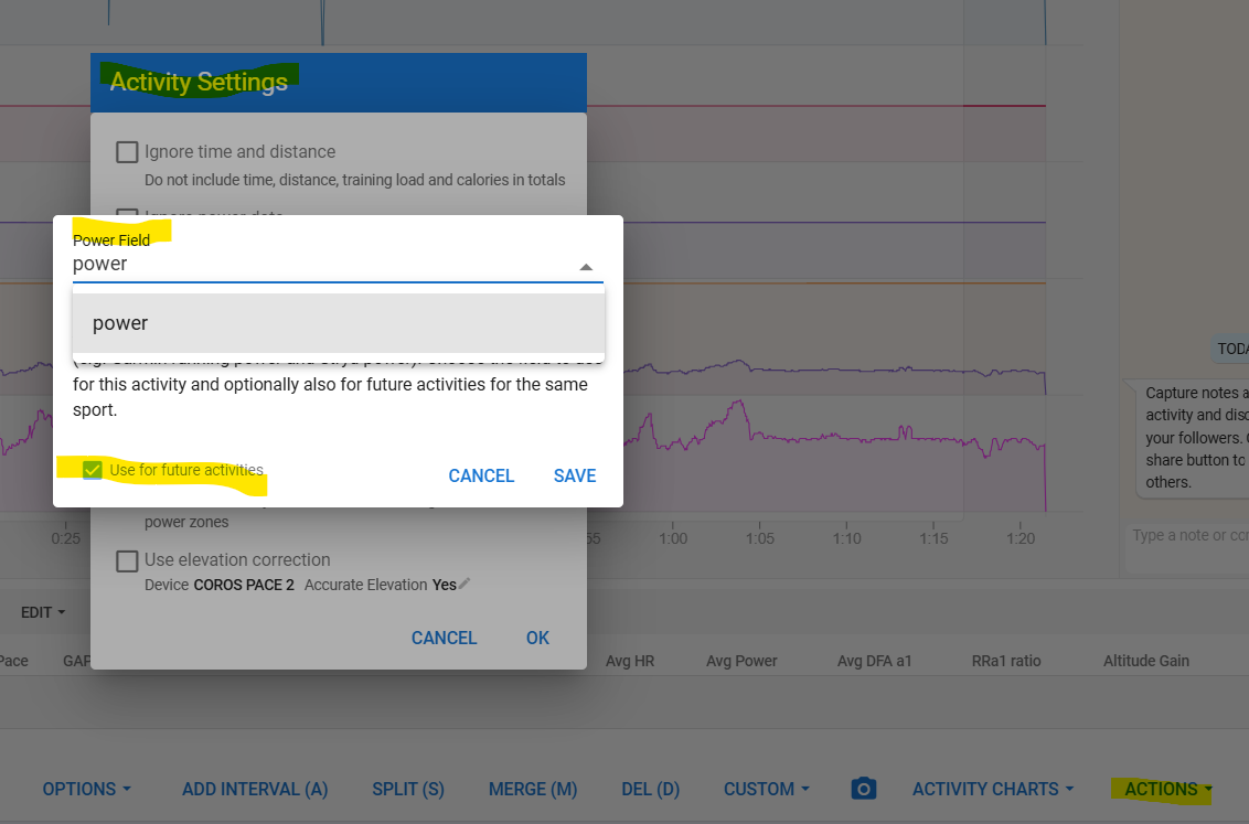

It’s probably in a ‘dev field’ and to make it visible in Intervals you have to instruct Intervals to read it at the correct place.
Go to Actions menu at the bottom of the activity timeline tab and choose Settings. Under Power, check if there’s another field with name different from the standard ‘power’ name, select it and check the box to use it by default for future activities in the same category.
Thanks for the suggestion!
I checked that setting under “Actions → Settings → Power”, but “power” was the only field available to choose from, and it was already selected.
