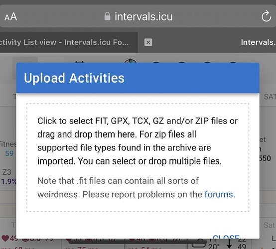

I do not know if I can undelete the file frorm Garmin Connect, but I could download the fit file of the correct activity and then do a manual upload in Intervals after clearing the current one.
How can I manually import an activity fit file?

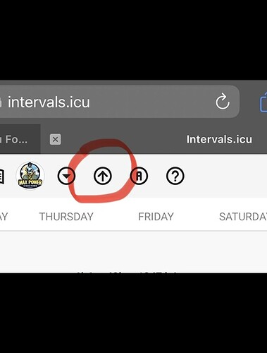

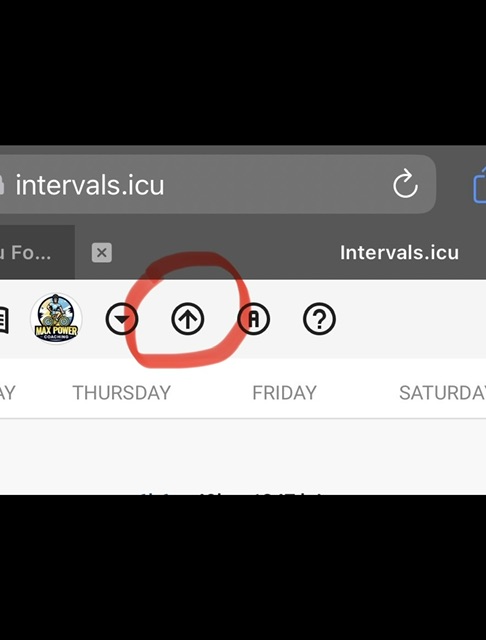

On the activity page, the arrow (up) opens the upload dialog box. Drag and drop your file here.
I deleted the activity in Intervals and upoladed the fit file from Connect manually. Now I have to lines in the list view, one with all the fields and one without. I guess the activity file got damaged when sent from the 1040 to connect.
