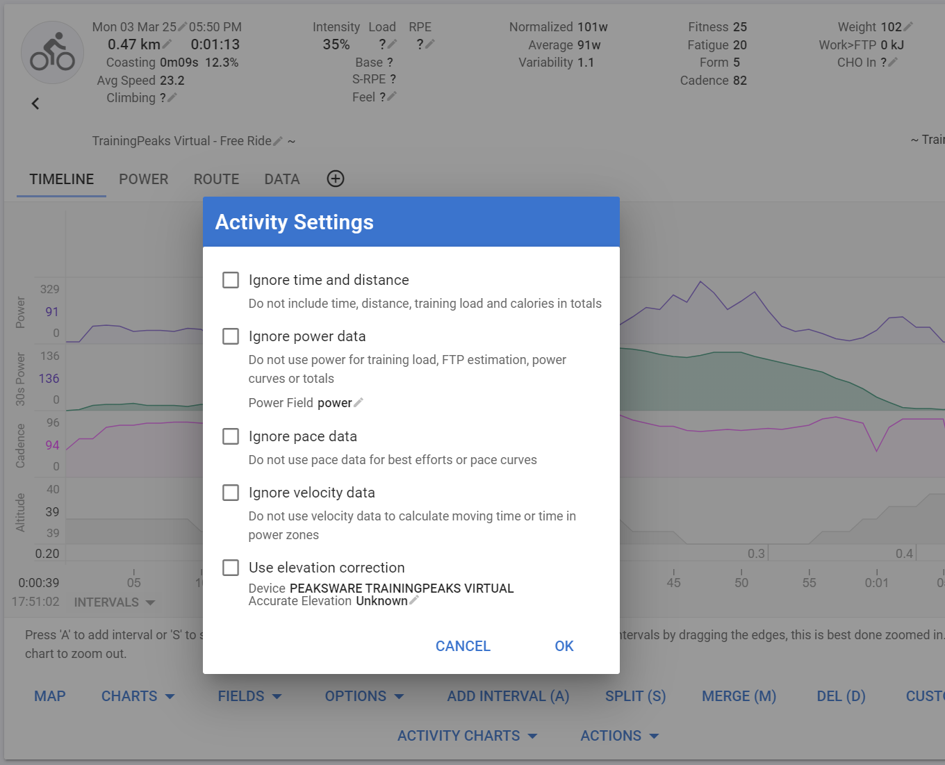

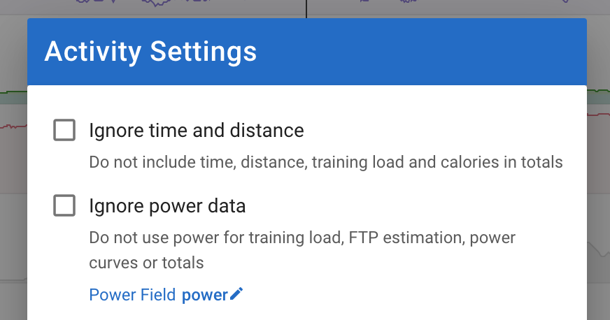

But I followed your instruction to select the default power and I assume you mean the “Power Field” for selecting the power data, right? Screenshot below. If so, any chance I could have both power data displayed at the same time?

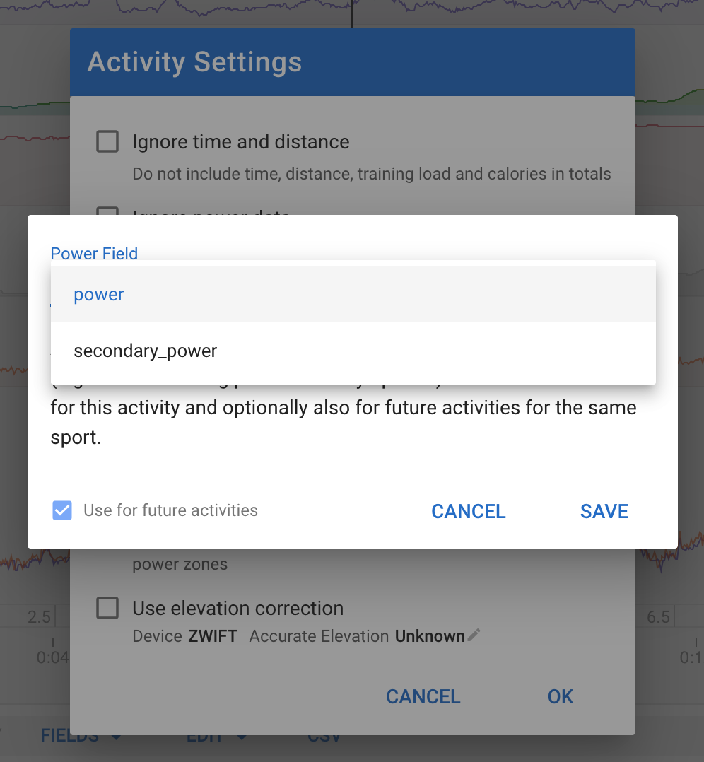

You’re alry there. See the pencil icon on the “Power Field Power” that will enable you to select the DEFAULT power data you want.
In any case. Secondary power is supported. In fact, any custom fields is supported by intervals. (You just have to create the code to recognize the field if it’s not alry been done by others).
