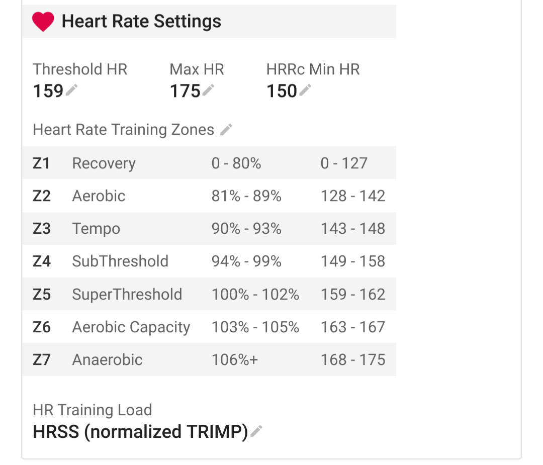

Here you can see my Min HRR setting:

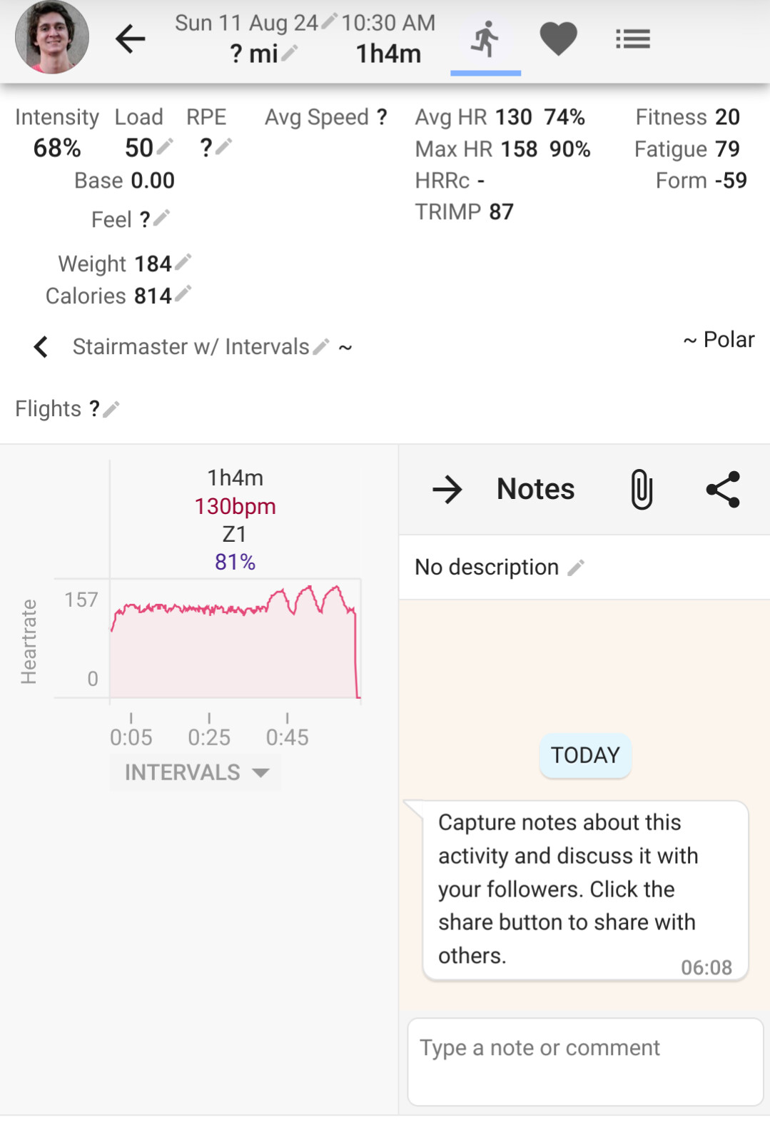

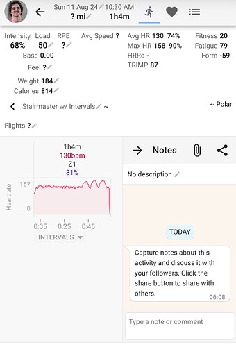

Here is an example of an activity where HRRc does not calculate, despite reaching a HR above this threshold (158 > 150):
This activity was uploaded after I had changed my Min HRR to 150 so, as I understand it, correct behavior would be for it to calculate HRRc automatically. I also tried your suggestion of Action > Re-analyze but this also fails to calculate HRRc.
The HRRc only works when you spend 1-min or longer above the set value (150bpm), edit: and allow the recovery to be at least one minute after the time above that threshold value (see @MedTechCD comment below).
Your average for the duration (1 hour, 4 minutes) is 130bpm. Zoom in on the duration of the intervals. Is it above 150bpm for longer than 1 minute?
Yes, I also think one of the duration targets was not met. Duration above the set value and/or duration of the drop.
The last one typically happens when you get over the finish line and stop your device recording immediately.

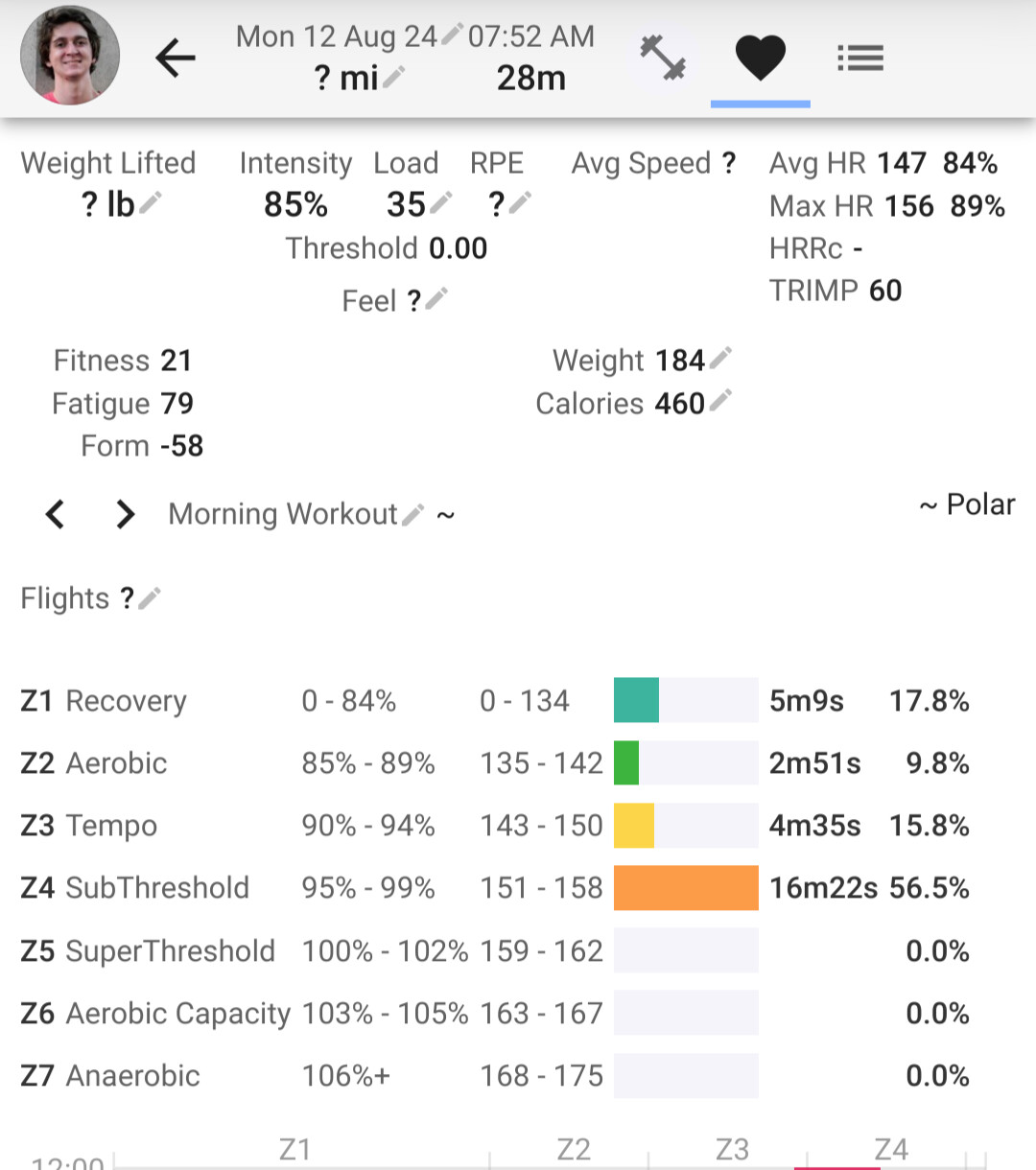

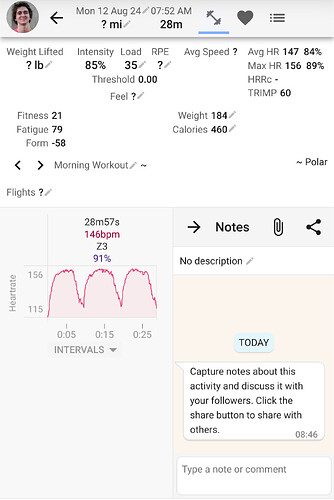

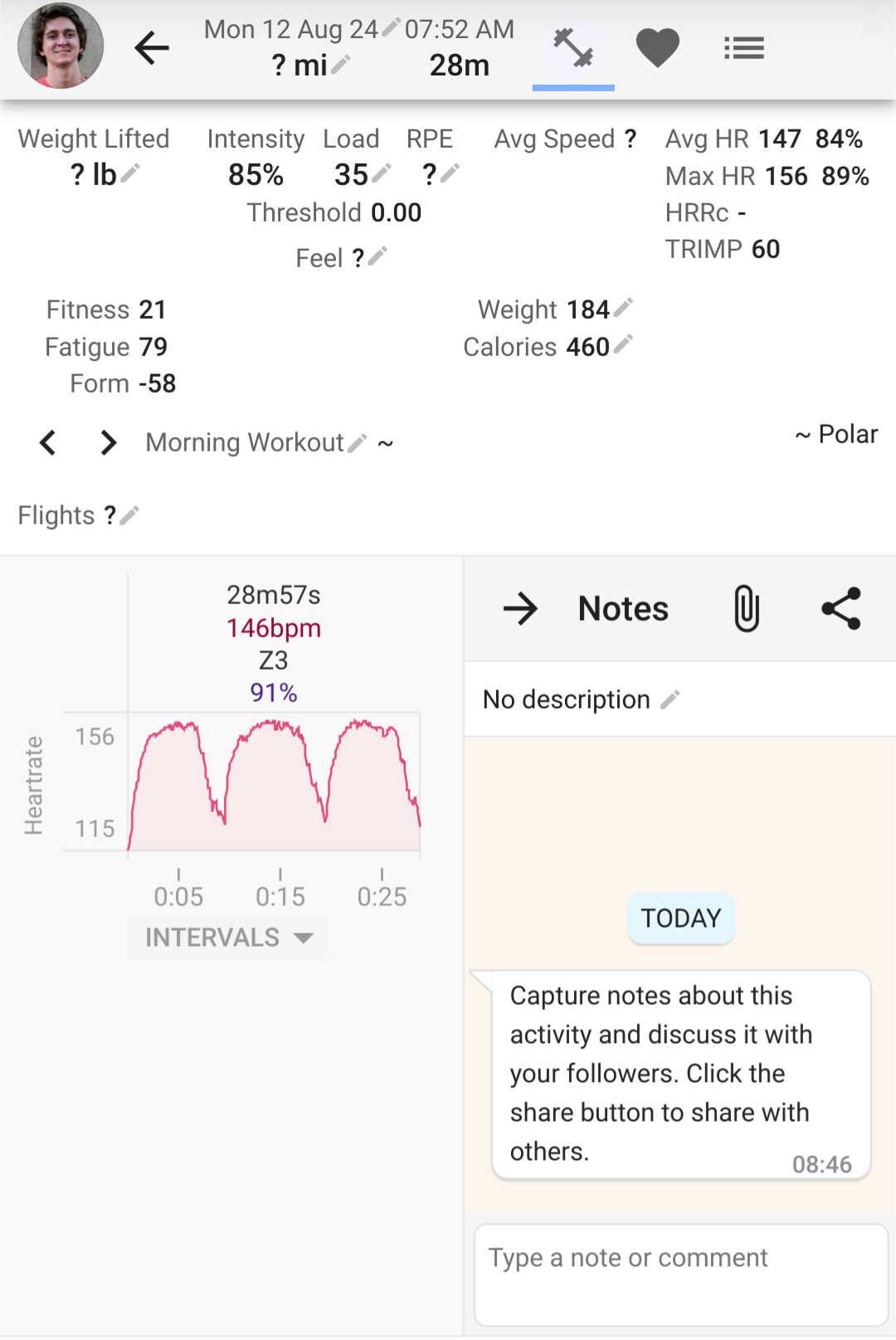

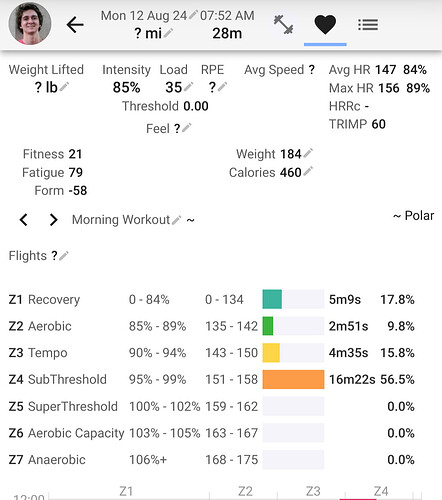

After receiving your messages, I have gone ahead and logged an activity designed explicitly to test your proposed model of how this feature should work. I raised my HR to 155 (above the min 150 HRRc I have input to Settings) and then maintained this steady state for 5 minutes (more than the 1m threshold.) I then tested for 3 minutes, repeating this for a total of three rounds.
As you can see, despite meeting these criteria, no HRRc is calculated:
From this view, you can confirm I maintained a HR over the 150 threshold for more than 16m:

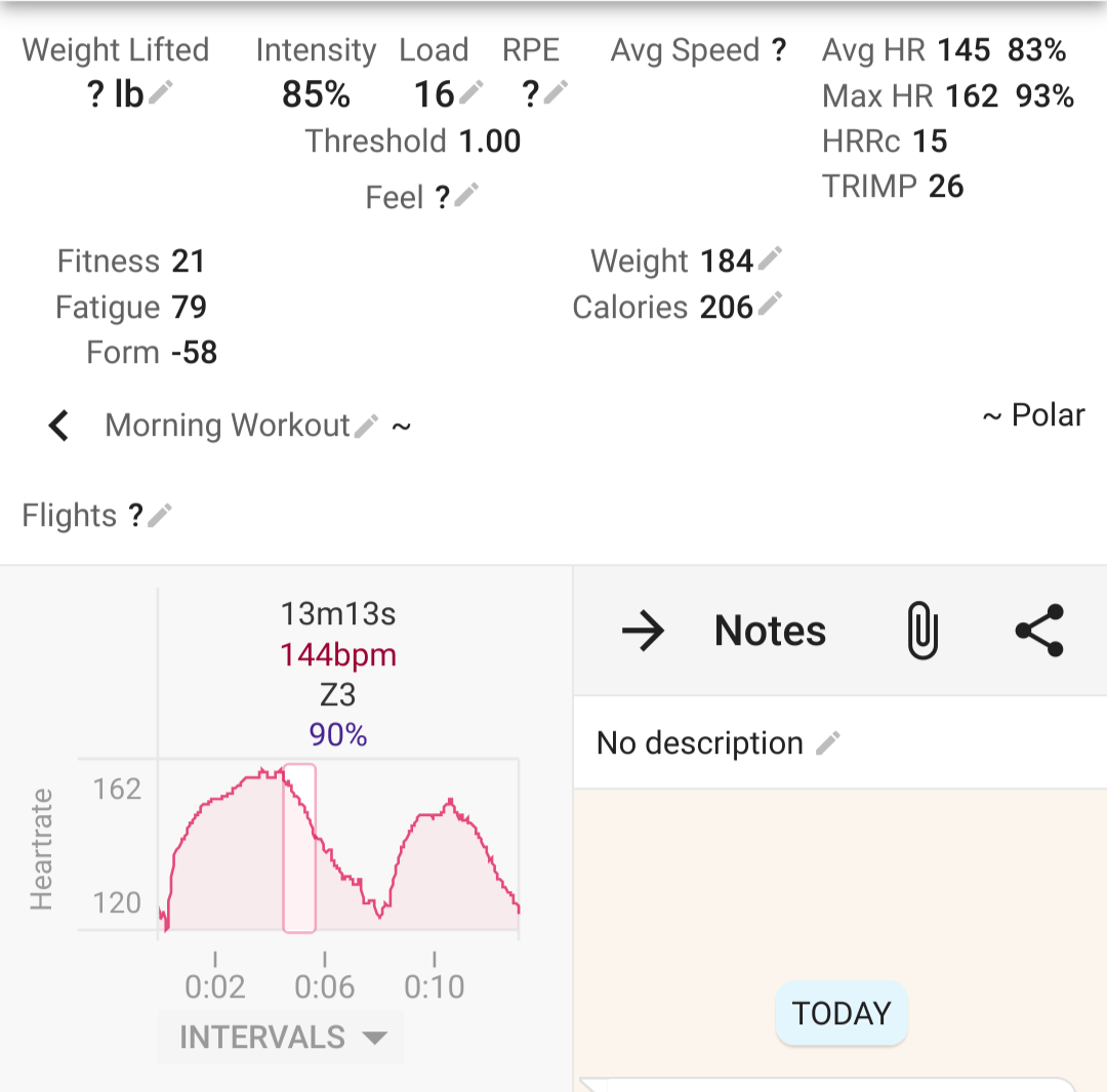

I then logged a second activity to test my assumption that the website is ignoring my manually set min HRRc value and continuing to use the default 159 HRRc. Here I raise HR to 159+ and hold it there for 98s. As you can see, for this round HRRc does compute:
Then @david should have a look because it used to behave correctly. Thanks for the test results!

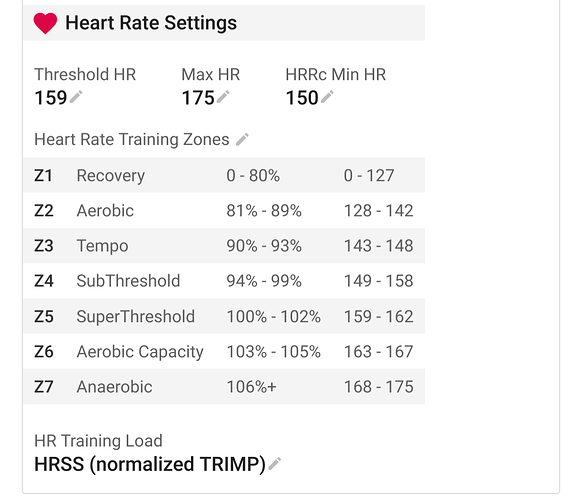

The settings for HRRc are per sport. So you need to edit it for “Other” in /settings (the sport that will be used for "Workout). “HRRc Min HR” is currently 159 for “Other” and 150 for “Ride”.
Ah, I see now, I have updated the “Other” tab min HRRc and Re-analyzed the workout and now it displays the expected behavior. Thanks!
