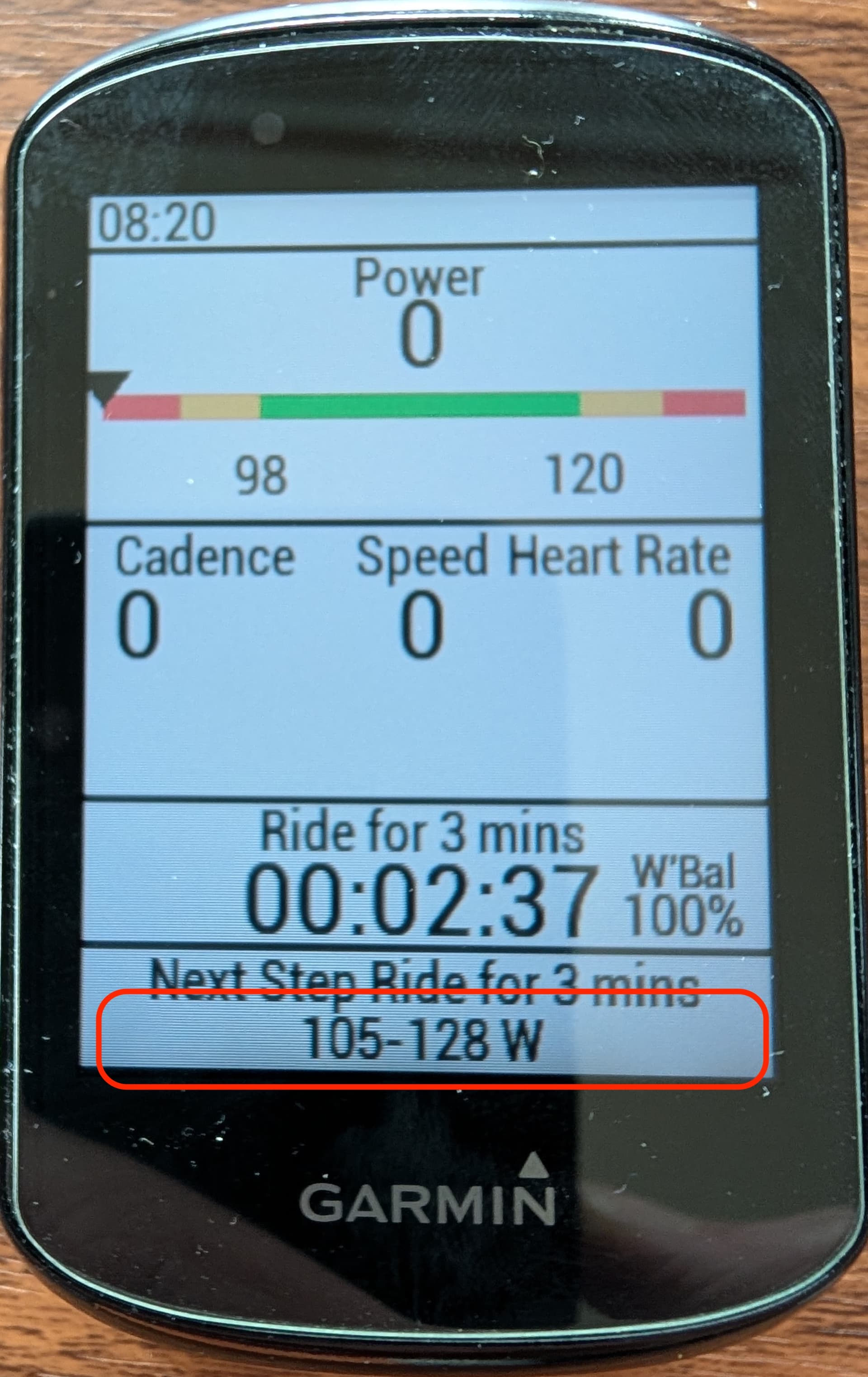

I have a related question and thought I’d tack it on here since you guys seem to understand the Garmin FIT format. I wrote a program for generating workouts for myself, and I use an Edge 830. I’d like to modify the “Next step” text to be the percentage of FTP rather than actual watts. I can’t find the right field in the FIT file where that text is derived from. Does anyone here know?
