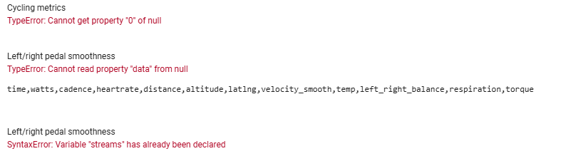

Cycling metrics
TypeError: Cannot get property "0" of null
Left/right pedal smoothness
TypeError: Cannot read property "data" from null
time,watts,cadence,heartrate,distance,altitude,latlng,velocity_smooth,temp,left_right_balance,respiration,torque
SyntaxError: Variable “streams” has already been declared

Basically the same :slight_smile: But the script output on the config page of the chart throws:
Script did not return a value object
The last error from your first post can be avoided by placing brackets around the entire script {…}
This keeps the variables within the script. Seems like the variable ‘streams’ is already used in another script that is running on your account. It’s basically always a good idea to put the entire script in brackets unless you deliberately want to use a variable over different scripts.

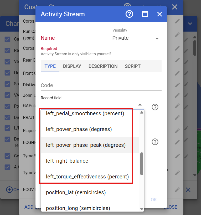

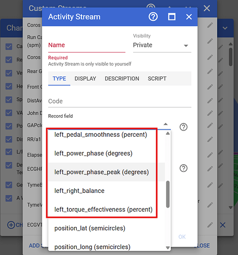

You can quickly check what’s passed on with the Charts - Custom Streams - add stream menu
The dropdown will have all available streams.
