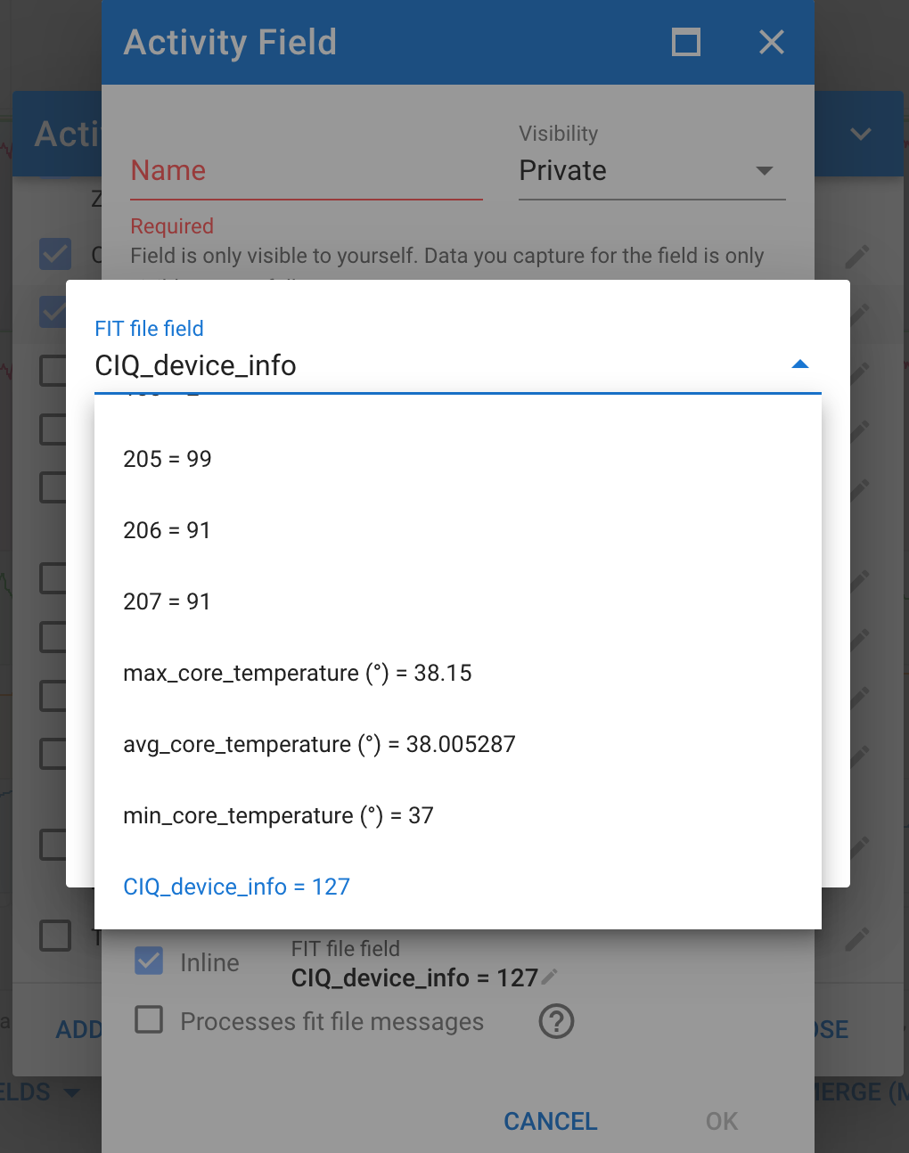

Now getting this to a custom activity field is my next problem, and a little beyond my knowledge.
Yeah. Same.
But I managed to take one of the custom fields and alter accordingly. Trial and error.

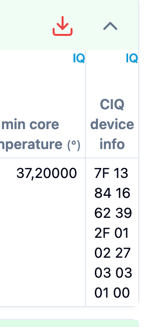

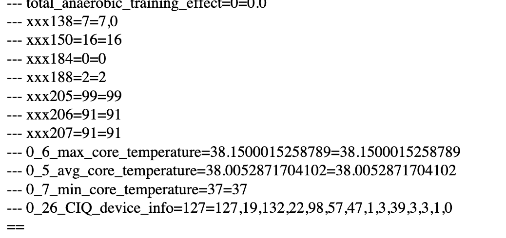

@david I can extract this info from the fit file, pictured below.
But it is not showing the complete string, as shown below:
How can I extract this string and then extract spot number 9 in the array?
I edited your “Core Battery Test” field. This is the script:
  let status
  for (let s of icu.fit.session) {
    let di = s.CIQ_device_info?.value
    if (di) {
      let v = di[8]
      if (v) status = ["New","Good","Ok","Low","Critical","RFU","Inv"][v - 1]
  status
