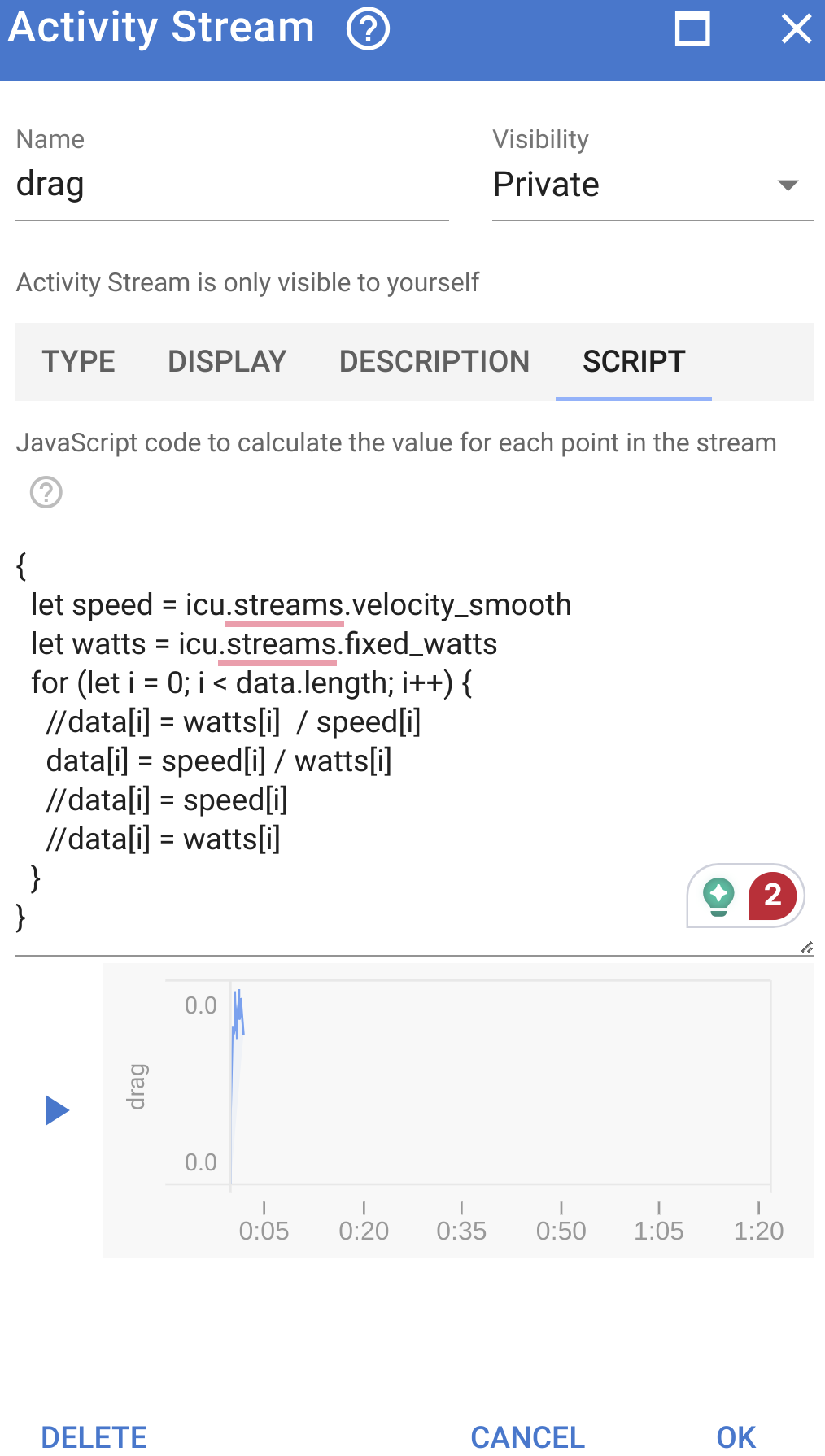

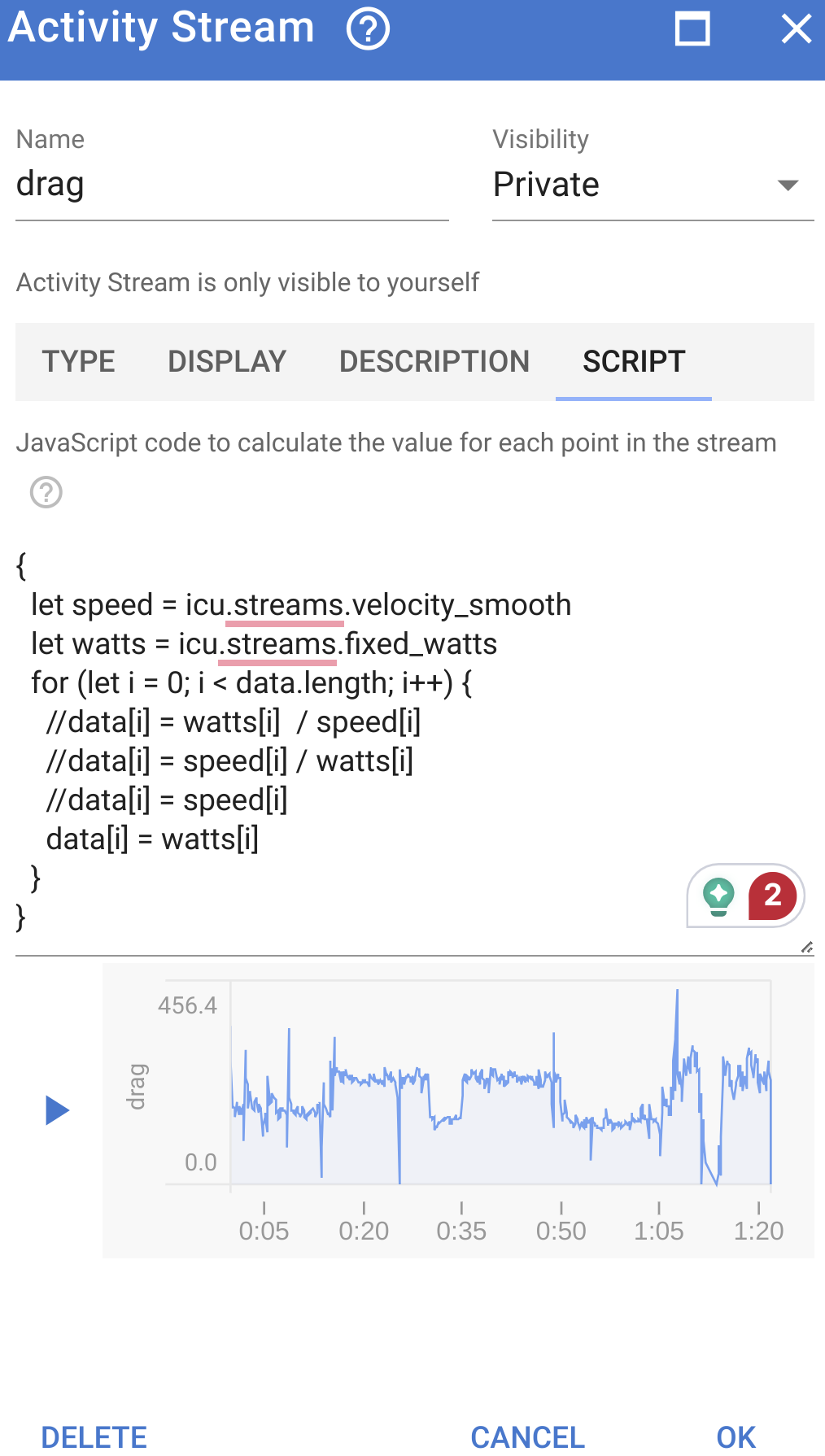

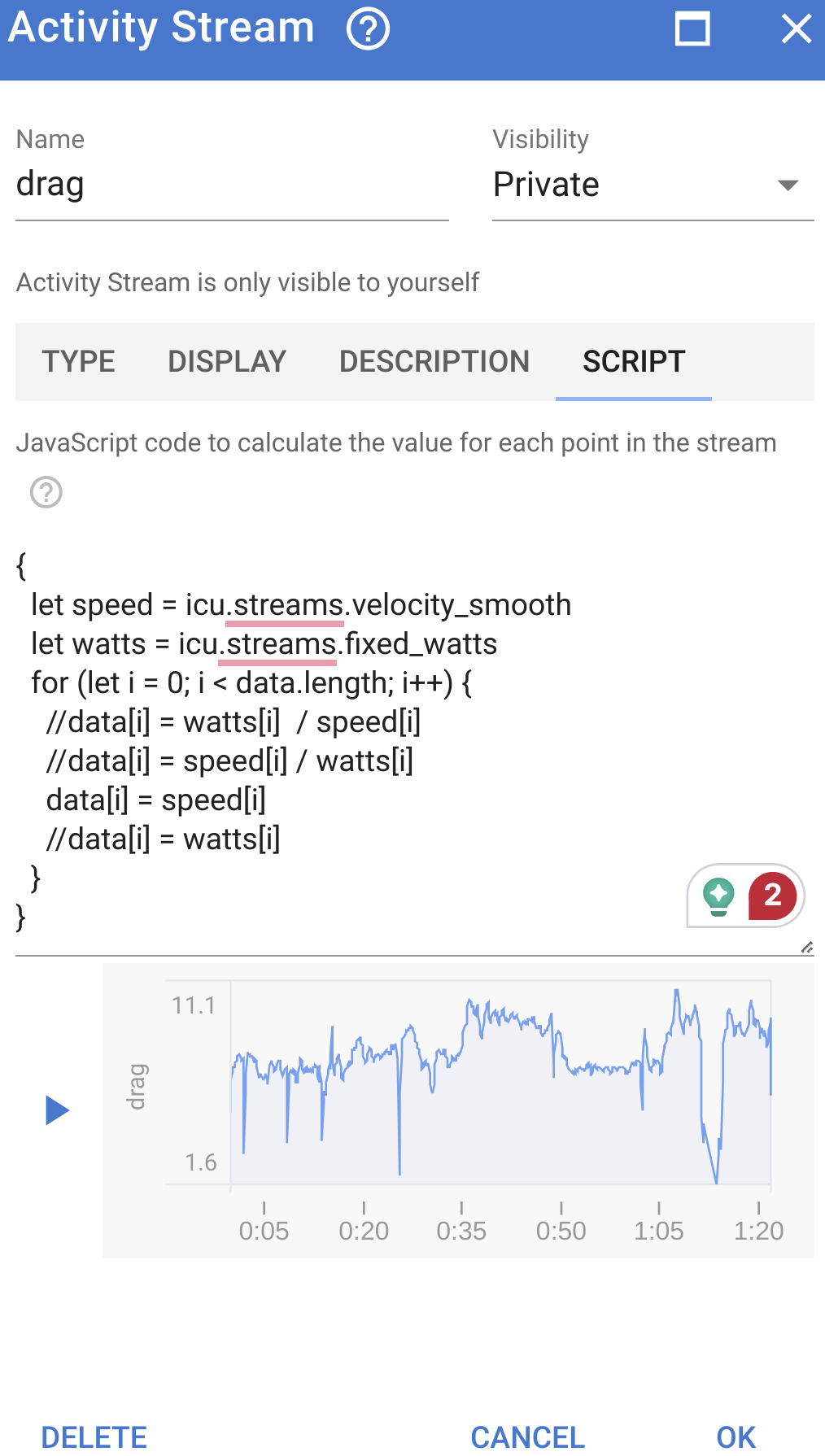

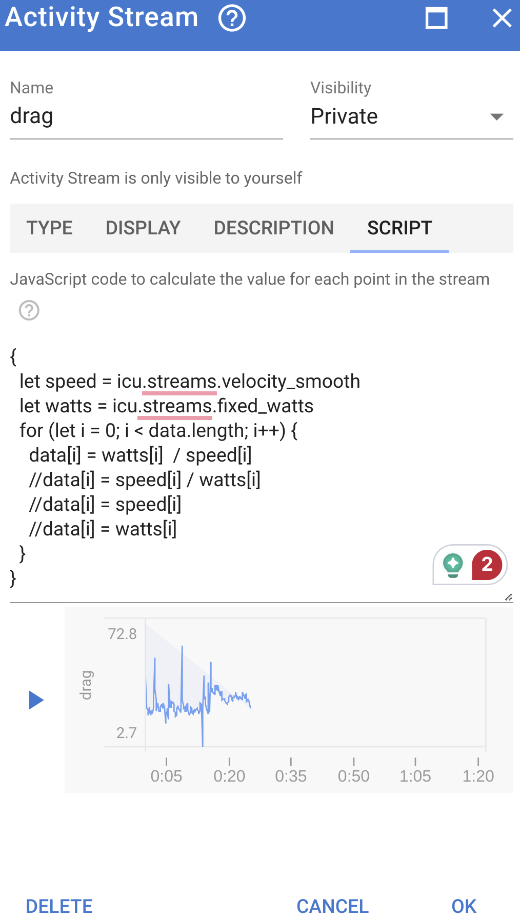

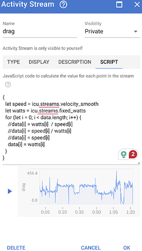

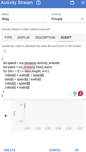

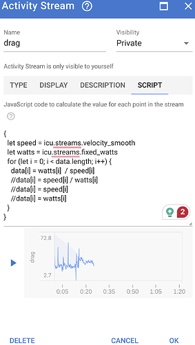

I’m trying to add a speed/watts stream. I found the fields I need, and independently I get a chart for the whole activity, but I only get a chart for the first few minutes when either is divided by the other.
code follows:
  let speed = icu.streams.velocity_smooth
  let watts = icu.streams.fixed_watts
  for (let i = 0; i < data.length; i++) {
    //data[i] = watts[i]  / speed[i]
    data[i] = speed[i] / watts[i]
    //data[i] = speed[i]
Division by zero perhaps?

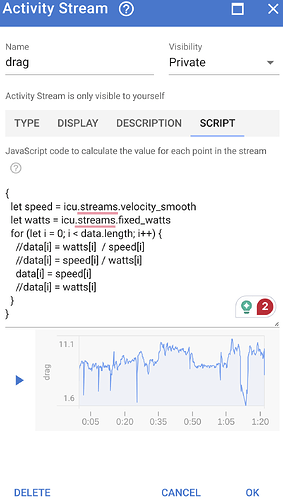

Thanks, but that seems unlikely given the attached charts.
perhaps just try filtering out zeros? even if it seems unlikely from the charts.

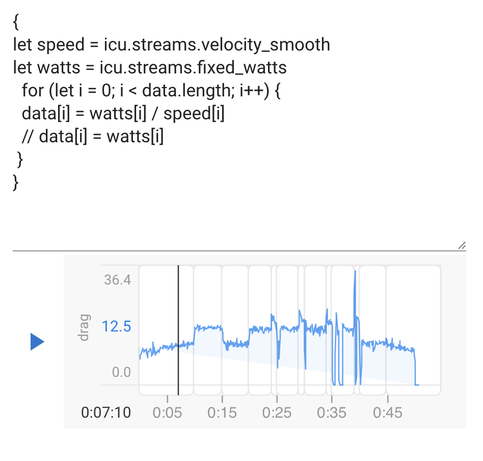

I just copied your text on one of my activities
It is very likely division by zero. Try:
data[i] = watts[i] ? speed[i] / watts[i] : 0
That sorted it out for my own test.
