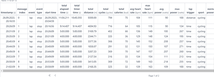

  2. if you open the fit file in fitfileviewer.com do you see power data?

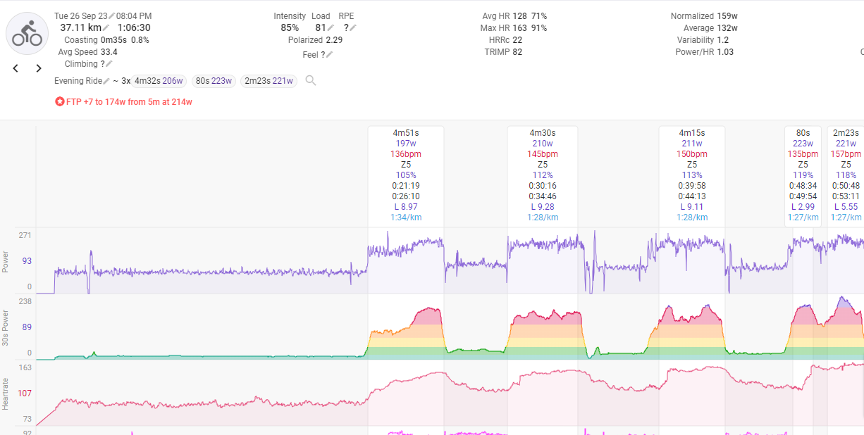

The bike power is from an Elite trainer. And in Garmin it is visible. And it was visible a month ago:

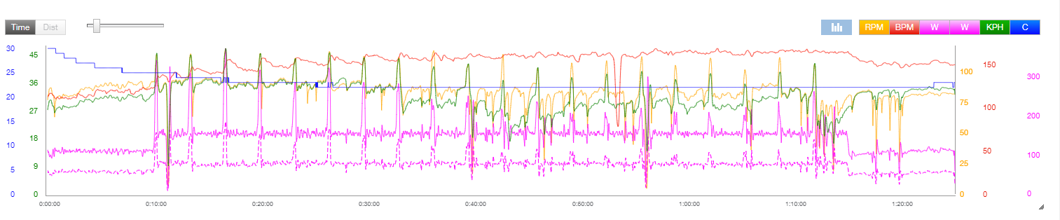

When I check it in the page you mentioned I can see it as below:

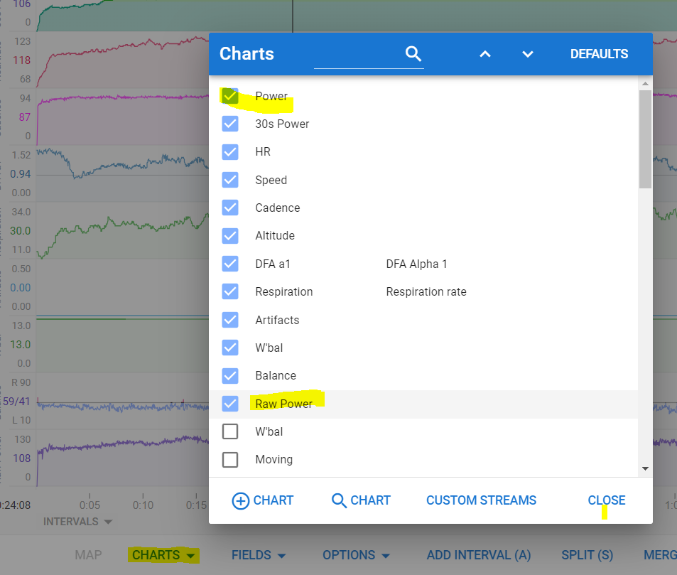

can you post a screenshot of the sync’ed file? like the one you posted. Try adding a field called “raw power” in intervals?

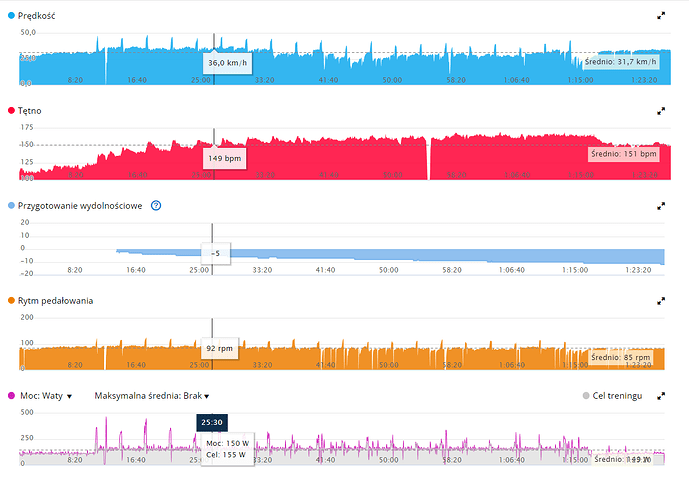

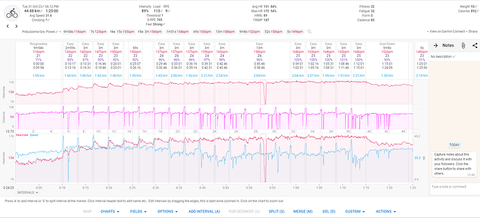

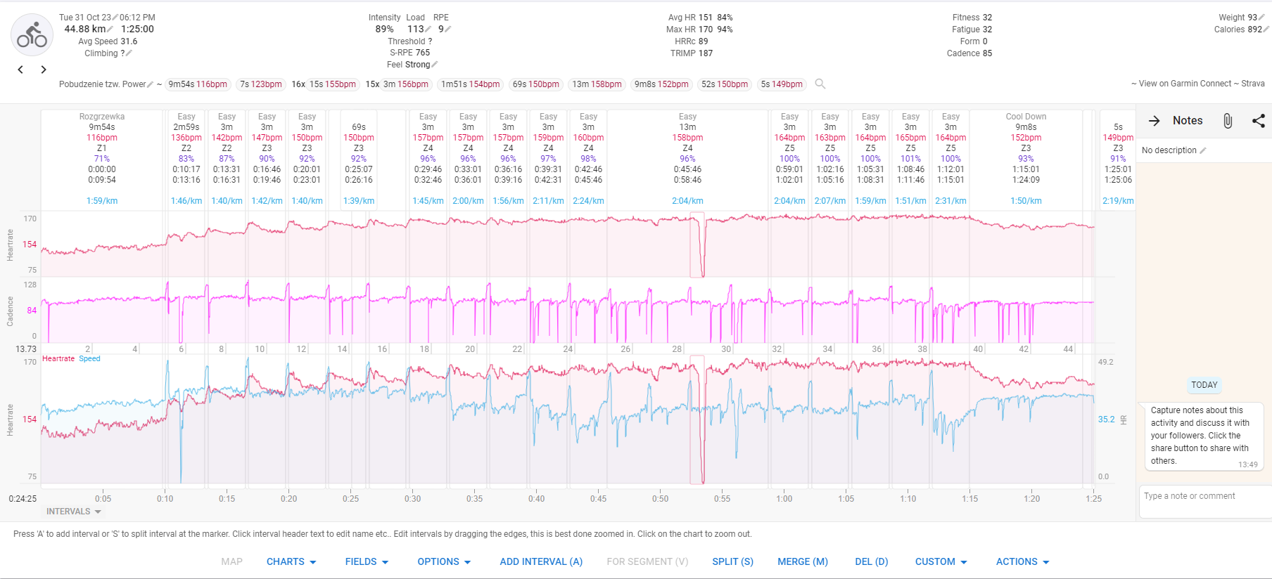

I have the activity synced through Garmin and strava (both have power) TP also gets it. However in Invervals I have only:
Screenshot from TP
and Garmin. It is in Polish
The crazy thing is that it was working OK and it stopped. The first training (with a trainer) without Power was on 30 Sept. I do not have power meter in my bike my free ride was always without bike power.

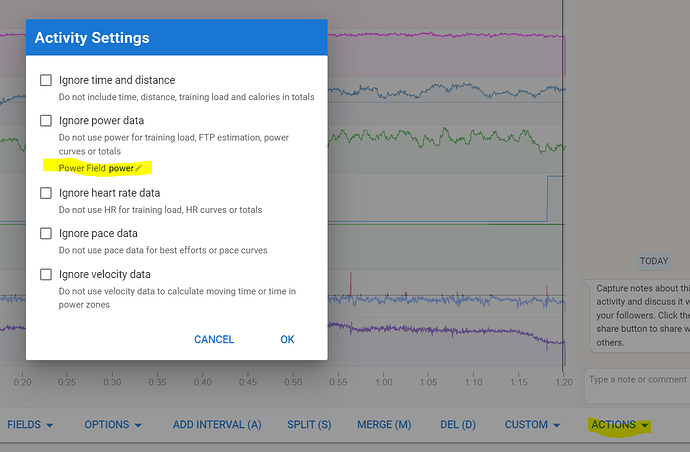

Then check if te default power field hasn’t been changed erratically:
Bottom of activity page - Actions - Settings - Ignore Power section. Check if more then one field is available and if the correct one is selected.

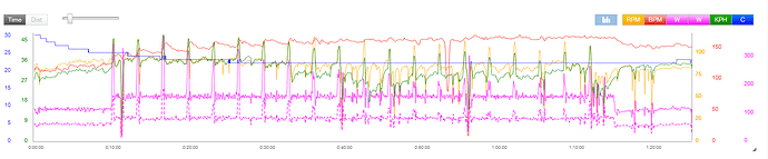

Intervals is not so good at handling Power that comes in at irregular intervals. Something that can be caused by your Garmin default setting ‘Smart recording’. In the screenshot from FitFileViewer, I can see timestamps that are far apart and I don’t see a column Power, only Avg and Max power.

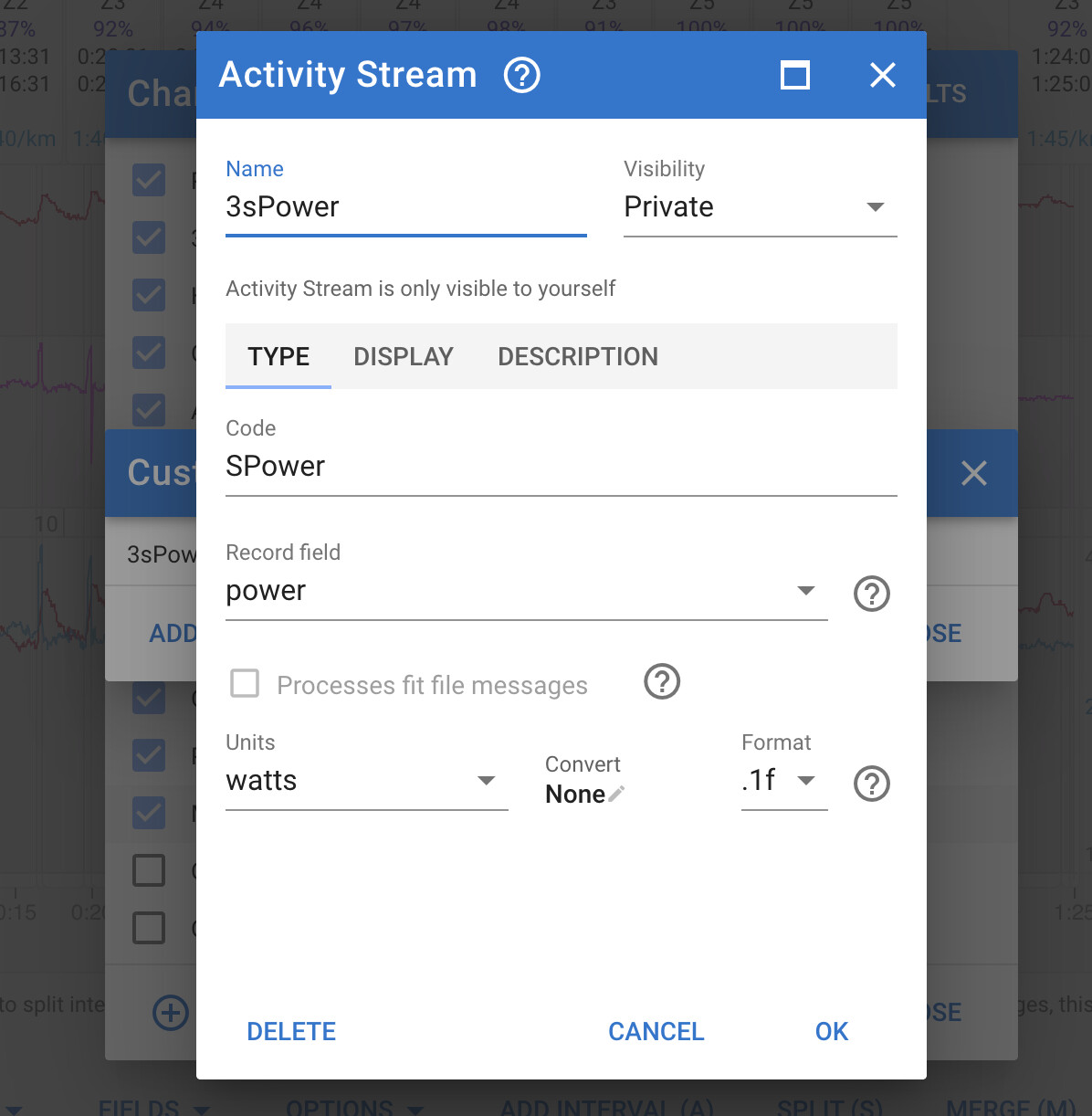

The problem is this custom activity stream:

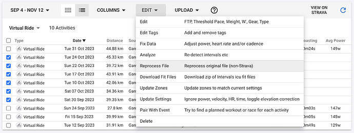

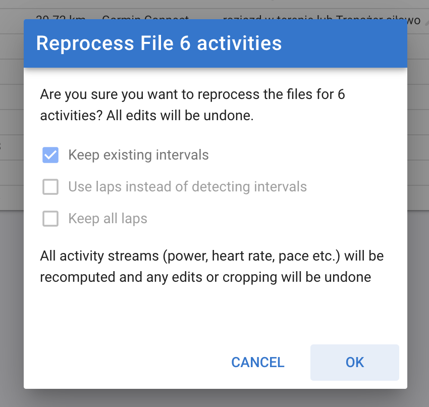

It is using the"power" record field which makes it unavailable for processing by other fields. I am going to fix this on the weekend. But for now I have deleted the custom stream and done Actions → Reprocess File to fix your activity.

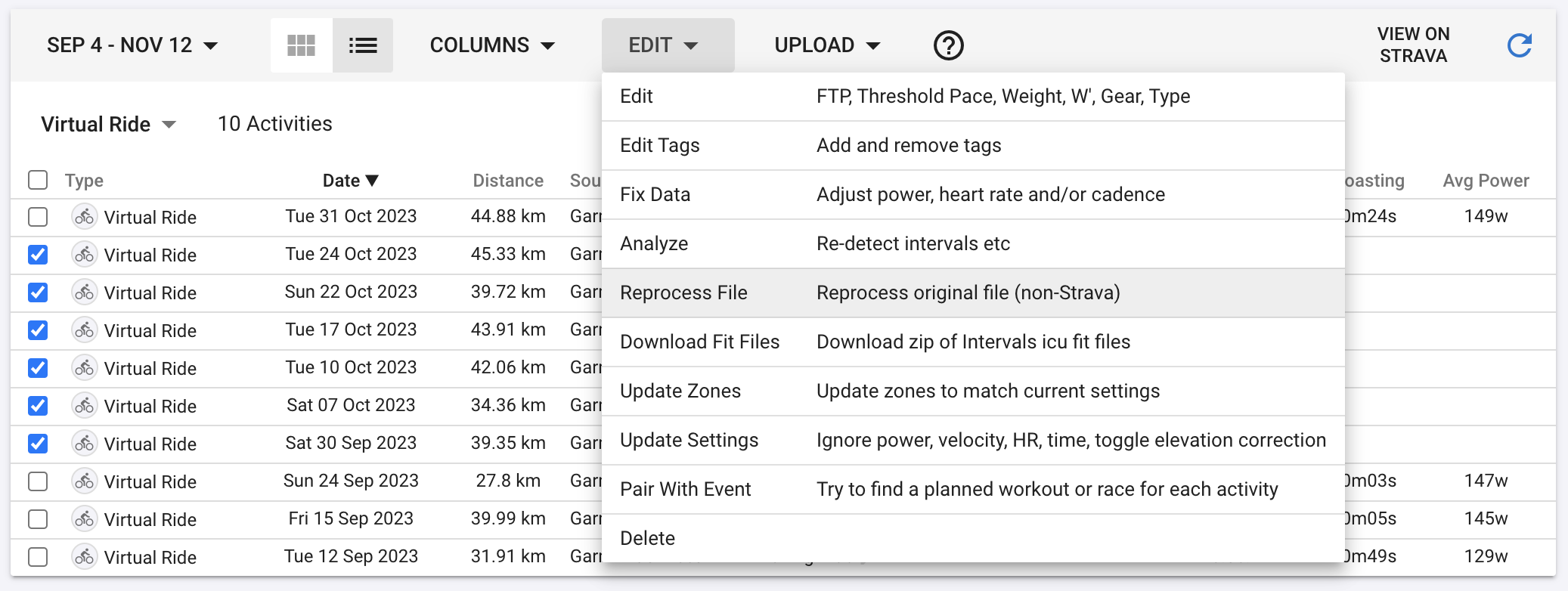

I fixed the others using the activity list view:

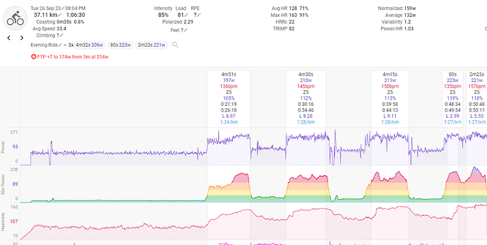

I had a look at your run on the 10th of Feb and it seems to have power data?
It was an issue for bike, but deleted the custom stream what used the power and reprocessed all training. Now ok. Thx
