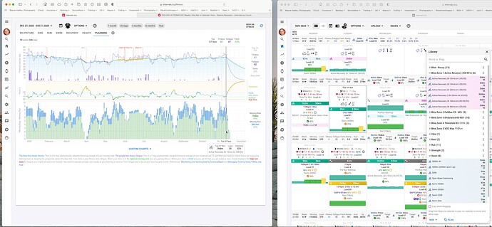

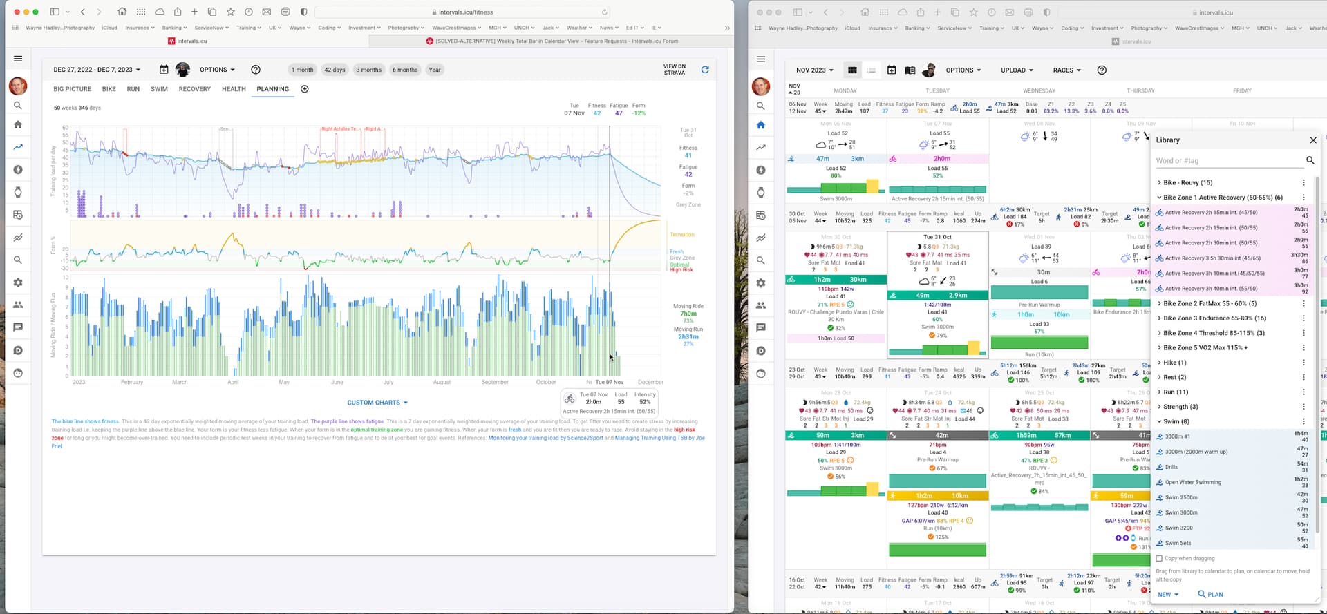

Thanks David. Definitely understand the complexity concern. Sharing how I approached the workaround in case others may find it helpful. I created a new /fitness tab, labeled it Planning, added the Fitness Chart and Form Chart, also added a custom chart that shows 7 day Moving Totals. I open 2 windows, one showing the new Planning Tab and another the Calendar, as I add workouts to the calendar, I can see the impact on the Moving 7d Totals in real time on the new Planning Tab
, see screenshot attached.
