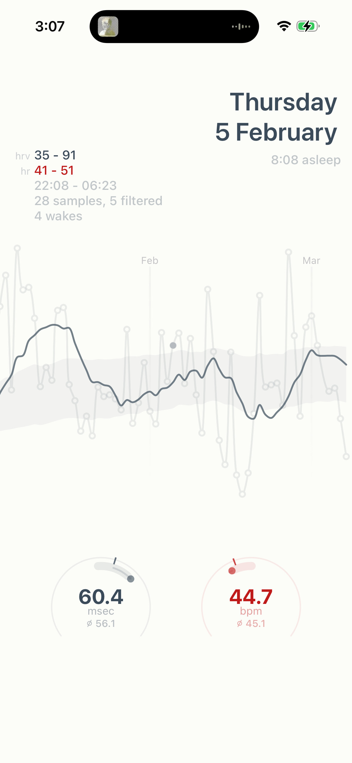

  • Tapping the date will now toggle more detailed data - including min and max HRV and RHR, actual time asleep, number of wakes, total samples and filtered sample count.

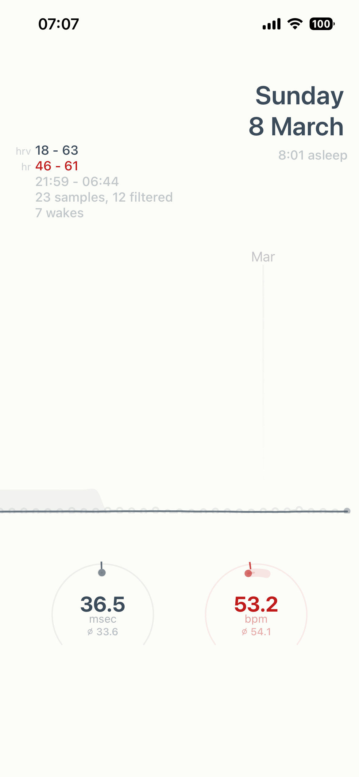

Thanks so much. I did the 28 day refresh and seem to have lost the graph. I think the data is all there.
OK that’s a curious one! Can you try refreshing data back past the current earliest record? Something is weird back in the history I think.

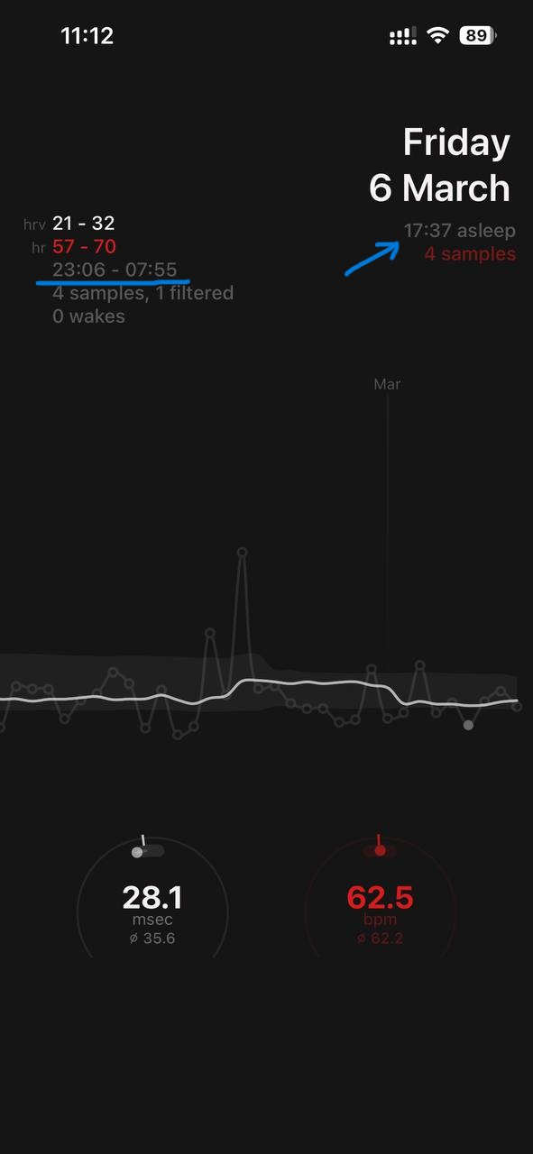

Is this happening consistently?
found the issue, had a rogue v high day that I hid and its now back to normal - thanks
