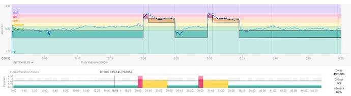

I use the W Pace and the W HR curves to compare the planned training targets with my workout, as shown bellow :
The W curves shows the target zone average and not the zone.

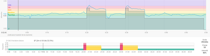

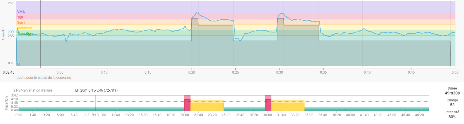

Is it possible to have a curve that shows the zones ?
Example for Pace curve (if targets on pace zones) :

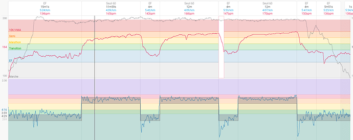

and same for HR graph :slight_smile:

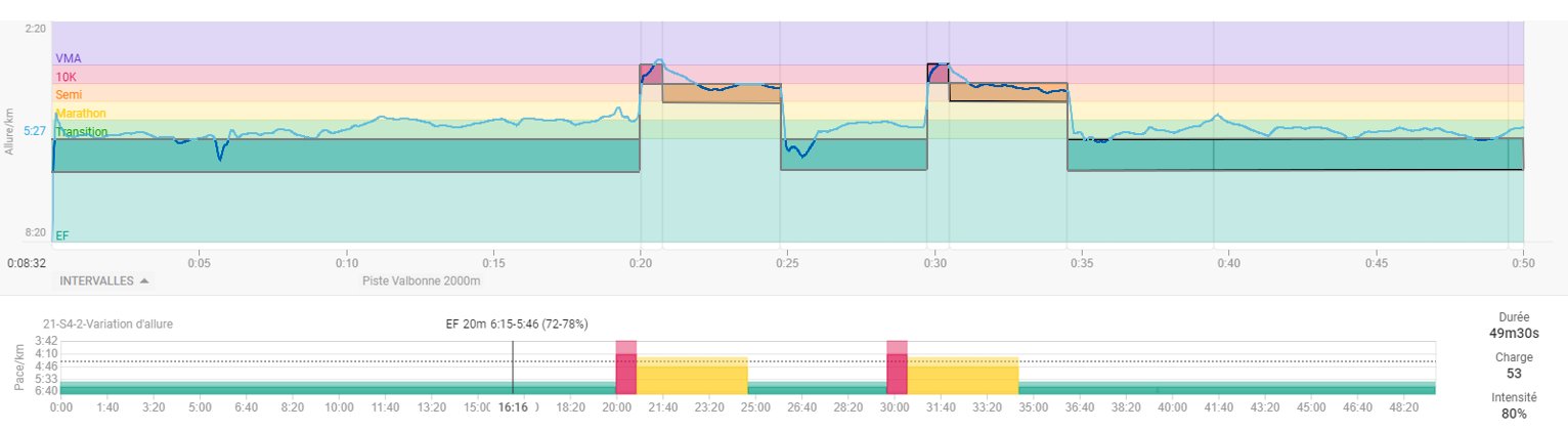

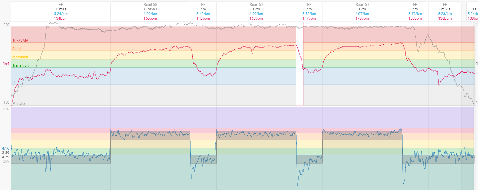

I have found a way to do that on Pace, Intervals.icu is a powerfull tool !
I have created new curves thanks to javascript flow. One for the high zone target, one for the low zone target and one for the area and it works :grinning:
