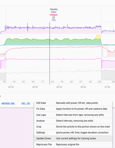

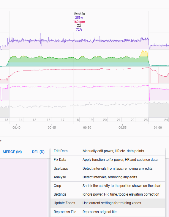

See this example for the FTP test that I ran:
Average power 253W*0.95=240W → eFTP also estimates 240W, which is fine!
Average HR is 160bpm. If I leave out the ramping up phase it is 159bpm, so just running a 20-min FTP is fine (which Joe Friel recommends in his 4th Ed and in the link above).
If I now hit the Update Zones button, my LTHR in Settings->Run->Threshold HR is set to 160.
Is the 98% or 95% value considered at this point?
Does [98%] also apply to the FTP value?

I think you are interpreting that in the wrong way. When you click on Update Zones, that will apply the zones from the settings page to this specific workout and not the other way around. The purpose of that function, is to apply new zone settings to the workout that was already processed with the older settings. So the treshold HR in settings is not set by this workout, but it is the other way around.
Unless you had a new Treshold HR detected by the original analysis in the same way that intervals detects a new FTP. Then you can accept that new value and update the settings with it.
I hope this explanation makes sense, because it is rather difficult to clearly eplain…

Indeed I interpreted it the wrong way, thanks for the clarification!
