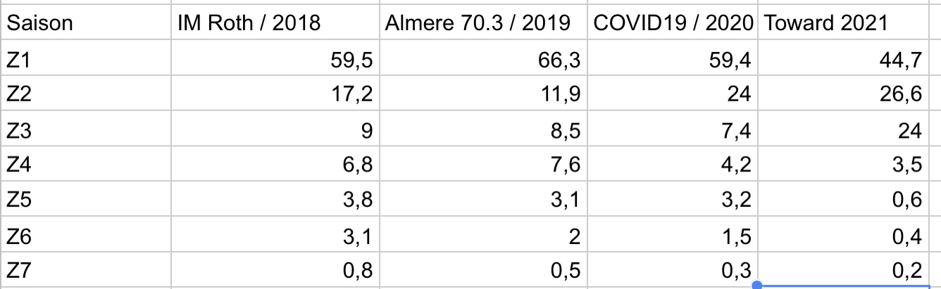

The point is that I think I was going too easy too often! The ton of z1 rides I did are cool but my high intensity workouts were not that hard that I needed that much easy workouts. Now doing more zone 2 workouts, I feel that the workout is a bit harder but first I get used to it and second I recover well from them.
Viva Inigo San Milan :slight_smile:
I will start adding a bit of height intensity workouts gradually. No need to peak in February

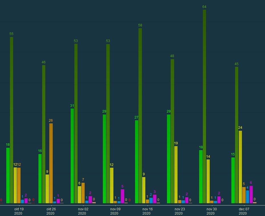

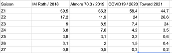

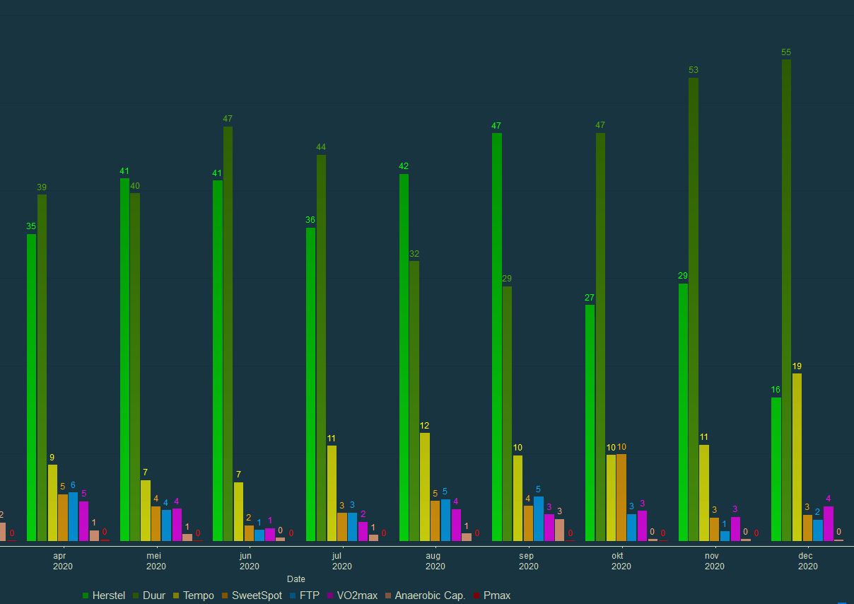

I use WKO5 and Golden Cheetah and after reviewing 2020 and previous seasons i got to much in Z1. Around 40% of my rides. No iam focus more on pacing in Z2 when i do a Z2 ride and it works. Iam now around 25% Z1 from half October till now.
Golden cheetah give me a good way to show my time in zone.
or by weeks:
60% Z1 is a way to much! I know when you are racing crits the time in Z1 is higher between races and also in races. I think setting goals doesnt work. You have to give every ride a zone goal and try to fix that goal. Overall will give you that the numbers you want.
